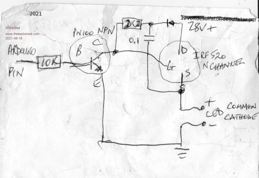

OK for any followers that are interested in the circuit that works here it is below . 3 of these needed each light setup.
Also I put the arduino ".ino" file for the control program to test it . Change it to any rate you want.
Also a link to a video proof of the circuit.All LEDs flash but the camera angle does not get that .
I came across and ordered some individual LED spotlights af slightly less power of about 50 watts . $6 each shown above ,nice flat construction. .These are interesting in that they have a mode that flashes itself and needs no more than a pulse I think to turn that mode on. I'm still experimenting with that .
Forgive my complaints but it was taking far too long to get anywhere and everything posted as an answer was denegrated by somebody else and parts and powers etc were being screwed up by people who wanted to comment but did not have the facts right. Where is a learner to turn.

Check your facts Bob.
Find out what the maximum gate voltage rating of an IRF520 is.
Are you feeling lucky ?

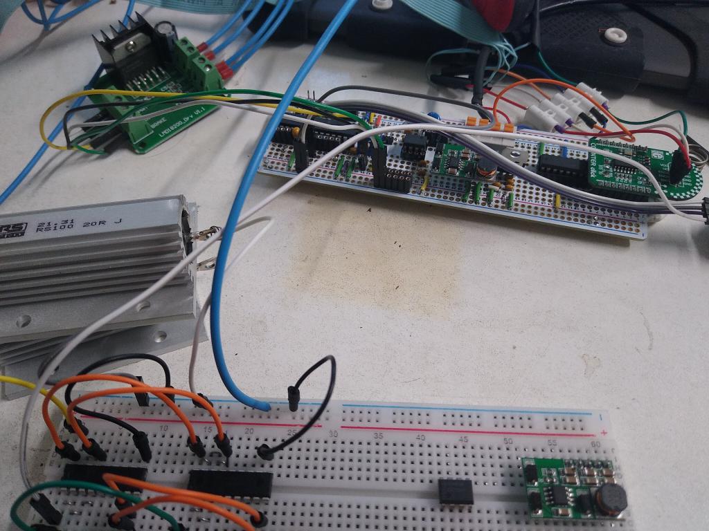

Micrel (Microchip) 2981
Vs = 23.85 @1.08A
Vout = 22.19
Using 4 of 8 channels
Part 1
Part 2
Whoa, these videos are pretty big files   ...should've used lower res.
Running for a couple of hours now, still on 4 channels, each chip. Looking pretty good but I would probably add some form of heat-sink as Mick suggested.

Those big resistors are supposed to be on a heatsink, of course. You have to de-rate them quite a way otherwise. I've fallen into that trap. lol
The chips would almost certainly run cooler soldered to a pcb. I bet they'd be fine with 5 adjacent channels soldered down onto a half-decent area of copper. The old DIL audio amplifiers were very specific about that. 1.8W package dissipation isn't bad, although it's very high for those particular chips. The DMOS version would be well within their dissipation spec.

Yup, that's what the smell turned out to be....singed the darn table
Still running happily. Been here all night, gonna run down to the local Wetherspoons for breaky and then I'll have a look for the TLP350H devices. They've been in my face for weeks but then I had a tidy up...Can't find a darned thing

Actually, I'm impressed by your Chinese breadboards. They seem to have handled 1A well. The maximum rating I've ever seen for this sort of board is 2A IIRC, and that was for an expensive make.

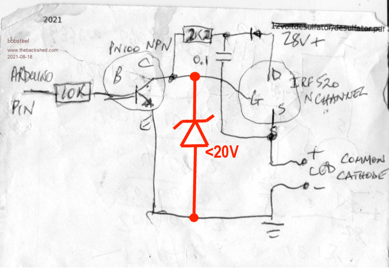

NO...That will never work. The zener must be attached between gate and source of the FET. Not to ground.
@Bob.Steel
NO... the capacitor you add will generate a nice positive drive to the gate of the FET, that is a "boost capacitor", as used in switching power supplies. But it only works as long as there is energy storage in the capacitor. For the values listed, that will be around 200us. So you need to drive the FET with 5kHz. But there is a reason why this does not work at all with LED's. LED's draw 900mA at 28V. But as soon as the output voltage gets lower (when turning off the LED) the LED diodes (yes, they are diodes) stop conducting. In essence, there is not enough current in to "charge" the boost capacitor again.
Sorry, nice idea, but it does not work. If you want to use IRF520 FET's you NEED a constant boost voltage of 5V-10V on top of the 28V. That is what this whole long thread is about. Either buy common anode LED's, or drop the IRF520's (use something else).
Edited 2021-08-18 19:24 by Volhout
