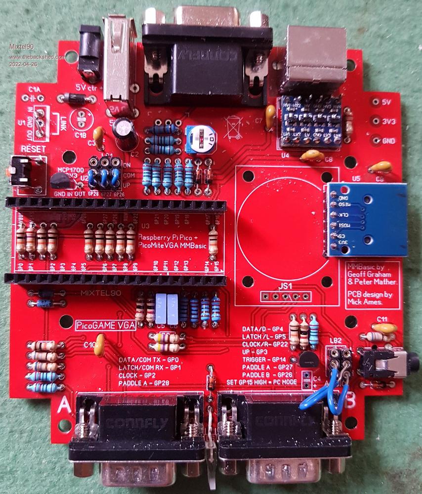

Here's the "Normal" one:

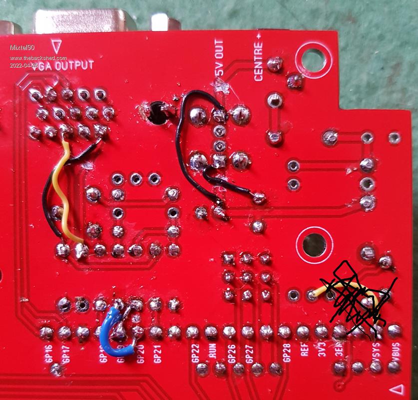

Here's the board mods, but only done on the "other" one. The crossed out mod is to do with re-enabling the SMPS so ignore it. The two crossed over black wires reverse the polarity of the USB-A socket, the rest fix the colours.

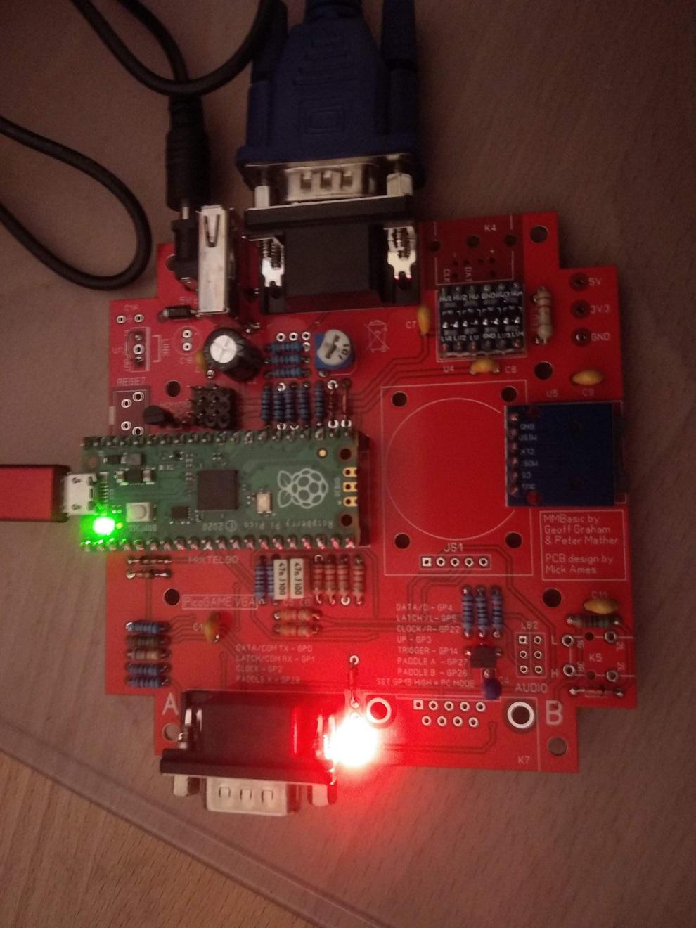

Posted: 09:51pm 26 Apr 2022
It lives:
It's missing a few bits - I have them but realised I could get it running without.
