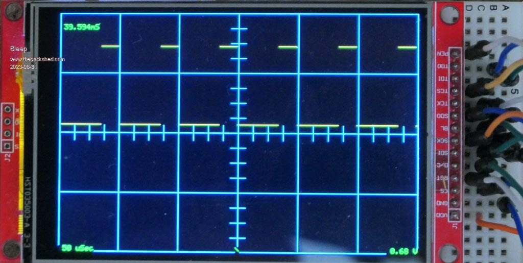

Hi Steve,
I've done a quick and very dirty conversion to a 480x320 LCD display, just to see how it looks and how fast the update was.
I've done away with the LAYERS and simply save the last times points in a lasttime array, which I use to remove the last trace, before drawing the new trace.
I also had to move some of your GP pin allocations, because my setup was already using some, so for the moment I've removed the hard buttons and moved the PWM output to GP22.
The number in the top left is the screen update rate in mS, so not at all bad.
Video of operation is here:- Scope video
Copy of your code modified here:-
Scope480x320.zip
Keep up the good work Steve. :-)
Regards, Kevin.

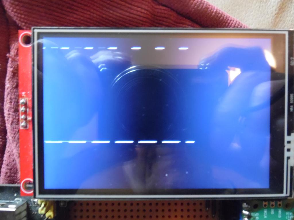

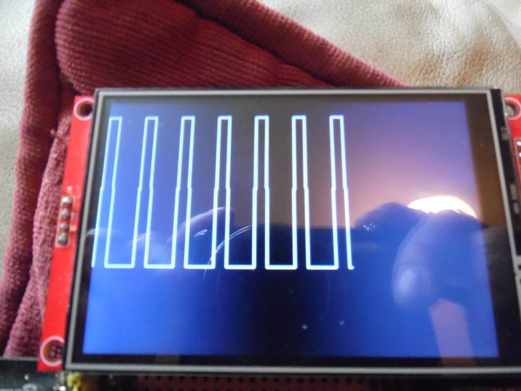

Posts: 2807
Posted: 06:19pm 31 Aug 2023
Thanks to phil99 I got pixel version working but prefer line as it trigger better

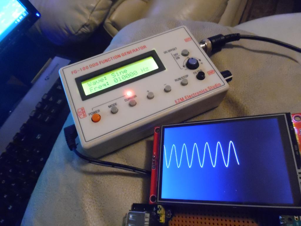

Posts: 9224
Posted: 06:36pm 31 Aug 2023
What about displaying sine, sawtooth and triangle waves?
Posts: 2807
Posted: 07:13pm 31 Aug 2023
  Mixtel90 said  What about displaying sine, sawtooth and triangle waves?
