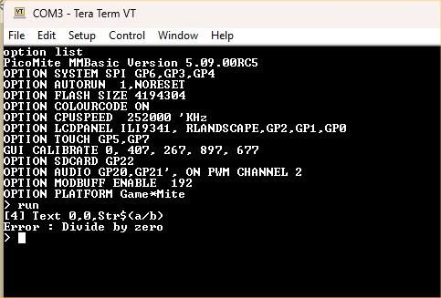

I have done some more testing:
The GEEK (PicoMite with SPI display) works correct.
The PicoMiteVGA works correct.
The Thermal Imager (ILI9341) does not show the problem, or it would have creashed during my development constantly.
The PicoMite with I2C display on system I2C bus shows the 'Display not configured".
It could be related to I2C displays? Or the SSD1306I2C32 (128x32).

Out of interest please try the attached with the I2C display
PicoMite.zip
Posts: 6289
Posted: 12:18pm 16 Jul 2024
Hi Peter,
I configured the SSD1306I2C without the actual SSD1306 (128x64) display, and noticed it is not showing the "Display not configured" error. Then (also without the actual display attached, I configured SSD1306I2C32 and it showed the error message. I seems related to 1 specific display. And it shows regardless if the actual display is attached or not.
Then I tried your uf2 file, and that one erased all options. And after installing the SSD1306I2C32 display the error message "Display not configured" is gone.
It feels like this version solves the issue.
Was the SSD1306I2C32 display not connected to the error output ? So the code wanted to output the "divide by zero" error message, but had no pipe to send it to ? Causing a second error...
Thank you,
Harm
Edited 2024-07-16 22:20 by Volhout

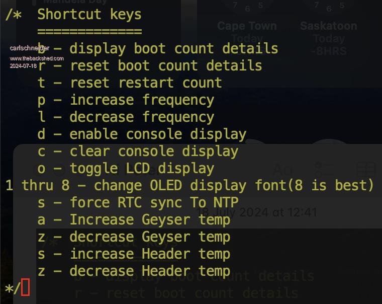

This is what I'm currently experiencing. The only change I've made to the code is the inclusion of 4 lines of text in a /* */ existing rem block.
Saved 44616 bytes
12:42:15
Date$ , Time$ , MM.Info(BOOT COUNT) , MM.ErrMsg$ , MM.ERRNO , MM.Watchdog , IP Address
18-07-2024,12:42:15, 113,, 0, 0,ip address
# of Boots  35 since 17-07-2024 13:18:33
# of Starts  49 since 17-07-2024 13:18:33
[193] ADC OPEN 166666,3,ADCComplete 'All 3 ADC start, sum of sampling <=500kHz
Error : Unknown command
Error : Display not configured
Reseting the WebMite returns the Terminal cursor and I can reconnect to the WebMite through the USB. Which reboots normally and gives me the standard IP connection and TCP server start message. Then doing another F2 without changing anything and we're off to the races.
WebMite MMBasic Version 5.09.00RC5
OPTION SYSTEM I2C GP20,GP21
OPTION COLOURCODE ON
OPTION CPUSPEED  252000 'KHz
OPTION DISPLAY 58, 157
OPTION LCDPANEL SSD1306I2C, LANDSCAPE, 2
OPTION WIFI DO-788455B, ************, CSECOS, ip address, 255.255.255.0, gateway
OPTION TCP SERVER PORT 80
OPTION TELNET CONSOLE ON
OPTION RTC AUTO ENABLE
Another quirk I've noticed in the rem block is one comment which is tabbed keeps losing the leading tabs when saved.
Cheers Carl

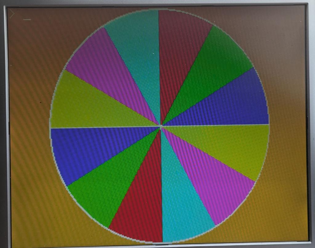

Prompted by a comment from Stanley, Ive added the map command and function to the PicoMiteVGA and PicoMiteVGAUSB based on the CMM2 functionality (see the CMM2 manual).
Load up the new firmware and run the following:
PicoMiteVGA.zip
' Set up an array to hold the colour mappings we are going to use
Dim integer cmap(6)
'Clear the screen
MODE 2
Map reset
CLS
'Set up 6 colours in the array
cmap(1)=RGB(red)
cmap(2)=RGB(green)
cmap(3)=RGB(blue)
cmap(4)=RGB(yellow)
cmap(5)=RGB(magenta)
cmap(6)=RGB(cyan)
' Do an initial update of the Colour map to set up our colours
domap
'Display an outer circle in white
Circle MM.HRes/2,MM.VRes/2,MM.VRes/2-1,0,,RGB(white),RGB(white)
' Now draw a simple colour pie chart using our new colours with the ARC command
Arc MM.HRes/2,MM.VRes/2,0,MM.VRes/2-3,0,30,Map(1)
Arc MM.HRes/2,MM.VRes/2,0,MM.VRes/2-3,30,60,Map(2)

Posts: 6289
Posted: 07:51pm 24 Jul 2024
Hi Peter,
Can you explain what the difference is between the Map(I) as function, and an array Map() in this application.?
Is the to avoid DIM ing an array Map(6), or using Map reset.?
Thanks for the explanation.
Edited 2024-07-25 05:53 by Volhout
Posts: 2807
Posted: 08:51pm 24 Jul 2024
I'm frustrated my pico vga is usb so can't try but I'll make a vga board later.
until I can try map, what's it do please?
Posts: 2807
Posts: 2807
oops
Edited 2024-07-25 06:53 by stanleyella
Posts: 12272
Posted: 09:59pm 24 Jul 2024
  Quote  Can you explain what the difference is between the Map(I) as function, and an array Map() in this application.?
The map( function returns a 24-bit RGB value that will pick up the slot that you have specified a colour for
so:
MAP(1)=rgb(brown)
map set
Will cause any "normally" blue pixels to turn brown. In order to then use a drawing command with the brown colour use the map(1) function as the colour
This should be obvious in the example. This is how the CMM2 does it using a H/W colour lookup table (CLUT) whereas the PicoMite does it in the VGA driver in S/W.
NB: this functionality is only available at CPU speeds of 252 and 378 MHz
