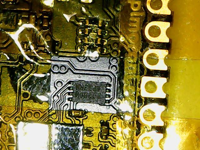

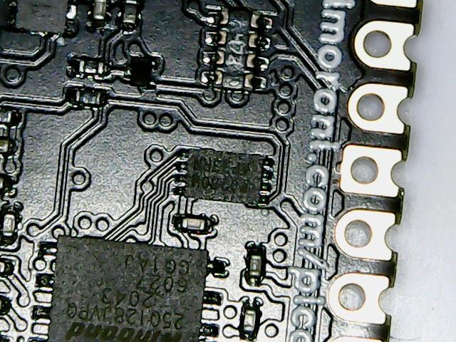

Hello BackShed community,
I have found that my Pimoroni devices with PSRAM won't run reliably above about 315MHz (315000KHz).  I have tested multiple PGA2350B and also the Pico Plus2 devices.  The Tiny2350 device with no PSRAM seems to be stable at higher Clock speeds.
I can see that they all have Winbond W25Q128JVPIQ flash memory rated for 133MHz SPI clock and the APS6404L-3SQR-ZR PSRAM is also rated for 133MHz.  The other thing that the "slow" devices have in common is that they use the RP2350B rather then the RP2350A used on the Tiny2350.  I still don't have any of the "official" Pico 2 devices to test.
This problem seems to happen whether or not the PSRAM is enabled.  I am wondering if the extra "load" or possibly capacitance on the QSPI buss is limiting the maximum speed?  Or perhaps the PicoMite firmware is overclocking the QSPI buss higher than 133MHz depending on the CPU Speed?  And Yes, I realize that anything over 150MHz on the RP2350 devices is "use at your own risk"
I am tempted to remove the PSRAM from one of the Pimoroni devices to see if it makes a difference.  Before I break out the hot air rework gun, I thought I'd check in to see what ideas or experience the community have.
Any thoughts on this topic?  Is anyone seeing stable performance from the PGA2350 or the Pico Plus2 devices at 372000KHz or 378000KHz or similar high clock rates?

Posts: 12102
Posted: 04:35pm 06 Sep 2024
The QSPI bus is clocked at CPU/4 so should be well within tolerance. I've tried slowing this further and my PGA2350 still won't run faster either. Looks like Pimoroni have compromised on design somewhere compared to the Pico2 - pity

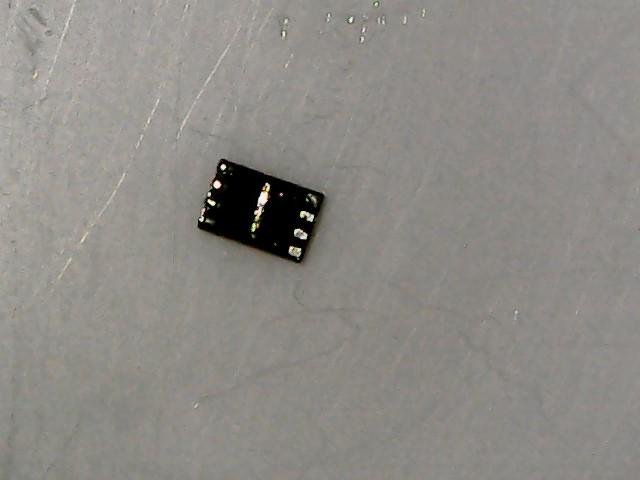

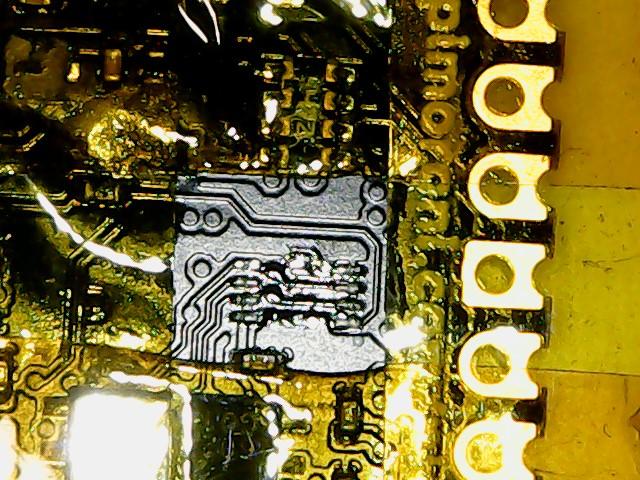

Posted: 03:21am 09 Sep 2024
I can now confirm that with the PSRAM chip removed from one of my Pimoroni Pico Plus2 modules, it is now stable at 378MHz.  Testing is ongoing, I will post when I have more data to report.
It is possible that the layout of the module, with the FLASH and PSRAM on the opposite side of the PCB from the RP2350B chip contributes to the issue.  Perhaps with the memory Ic's placed for minimal trace lengths and without the sharp right angles of the Vias it might be more stable with both the FLASH and PSRAM??? Something to consider when the time comes to design a board for JLCPCB to manufacture.
I will try this with one of my Pimoroni PGA2350 modules next.  It will be interesting to see how other board designs perform when they become available.
Before removal
Kapton tape is your friend!
And....it's gone!
Note that the tiny PSRAM chip has a center pad with no corresponding pad on the PCB.  I hope they have bonded the center pad on the RP2350B to something useful, but I'm not willing to remove one to find out.
!!!Warning!!  Do not attempt this without the proper equipment and experience with SMD components.  There is a  real chance of damaging the board beyond repair!

Posts: 9287
Posted: 06:37am 09 Sep 2024
Very neatly done, Carl! Nice work. Thanks for the pics - and indeed for doing it at all. :)
I suspect there'll be a ground plane on an intermediate layer to screen the top and bottom sides. There normally is unless you are a cheapskate like me who sticks to 2-layer boards. :)
Posts: 6223
Posted: 06:53am 09 Sep 2024
The PSRAM is likely a APS6404 family member. Since these are available in USON-8 package.
These chips clock up to 144MHz. The centre pad is (unexpected) not connected according the datasheet. It simply has same pinout as the SOP-8 package (8 pins).
One thing that can be played with, is the drive strength of the bus. But I doubt that will really solve the issue. Chance is the "split bus" does not allow for higher speeds, speeds that already far exceed the design spec of 150MHz CPU speed.

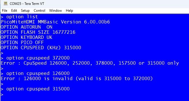

Posts: 2994
Posted: 04:20pm 10 Sep 2024
Bit late to the 'Pico party' as I have been away for a while. Now that I'm back home I have been able to order various PICO 2 goodies; and the first of many packages arrived today.
Currently using a Pimoroni Pico Plus 2 and have loaded the HDMI firmware (non USB) b6. All looks good but when I went to experiment with changing the CPU speed, I get the following conflicting messages......
I know a lot of the firmware is still work-in-progress, and I do remember seeing mention that the HDMI requires 372000 BUT the Pimoroni module may possibly only run at 315000.
The question here is: should I be able to change CPUSPEED to 372000 OR is the device being detected and hence preventing me from changing it?
Also - please can anyone enlighten me as to what 'OPTION PICO OFF' is all about (I have not refered to manual as not sure what one to look at

PhenixRising
Joined: 07/11/2023
Posts: 2128
Posted: 04:31pm 10 Sep 2024
@WhiteWizzard
No. This and the PGA version are limited to 315000 max
Posts: 2994
Posted: 04:34pm 10 Sep 2024
  PhenixRising said  @WhiteWizzard
Thanks - so does this essentially mean the only current restriction is that they can’t do 720P ?
