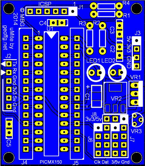

Lads,
OK This is the final FINAL version..
I have added the 2 bypass caps that WW suggested as well as a 100R resistor to protect accidental `bricking' of the PIC.
I am presenting this version for Manufacture now.
SCHEMATIC
2014-04-15_112013_mmite.pdf
OVERLAY
Edited by bigmik 2014-04-16

Now I have a question for the group..
Headers J4 and J5... Should these be female or male? Or user decide?
I gererally subscribe to male pins on PCBs as they wont wear out like female sockets can, but female would allow an LED or resistor to be poked in easilly..
Hmm, conundrums...
Posts: 2998
Posted: 02:57pm 19 Apr 2014
Mick,
Remembering this PCB was originally for your own use then assuming 'compactness' is not an issue I would consider doing the following.
Use short pin female headers soldered onto the board.
Then place enough 2-way male headers into these female to make each pin effectively a male header (yes they will be a bit tall - but thats why I mentioned above if 'compactness' was not an issue).
Now you have the flexibility - male where you want to, or female if you remove the relevant 2-way male header pins. I would avoid the use of single pin males as these would 'spin'. If however you need a single female (Im still talking about the headers! ) then use multiple male headers either side ensuring you don't have any single males. Hopefully you followed this! (A picture paints a 1000 words . . . . . )
OR (as something I have used very successfully for my own use in the past) is:
Why not use Long Pin Female stackable headers mounted on the underside of the PCB. Then you can use the long pins (which are sticking out the top) like normal male headers, and have the option underneath to have females for temporary plugging in 'things'.
This method allows you to then mount the PCB upside down into a breadboard to give more working holes.
Sorry Mick, just added MORE conundrums for you
Posts: 2984
Posted: 08:27pm 19 Apr 2014
Hi WW,All,
I understand what you say about single males and females (they are unstable and twist about too much)
What you say about the long female stackables could be done but the ones I have seen dont have square male pins and are actually flat `rectangular' shaped and dont reliably plug into female header sockets so I wouldnt use them.. These are like Arduino risers...
I am not a fan of mounting the females under the PCB unless it was going to plug into another PCB.. and Compactness is generally what I look for.
I am tending towards ALL Males on the PCB as the Female-Female link wires are readilly available and cheap. I was trying to get an opinion from what others would think about this. On thinking along this, it is of course entirely up to the end user and what environment it is going to be used for..
The fact that the J4 and J5 headers have ALL (except pin 20 Cap C1 +ve connection) it lends itself to a daughter board for USB/TTL relays, LEDs etc. But of course it could also have the pins/sockets facing down on the underside of the PCB to plug this PCB into larger PCBs and thus become a CPU module.. I dont see myself doing either but I am thinking of the possibility of a Training board such as Vasi displayed earlier for learning about basic and various hardware concepts..
If that was designed what would we wish to offer?

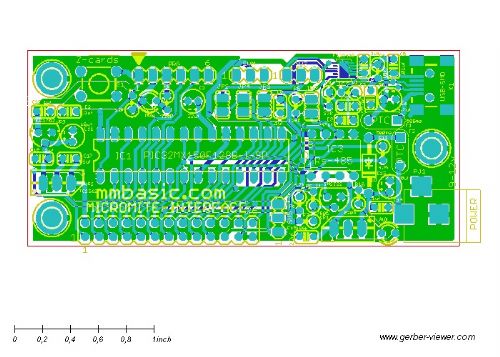

I am working on pcb that has all 'bus' signals on a header on one side of the print.
It would then allow for modules to be made that use one or more of the 'bus' signals.
Any specific mcu pins that are not on that bus will be on a separate header. This will allow bus modules with different mcu modules.
I have a whole bus system figured out that allows for plugable modules and has 2xI2C, 2xspi, 2x serial, 4 gpio, 3.3v and 5v, gnd and reset.
Depending on the mcu used one or more of these bus signals are used to communicate with other modules.
I have posted about this before but now that the micromite is final i can finish my design and showed it soon for feedback.

Just wanted to post a quick update of the uMite Prototype Board, "Rev-B" that fixes the registration issue with the DFN part. (and the silly spelling on back)
2014-04-20_210350_uMite-28_Prototype_Board_Rev_B.zip
Take a look and see if there are any errors in there.. If not, then this one's a done deal..!! Next...
Thanks Gang..!
EDIT: Yep, another update... I was thinking, since orders for the board have settled down here at the shed, I think it would be a good idea to pack up the last 6 "full builds" with the 20 flats and send them over to Phil to slot up on the website... It will be a bit to get some "fresh" stock created and this could serve as a slight buffer for the shelf...
Took a peek at the gerbers...
They seem to be in order...
Edited by Zonker 2014-04-23
