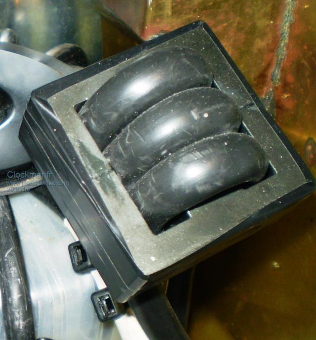

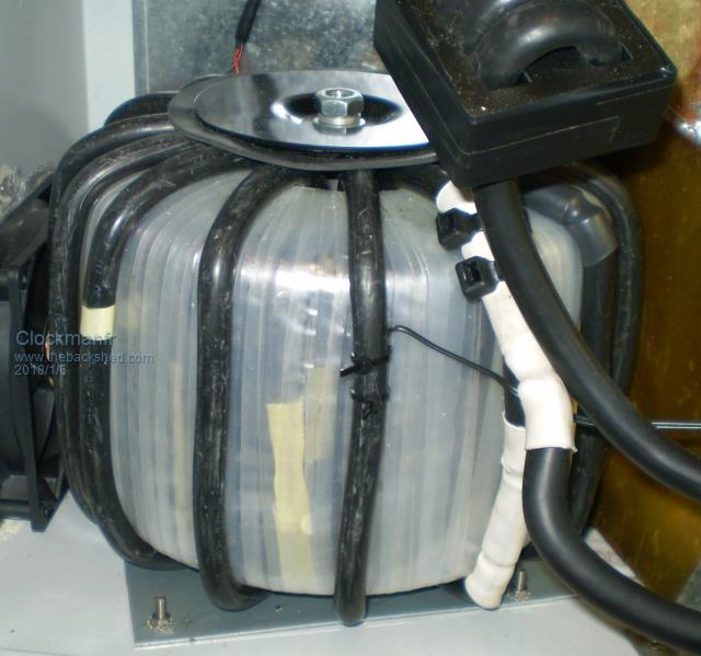

Here are my ferrite cores that go on one of the Primary cables, wrapped around a minimum of three times.
The big OzInverter has these, but doubled up giving a 40mm thickness x 80mm x 80mm when assembled. A 75mm/2 flexible cable will easily go around the centre ferrite column 3 times.
http://www.ebay.co.uk/itm/E8020-E80-Ferroxcube-3C90-E-EE-Ferrite-Cores-transformer-AL-5000-1set-/370683164776?hash=item5 64e703868
The 6kW OzInverter has these, just one set. 27mm thickness x 66mm x 64mm when assembled. Again wrap around at least 3 times, here I use 50mm/2 flexible cable.
http://www.ebay.co.uk/itm/E6527-Ferroxcube-E65-E-EE-Ferrite-Cores-bobbin-Power-transformer-AL-8600-1set-/370597734866?ha sh=item564958a9d2
Super glue the core together, I use insulation tape to hold them tight while the super glue sets. Like this .......
Heres a photo for Tony..... the core winding machine, and heat furnace for 0.3mm silicone iron that has been doing my cores, but it has a max core thickness of 65mm so hence the need to stack the cores.

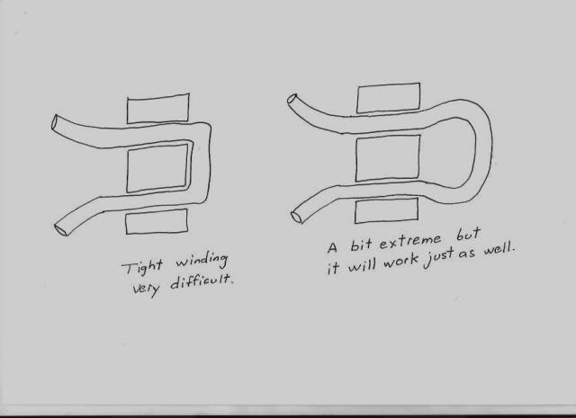

When winding very heavy cable through those ferrite E cores, its only necessary for the wires to pass through the slots the required number of times.
There is no requirement to have a very "tight" winding, as its very difficult to make very tight right angle bends around the rectangular centre of the core.
So don't worry about having big loops sticking out on either side, it has absolutely no effect on the inductance.
The length of wire will obviously be very slightly more, but the difference will be negligible in the great scheme of things.

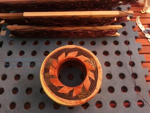

I got my torroid all apart today, sheesh got sore muscles I didn't know I had.
Warpspeed, thanks mate, I didn't know that.Edited by renewableMark 2018-01-09
