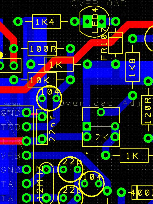

Mark,

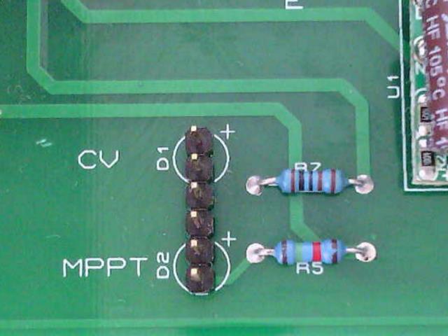

We still need to provide a positive bias on the anode of the led, pin8 pulls to ground from memory. So you want gnd on the 47uf, and 5v via the 1k to the led... I think that is whats going on now.
Just cutting above the pin, will still provide gnd to the 47uf... but no excitement to the led.... and grounds the 1k to gnd from +5v.
Using your technique would stop the internal led, use up some current unnecessarily, but the external LED would still be viable..... so your fix would have half worked..... and the upside would have been no moths attracted inside the ( my ) box last night perhaps

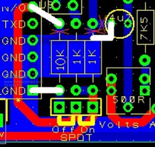

If you want to include Klaus's suggestion you can do it this way.

I always did wonder why there were LED's on that ozinverter control board, nobody but moths will see them when the thing is running .
My control board has a socket from where all the switch/ indicator / etc. wiring to the front panel go. For testing, I made a dummy control panel in a jiffy box that can plug in there. Makes all the flashing lights easily visible while I tinker with the inverter.
And, having that 10K resistor, no drama when unplugging that box.

The LED for the overcurrent shut down must be there so not a good idea to remove that one. At less than 1 cent each for LEDs why bother having to plug something in that may be overlooked. If someone can forget to plug in the power switch then there is much greater chance that they won't plug in the LED. I think that it is very important when you consider that the Inverter could be running producing lethal voltages and there is nothing to indicate it is alive.

Yes, the leds on the board are there for indication. Unlike tinkers, these boards are independent of cases or other ancillary equipment, and are stand alone units.
They can replace any LF inverter heart with no extra stuff required, just a tranny and battery and it works.... you don't need a control panel
Plus, it gives any moths that do turn up, enough light to read the form guide in the news paper.

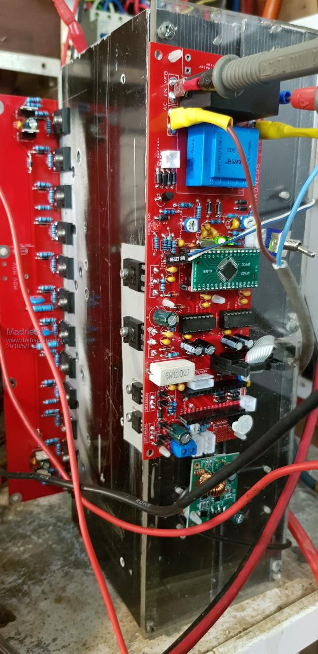

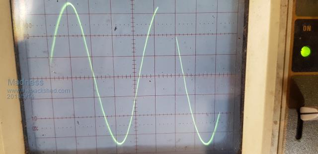

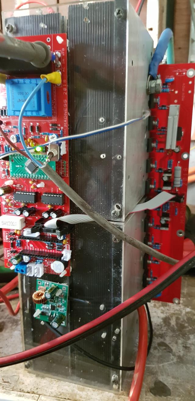

I have one Inverter running with the new PCBs, no load and no capacitors at this stage. I have included all the mods shown above including Tinkers 10K resistor which does exactly as he said it would.
I have not started with the Nano section as yet but I do have most of the code written to shut down on low voltage and control the fans.

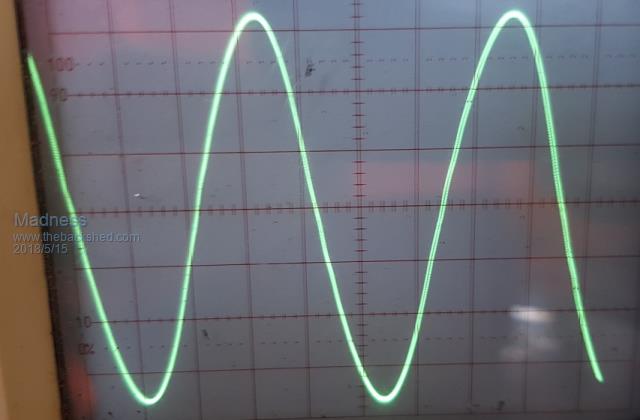

The Sinewave is not broken it is just how my phone took the photo, I can't find how to manually set the exposure time on this phone.
If you choose to mount the TIP35s as above I used the full length of their legs. If you don't want them that way just mount them as normal with the printed side facing the PCB.
Edited by Madness 2018-05-15

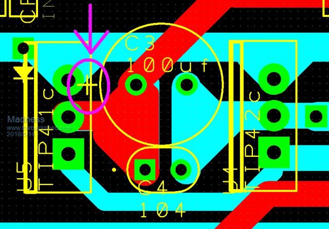

The + symbol is a bit hard to see on silkscreen as it got mixed in with the transistors. It is on the left side of the text for all 5 of the 100uf electrolytic on the power board.

Didn't get a chance to play with Mads boards until late this afternoon.
Anyway two built now and tested without big torroid, only small transformer.
Perfectly good waveform as per mads picture. Same mods around the on/off lands.

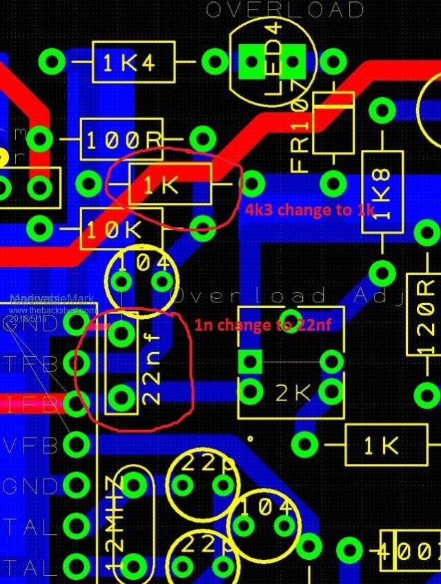

I noticed a few changes compared to mine, and we discussed these a long time ago... the 1n cap at the IFB area, changed to .0022uf... 223, and a 4k3 went to 1k. My last set of boards still had the 1n and 4k3 values on them.... can't even remember why I changed them, but must have been a stability reason perhaps.

So changes as per below, working on the code when I get time.

OK so to make it super clear it's like this yeah?
(just want to get this right first time)
Cheers Caveman Mark
Off grid eastern Melb
Madness
Joined: 08/10/2011
Posts: 2498
Posted: 12:18am 15 May 2018
That is right 1n becomes 22nf 4k3 becomes 1k.
Worked out how to get to advanced settings in my phone, they keep changing how to get to it. Here is a CRO shot with 50 ISO.

Oztules suggested those revisions at the end of August 2017, I dont remember why. So they are not new, gee almost 9 months
