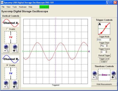

I have just braved the cold and taken some DSO readings of typical voltage across the caps.
There will only be voltage if current is passed by the cap.
The output frequency was 6.4mS, approx 330rpm, provided approx 150W to the load with 10VAC ripple on the caps.
On my original test set of caps, 200uF 35VDC, these did heat up at high power and high frequency. These were very small and were only used to prove the doubler concept on the series80 2s7p rewire. I now use 180WV, or 400V caps. I have not specifically purchased any caps to try yet.
I measured a good sine wave across the caps, so the back to back arrangement of caps seem to handle power without visible cross over distortions as the caps change function.
Is it possible to check the waveform across the caps when they blow? Is it possible the caps are wired differently? My caps have been punished without problems. I have provided photos of the caps in my system. What system have you tested on? What power levels are you testing at? Would this be a hydro system or a windmill?

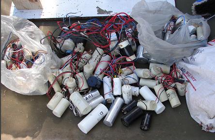

Here is a pic of the variety of caps that Dennis put together for his original testing.
There are all types to make up the capacitance. These can be picked up from old fluoro's, motors, etc.
Bryan simplified to 6 x 400V units. I was not so enthusiastic, and expanded to 24.
I have no plans to test for 12V systems.
I see no difference with sizing capacitors to resistors, or inductors, or mosfets etc, for power rating.
Gordon.
