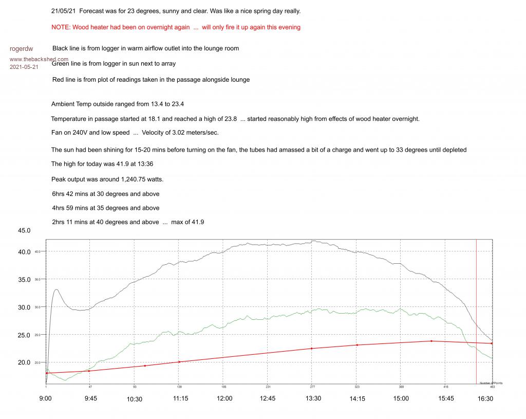

In the mean time, todays results were pretty impressive. Not a record for maximum peak output  ...  but a lot of hours of heat just pumping into the house. Even saw my wife with her jumper off.
Peak output reached 1,240.75 watts
6hrs 42 mins at 30 degrees and above
4hrs 59 mins at 35 degrees and above
2hrs 11 mins at 40 degrees and above  ...  and a max of 41.9 degrees
Cheers,  Roger

That is a very encouraging result, considering its still a scaled down version.
It would be interesting to try driving a dc powered air blower direct from a solar panel.

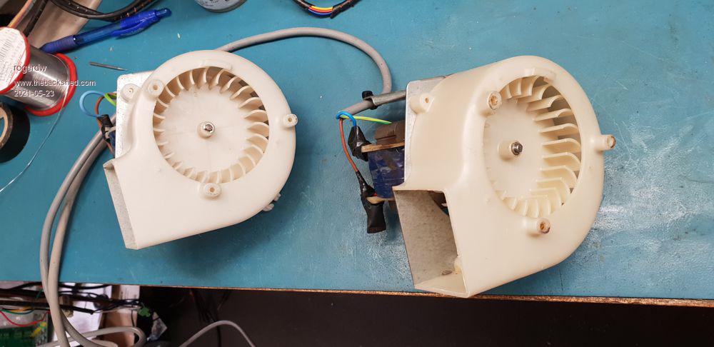

I forgot to mention that this morning before 9am, I reversed the fan on the unit where it was mounted.
I simply removed the duct tape, rotated the fan and taped it back in.
What that does is to suck air through the unit instead of blow it through. And it sucks air from what was the outlet ...  down around the outer part of the evacuated tubes and back up the centre tubes  ...  a complete reversal from before.
I don't imagine it made any difference  ...  but because tomorrow is supposed to have similar conditions to today (1 degree higher), I plan to put it back to 'normal' before I fire it up tomorrow.
Reason I tried this is because I came across the advice a couple times in airheating circles, that you must draw the air through and not blow it through. Of course no explanation was given  ...  but were very adamant.

  Warpspeed said  That is a very encouraging result, considering its still a scaled down version.
Yes, certainly encouraging, though we're unlikely to get lots of days like this  ...  except for tomorrow maybe  ...  one degree hotter and sunny.
One thing that I noticed on todays chart is that between 13:30 and 15:00 the temp in the sun stayed virtually level  ...  yet the output went on a steady decline from 41.9 - 37.8
I can see a dc blower doing the job. It probably still needs some smarts to decide when it should be allowed to run and when to cut out etc  ...  but the speed could simply be left to the output of a well matched solar panel.
I should be able to log the output power of a panel when my new multimeter gets here, so that will give us a lot more idea.

Your heat input definitely seems to track measured solar pretty well.
A solar panel powered air blower should at least adjust the airflow up and down in the right directions, and start and stop appropriately. I have never seen this done before, but my gut intuition is that it will be dead simple and work very well.
Sometimes the simplest solutions are the best.
Smarts would be very easy to add, the main hurdle being control of the motor power.
If its a dc motor its pretty straightforward.  A 230v induction motor will require phase control, from a mains isolated dc control voltage. I would expect a commercial power module to do that might cost around $250.

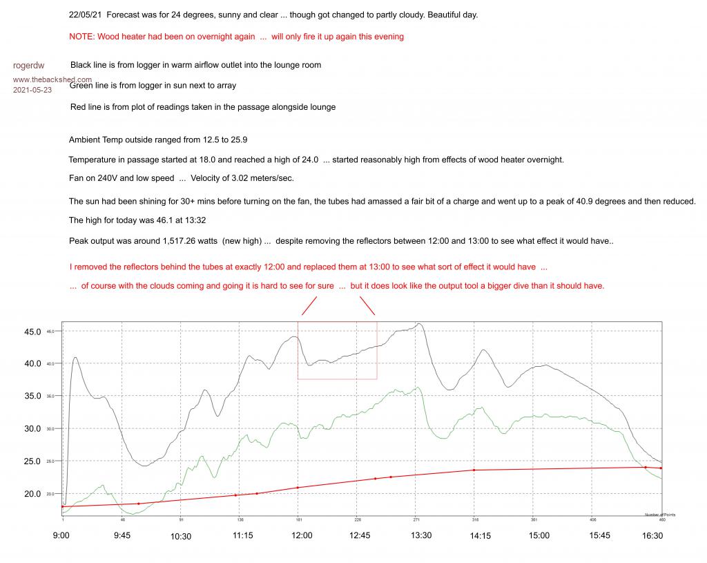

Todays results were interesting. Because of the forecast being similar to yesterday plus a degree hotter I was expecting big things.
In fact we had a high of 46.1 from the outlet and a record instantaneous power output of 1,517.26 watts
Because I was hoping for a very smooth output over the day like yesterday  ...  I decided to remove the reflectors from behind the tubes at midday, when they should be at their most effective  ...
...  and replace them at 13:00.
I was hoping to see a big drop in output temperature  ...  and we did  ...  but the outside temp in the sun also dropped at the same time due to cloud cover  ...  so is hard to say exactly just how beneficial the reflectors are.
Maybe someone else can interpret the chart to offer some insight.

  Quote  I was hoping to see a big drop in output temperature  ...  and we did  ...  but the outside temp in the sun also dropped at the same time due to cloud cover  ...  so is hard to say exactly just how beneficial the reflectors are.
You probably need to run the test multiple times and when the conditions are more stable to get an averaged meaningful Result.
Posted: 10:24pm 22 May 2021
Agree, its up and down all over the place, difficult to see anything definite.
You're right. Just my lazy self was hoping to get the answer in one easy test.
If today looks a bit more even, I'll perhaps try it again. Forecast calls for 'high cloud' and sunny. Just no cloud for an hour over lunch would do it.
I've got a few other experiments in mind. I cleaned and wired up a couple of identical fans that I saved from wrecked microwaves years ago.
240V and 35W  ...  and with a roughly 9.5 meters/sec airflow velocity. I'll work out the cubic meters/min when I do the tests.
If nothing else, I've learned there's no point doing one test after the other  ...  they must be done together otherwise it's too easy to get misled. Conditions change by the minute.
