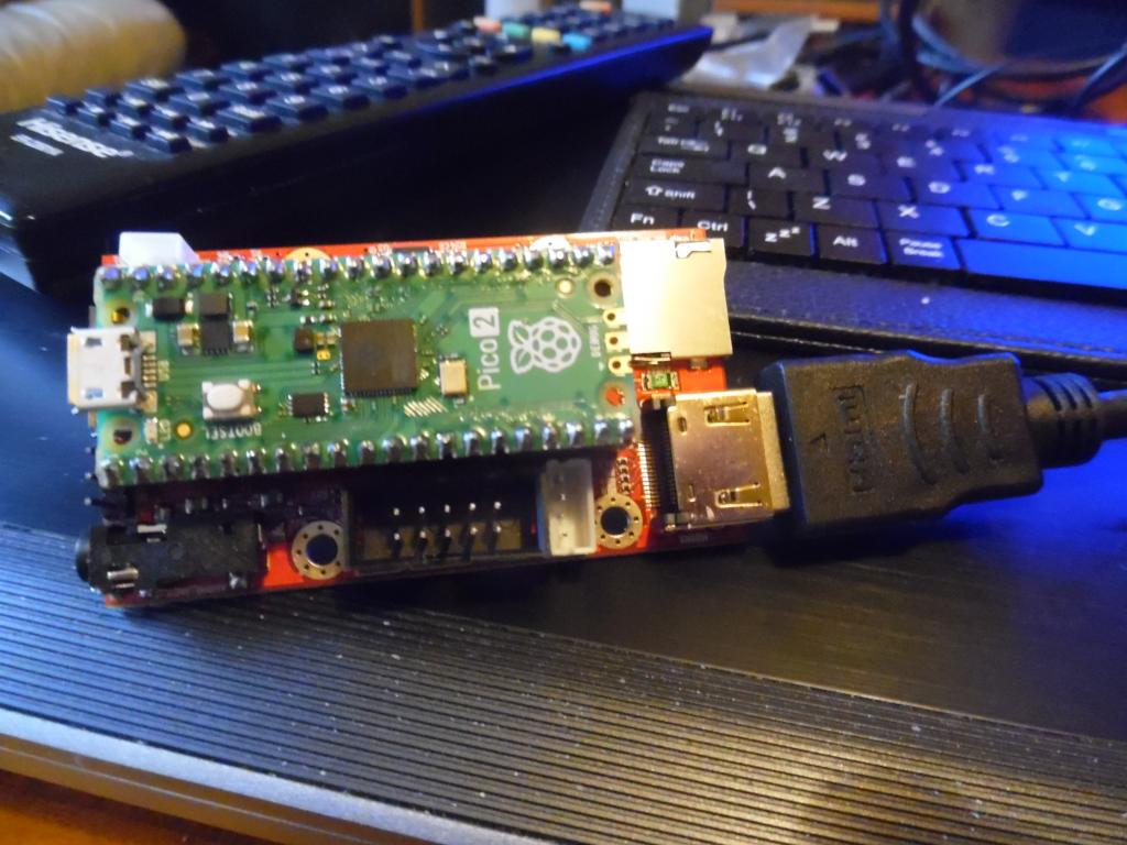

olimex arrived and tried picomitehdmiusb and picomitehdmi
but no video, check hdmi tv works?
teraterm works with pico2 so there's hdmi to set up.
please help.which usb to use?
Edited 2024-09-11 05:57 by stanleyella

Posts: 2807
Posted: 08:29pm 10 Sep 2024
  matherp said  Did you type "OPTION RESET OLIMEX"

Posts: 2807
Posted: 08:47pm 10 Sep 2024
I think I should have got the long male to female connectors to solder to pico2 :(
on order though. I think it could be more standard.
does the usb version work and please explain the pico2 usb socket and the olimex usb socket?? which for what please?
Posts: 2807
Posted: 09:17pm 10 Sep 2024
I typed mode 3 and circle 240,240,100 and got a circle,,, bit oblate spheroid but olimex is working first test

Posts: 2807
Posted: 10:11pm 10 Sep 2024
is olimex another ephemeral board cos it seems pretty tidy?
hdmi is not gonna be stripboard friendly and this board does it all. no inductors in the audio filter. loath that I am for using pcb this is an exception
https://www.mouser.com/datasheet/2/306/Olimex_RP2040_PICO_PC-3223944.pdf
Edited 2024-09-11 08:58 by stanleyella
Posts: 2807
Posted: 12:06am 11 Sep 2024
tried mode 1 to 5 with existing 2040 asteroids and bubble universe on olimex pico2 and from jittery to big to not enough memory for mod play.
thing is it works through the hdmi and the sd card reader works.
it's an old luxor tv and it has synced an stuff fine cos  I got no remote.
sound test next. link needed.
maybe usb version but sort this first.
hdmi don't seem faster than vga 2040. pico2 vga was faster than 2040 vga

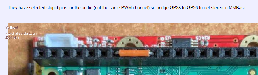

Posts: 9287
Posted: 08:00am 11 Sep 2024
Stan:
HDMI can be stripboard friendly. There are breakout boards. The Adafruit one even has the resistors on it.
I think you'll be able to get the USB HDMI version running on there. GP8/GP9 will probably still work with a USB-TTL converter for the console even though there are pull up resistors on them.
You don't *need* the long female connectors. There are a lot of pins you can't use even if you have them and some (if not all) of the most useful spare ones are already on that little box header and the little 3-pin header.
The 3-pin has GP0 & GP1
CON2 has GP2 & GP3
The 10-gin has GP4, GP5, GP6, GP7, GP8, GP9, GP20, GP21
The HDMI socket has
GP10, GP11, GP12, GP13, GP15, GP15, GP16, GP17, GP18, GP19, GP26
Audio has GP27, GP28
The SD card has GP22, GP4, GP6, GP7 (it shares the SPI with the 10-pin)
There's nothing left to connect anything to. The female connectors are useful for monitoring but most can only be used if you aren't using DVI/ HDMI.
