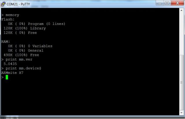

Does the .bin file method work for the H7? If so, can you include it in releases?
Posts: 12186
Posted: 10:16pm 24 Nov 2018
  Quote  Does the .bin file method work for the H7?
Don't know - feel free to try

Posts: 3888
Posted: 02:41am 25 Nov 2018
Removed H7 from the package for the first time, set up jumpers and solder bridges, plugged it in, got the folder pop-up, copied in the .bin file, started puTTY, and voila, success!
Thanks much for all of your work.

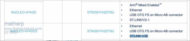

Got a notice today from Digikey that the original Nucleo-H7 is at "End of Life". There is a substitute/later model indicated, the NUCLEO-H743ZI2, but when I click on the link for it, I get "Page not found".
After a brief search, I was unable to find what was new on the ZI2.
Posts: 12186
Posted: 03:28pm 06 May 2019
  Quote  After a brief search, I was unable to find what was new on the ZI2.
Looks like an updated version of ST-LINK
