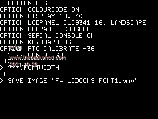

I have a problem trying to use the OPTION LCDPANEL CONSOLE function on an F4 running V5.07.00RC1 firmware.
I enable the LCD Console specifying FONT 1 thus: OPTION LCDPANEL CONSOLE 1
This works as expected as shown in the screen image below. Note that OPTION DISPLAY says it is using 18 lines and 40 chars per line. Also MM.FontWidth / Height reports  the font being 8 x 13 which corresponds to FONT 1.

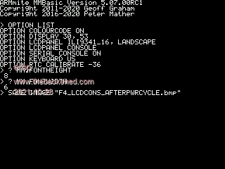

However after a power cycle or a CPU RESTART, the FONT used for the LCD CONSOLE changes to 6 x 8 (FONT 7) as shown in the screen image below. Note that now OPTION DISPLAY shows 30 lines and 53 chars per line. This is very difficult to read on the ILI9341 LCD display that is commonly used with the F4.
Note that if the Forecolor and Backcolor options are specified when enabling the LCD as the console these are correctly remembered across a power cycle / restart, it is only the FONT setting that is changed. I didn't test the optional Backlight setting.
Can this be fixed so that the FONT setting for the console is correctly remembered?

Posted: 10:20am 02 Nov 2021
ArmmiteF407V5.07.00RC2.zip
Fixes a bug in fonts with Console mode set
Fixes bug in parameters following subcommands/sub-functions that are enclosed in brackets e.g. POKE WORD (anything),anything or ? PEEK(WORD (anything))
