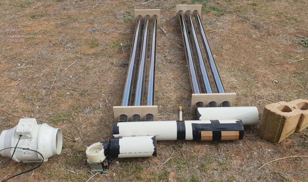

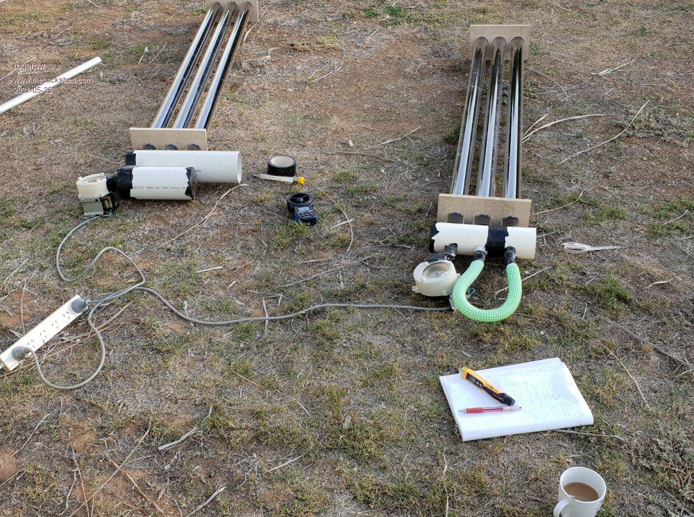

I learned a few things over the weekend about these tubes and positioning in relation to the sun.
All the systems you see sold as water heaters have the tubes lined up as if pointing to the sun  ... and my air heater is the same.
Since assembling my current test heater I've had a number of tubes just lying on the ground next to the shed  ...  some lined up like the heater and some at 90 degrees to them.
For some reason I checked the temperatures inside and found the ones at right angles to the sunlight, were on average at least 20% higher.
That led to putting together two sets of three tubes and comparing two different setups  ...  one set up like my existing heater but horizontal and at 90 degrees to it  ...
...  and the second one the same, except I hooked them up to have air blow through in 'series' rather than parallel  ...  hoping to have each tube add heat to the previous one  ...  but expecting to have next to no volume of air.
That's pretty much how it played out  ...  the standard setup working like normal and the series setup generating much higher temperature but with very little airflow.

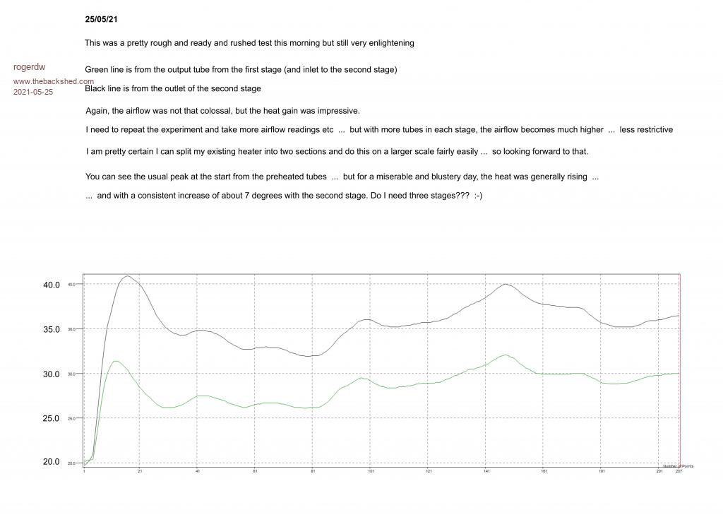

To have a better crack at the series arrangement, I reconfigured the second set to be the same as the first  ...  and hooked the output of one to the input of the other.
At about 10:20 this morning I turned it on with my dataloggers attached  ...  one at the output of #1 and the second at the final output. The ambient temperature was quite low at about 15 degrees.
You can see the result on the chart and seems to be a very worthwhile temp gain  ...  though the airflow was still restricted somewhat because of just three tubes.
My thinking is that say 8 or 10 tubes in parallel feeding into another 8-10 tubes should have a lot less restriction to airflow  ...  but a double crack at adding heat.
First photo show the series setup to the right. Very rough and crude, but didn't expect a practical output, though the temperature rise was impressive  ...  around 20 degree gain over the input  ...  but pity there was not much air blowing out.
Second photo shows two lots of three tubes hooked one after the other. Cold air input on left and final output on right. The brick was to help deflect the wind from blowing into the output coz it was pretty blustery.
This chart is of the two stage setup from the last photo.

Probably more overall efficient to go for lower overall temperature rise and greatest airflow.
Higher temperatures at reduced airflow are of no real advantage heating up a whole large living space.

  Warpspeed said  Probably more overall efficient to go for lower overall temperature rise and greatest airflow.
Warp is correct, from having build and played around with solar water heaters in the past; it is way more efficient to have less temperature gain with a higher flow (air in your case).
All the tubes should be in parallel not series, set your temperature differential switch to say on at 5 degrees and off at 2, compared to the air temperature inside the house.
If you don't want to use a differential thermostat, then a PV panel could drive the fans directly, if there is sufficient sun to make the fans start, then there is heat to be gained to pass into the house.
Are you guys serious  ...  lol  ...  and I thought I'd discovered the holy grail of home heating.
Oh well  ...  thanks anyway  ...  save me a lot of time wasted pursuing it.
Having had time to think about this more, my next question is ...  if I find that the sun comes out and the temperature coming out the outlet rises to 35 degrees  ...  I should just ramp up the fan so that the heat is pushed out faster  ...
...  and then slow it back down once the output temperature gets down to ???  ...  the room temperature I'm looking for  ...  say 20 degrees  ...  or a couple of degrees higher? What are your thoughts?
Edit: I see that Mike is sort of suggesting the range between 2 to 5 degrees above my desired room temperature.
  Solar Mike said  it is way more efficient to have less temperature gain with a higher flow (air in your case).
Thank you, that does make sense.
It is a little difficult to do that exactly, because you need to turn on the fan for a while to see what temperature is going to come out  ...  so I probably need a seperate sensor in the manifold that indicates that the temperatrure is high enough to warrant turning on the fan  ...
...  then watch the output temp to decide to leave it running or turn it off  ...  at the degrees you suggested  ...
...  and then some smarts to decide whether to ramp up the speed or throttle back.
  Quote  If you don't want to use a differential thermostat, then a PV panel could drive the fans directly, if there is sufficient sun to make the fans start, then there is heat to be gained to pass into the house.
I'm not fussed either way really  ...  I could create a smart controller of sorts to do all this  ...  though there is a definite attraction to having it automatically run just from the output of a normal pv panel.
Of course I'll have to sort out a dc fan first  ...  so time for a visit to the wreckers.
I have an additional two dataloggers now, so a bit easier to monitor more parameters.
One of them should probably go inside the manifold.

  rogerdw said
  InPhase said  How about a series/parallel arrangement? What if you put say 3 tubes in series for a high temperature, and put them in parallel with another set of 3 in series for increased flow? 3S2P in battery nomenclature.
The difficulty with individual tubes being in series is that the airflow is limited to what air I can force down a tube only 30mm in diameter  ...
...  then feed that into the next and the next  ...  and while the temperature increase is awesome  ...  there's such a tiny amount of airflow it is useless to heat a room.
With a single set, yes. But if you had several sets of series tubes in parallel the resistance would be less. Imagine them as a 3S2P battery system.
Posted: 03:12am 25 May 2021
To begin with just couple your blower straight up to a solar panel and see how that goes.
If your collector temperature gain is very high, you need a bigger blower.
In most vehicles you can select either outside air or recirculated air for the heater/blower.
Recirculated air gives the fastest warm up, as you have already worked out, sourcing the warmest air gives the greatest heat gain.
However, recirculated air (in a vehicle) may become extremely humid and add to the problem of window demisting. So if its cold, and your clothing is wet, outside air will be far better if you hope to see out of the vehicle.
In a home, humidity and cooking smells, may sometimes build up if the inside air is continually recirculated.  Its normal in heating/airconditioning applications to add a proportion of fresh dry outside air to possibly humid stale recirculated air.
You mentioned earlier that the laundry gets nice and warm through direct solar gain. That would be good, unless you are doing a lot of washing, which may cause a humidity problem.
Some means of sourcing either inside air or fresh outside air, or an adjustable mixture may at times be very welcome in different situations.
