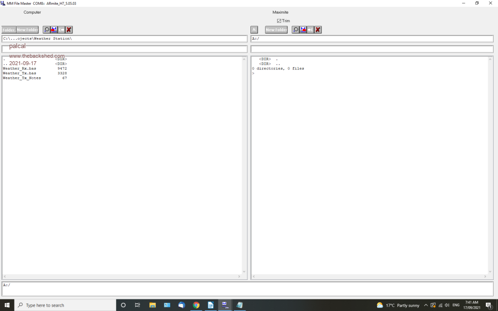

Iam still having problems, bought a new 16GB card. In MMEdit I get this...
but when I try to save a file I get an error..
Error : A hard error occurred in the low level disk I/O layer
> Warning: SDcard Removed
Edit..I moved the sdcard away from the System SPI to pins 21, 22, 24, 25
Edited 2021-09-17 07:48 by palcal
Posts: 6629
Posted: 09:50pm 16 Sep 2021
Plug the SDcard int your PC and copy files that way.
Then see if you can read them in the pico.
Next try to save from the pico command line.
If any of those fail, XMODEM is definitely going to fail.
Posts: 6629
Posted: 10:24pm 16 Sep 2021
Try this program:
open "test.txt" for output as #2
for n = 1 to 100
print #2, "line number "+str$(n)
next n
close #2
pause 1000
open "test.txt" for input as #2
do
input #2,t$
print t$
loop until eof(#2)
Also, what CPUspeed do you have set?

I loaded a file to the card on my PC and it shows up in the Pico but if I try to load the file it gives error  'Cannot find the file'.
CPU speed is defaule 125000
I loaded your program and got the error 'A hard error occurred in the low level disk I/O layer'

I slowed the CPU down to 48000 and it is working OK.
Thanks.

I've been running SD cards fine even up to top speed on system spi. The PicoMite still uses software access anyway - it swaps the pins to normal digital for SD access then returns them so hardware spi. You might have an oddball card. It's also possible that your supply voltage is a bit dodgy. Some SD cards appreciate at least a capacitor across their supply pins to work properly, sometimes with a low value resistor in series with the supply. It might be worthwhile putting something up to 10uF as close as possible to the SD card, say 2.2uF tantalum.
Posts: 12066
Posted: 07:19am 17 Sep 2021
Definitely sounds like a H/W issue somewhere. Do you have pullups on the SPI pins? these are not needed. As Mick suggests a 2R2 resistor into a 10uF capacitor across the power pins of the SDcard may help. Like him I always run at CPUSPEED 250000 and have not seen SDcard issues despite multiple versions of hack wiring.
As always, start simple. Remove all connections to the Pico except the SDcard until that is working  and then build from there
palcal
Joined: 12/10/2011
Posts: 2053
Posted: 09:54pm 17 Sep 2021
Seems OK now, I think maybe bad connection in card holder.
