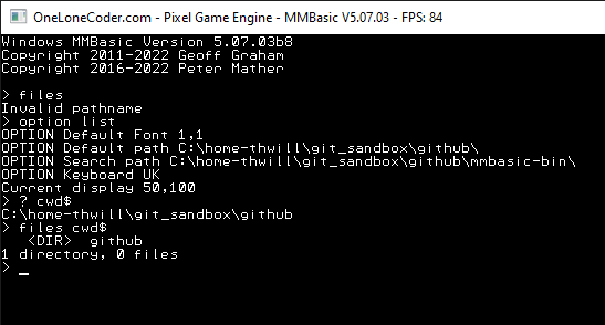

The last two versions posted seem to be have a significant regression, both displaying this behaviour:
Observe the misbehaviour of the initial FILES command.
Edited 2022-04-06 05:40 by thwill
Posts: 12041
Posted: 09:42pm 05 Apr 2022
Oops - got true and false the wrong way round

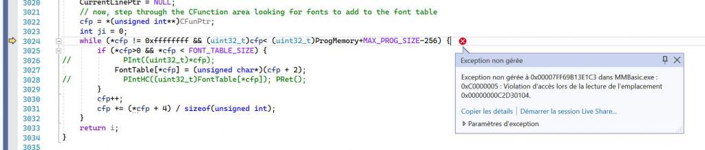

Posted: 09:35am 06 Apr 2022
Hello Peter
I just try to compile your latest code and get this error.
Is it something to set in the parameters to made it work ?
Here i am in debug mode , but when i go for 'Release x64' it compile but mmbasic start and after 2sec or so , the window disappear
Cheers.
Posts: 12041
Posted: 09:42am 06 Apr 2022
You should be compiling in release x86. It won't work in debug or 64-bit
Edited 2022-04-06 19:46 by matherp

Joined: 31/01/2020
Location: France
Posts: 101
Posted: 12:12pm 06 Apr 2022
  matherp said  You should be compiling in release x86. It won't work in debug or 64-bit
Thank you Peter , now it compile well
Cheers.
