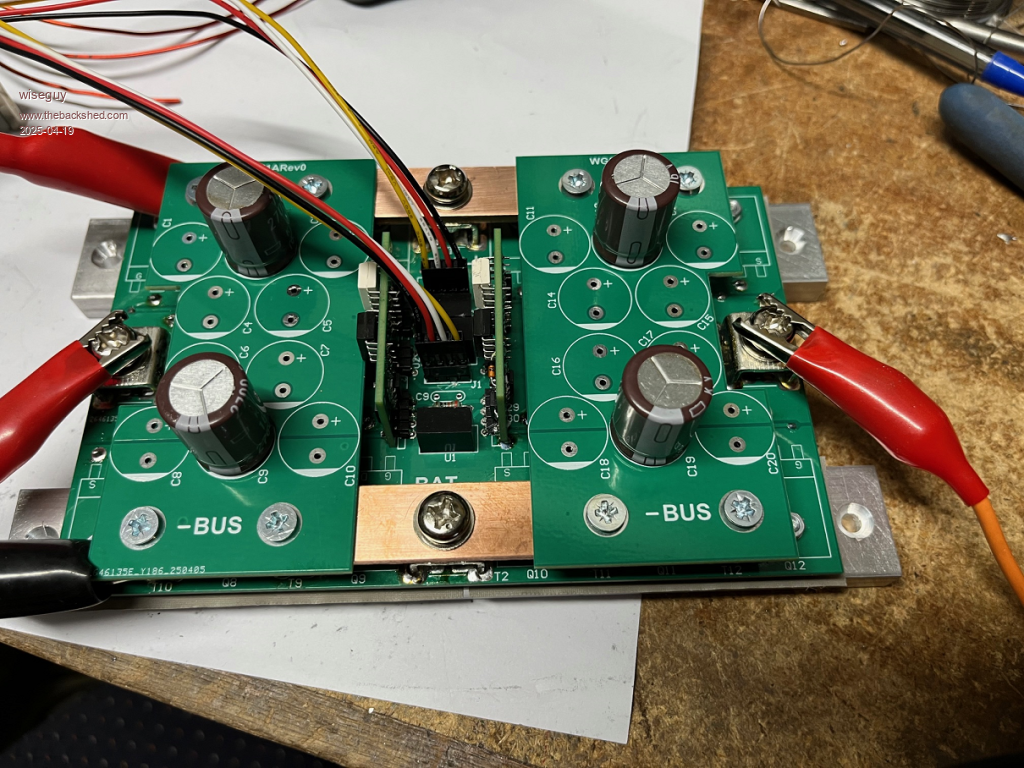

Latest project (pictured below) did not work first go!    I reversed one of the sides opto drives and it drove the transformer only in one direction for both halves of the 180 degrees, which after ~ 2 cycles the toroid was saturated and drawing bulk current, current limiting limit was set to a few amps so no damage.
Project is for a 12 - 230V inverter @ 2KW continuous for caravan use. PCB is 160mm x 100mm and made in 1oz. But the full length copper bus bars 3mm x 15mm should help a bit. I put the opto & buffer driver transistors on 2 small vertical PCBs which saved a lot of space.
It has 12 Mosfets, (3 each leg of the bridge) I used the HY5608s as they are still excellent for this application. Idling at ~ 14.2W with 11V in and 230.5AC out unloaded.  It looks like I may need to put another 10 to 15 turns on the output winding as it will droop a bit under load.
The 2 cap boards can house up to 20 x 16mm dia caps on a 7.5mm pitch. Not sure what final value and quantity of caps I will use, still to be determined with more testing. Leaning towards a quantity of 8,200u @ 16V from digikey, with all 20 loaded ~ 700uOhms impedance.
2 different Cap PCBs and this power stage could also run off 48V, the 8 way opto/12V cable is still plug and play from the controller but as 2 x 4 pin cables.
Ready for some serious testing soon.

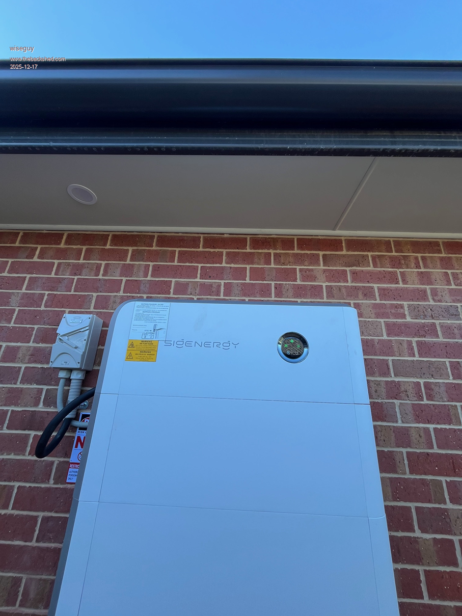

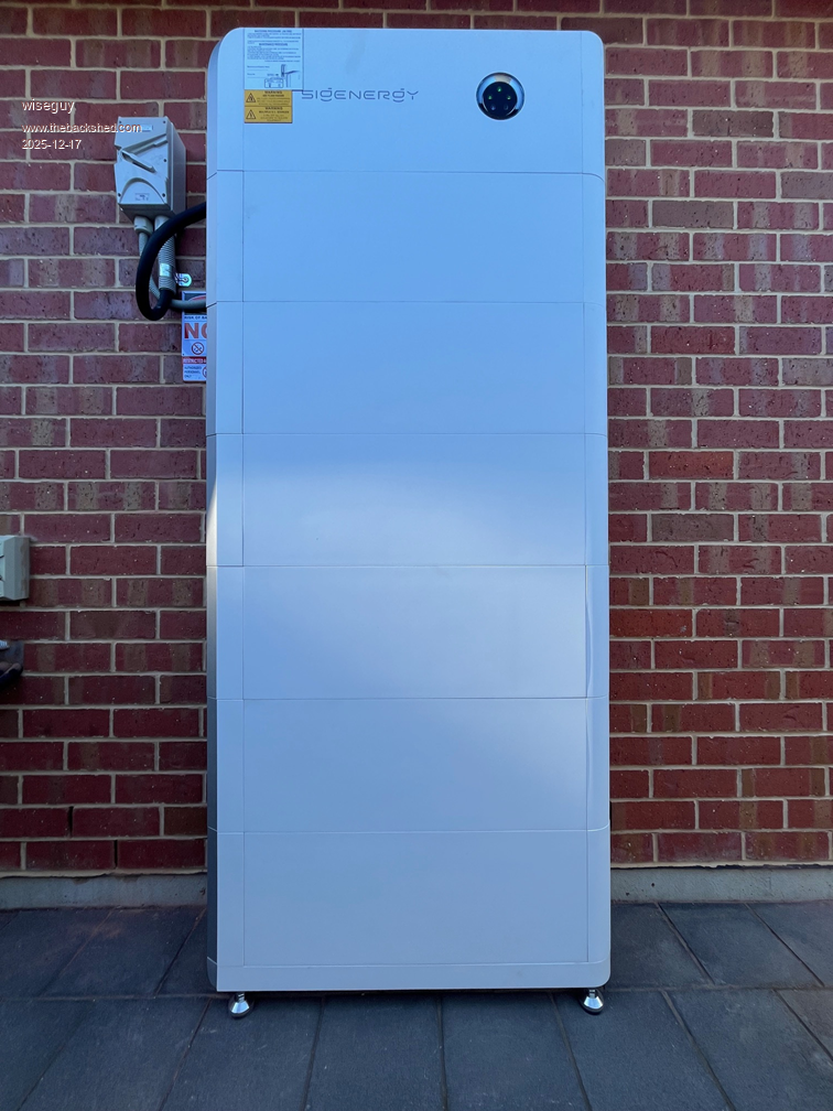

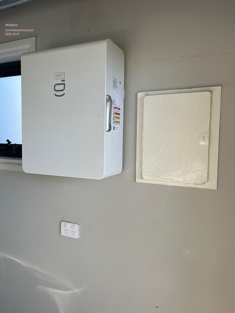

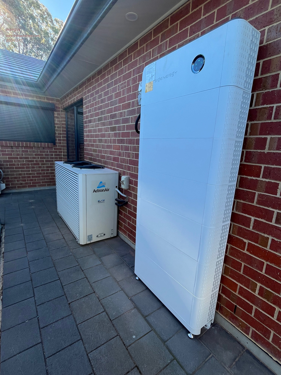

The Sigenergy system went in today and was finished ~ 5.00pm. The batteries were only 40% charged and currently we are running our house including ducted air on the sig system. Now the air conditioning has ramped down to maintain temperature Power reduced from just over 7kW down to 2kW. The system now has 12.9kW (26%) remaining so in theory if nothing changes, we have ~ 6 hours remaining. However, as the evening cools, the air cant ramp down much further so it starts to cycle off for longer periods so I expect it to not actually draw from the mains tonight - we will see. Batteries should reach 100% for the first time by about noon tomorrow.
As far as pictures go there is very little to see. In the garage we have the Sig "gateway" which is a fancy name for wireless monitor of AC street info, AC from Sig and AC to the house.  It provides islanding from the street power when there is no power but otherwise it is ready to use street power to supplement our inverter/batteries if the Solar/batteries cant keep up with the load (greater than 25kW).
The rest is a stack of 6 x 8kWH modules topped off by the 25kW 3 phase inverter unit with 4 x MPPT's inbuilt.  The final picture shows the eaves / top of sig stack, should I put an angled metal shield, bolted to the wall, between the sig stack and the eaves to deflect heat and flames outwards past the eaves just in case??
Gateway unit:
Outside stack:
