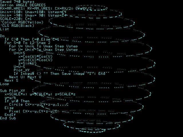

Option ANGLE DEGREES
RX=MM.HRES: RY=MM.VRES: CX=RX/2: CY=RY/2
Umin=-180: Umax=180: Ustep=14
Vmin= -90: Vmax= 90: Vstep=14
SCALE=220: C=1
Colour RGB(Cyan)
CLS
 If C>0 Then C=0 Else C=1
 For S=0 To 12 Step 2
   For V= Vmin To Vmax Step Vstep
   For U= Umin To Umax Step Ustep
     U=U+S
       x=Cos(U)*Cos(V)
       y=Sin(U)*Cos(V)
       z=Sin(V)
     U=U-S
     Plot_XY
     If Inkey$ <> "" Then End
   Next U: Next V
 Next S
Sub Plot_XY
 x=SCALE*x: y=SCALE*y: z=SCALE*z
 y=y/3
 If y<0 Then
   Circle CX+x-y,CY+z-y,1,,,C
 Else
   Pixel CX+x-y,CY+z-y,C
 EndIf
End Sub

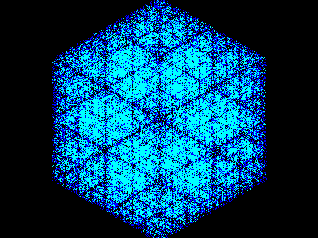

Tesseract The Space Stone / The Cosmic Cube
MODE 3
CX=MM.HRES\2
CY=MM.VRES\2
Dim P(5),Q(5)
For L=0 To 5
 S=Pi/3*L
 P(L)=500*Sin(S)
 Q(L)=500*Cos(S)
Next
X=0:Y=500
For L=0 To 320000
 R=Int(Rnd*6)
 X=(X+P(R))/2
 Y=(Y+Q(R))/2
 PX=CX+X\2
 PY=CY+Y\2
 G=Pixel(PX,PY)
 Color Map(1)
 If G>0 Then Color Map(7)
 Pixel PX,PY
Next

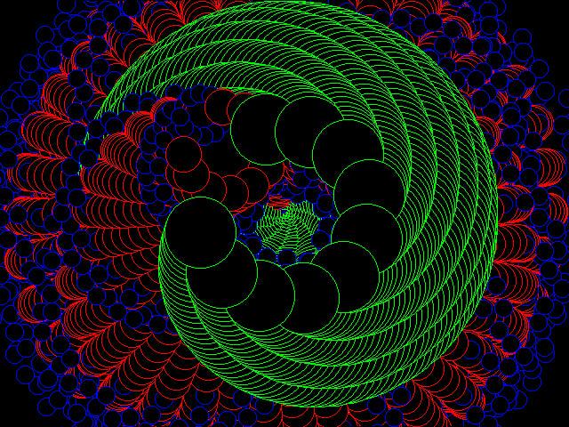

Circular Strudel
MODE 3
Dim C%(15)=(0,1,2,3,4,5,6,7,8,9,10,11,12,13,14,15)
Colour Map C%(), C%()
xc=MM.HRES\2
yc=MM.VRES\2
 r=r+Pi/180
 w=w+Pi/72
 For i=1 To 11
   x=xc+200*Cos(w+i*Pi/6)*Sin(r)
   y=yc+200*Sin(w+i*Pi/6)*Sin(r)
   Circle x,y,40,,,C%(6),C%(0)
   ww=ww+Pi/80
   If i=1 Then
     For j=1 To 11
       xx=x+100*Cos(ww+j*Pi/6)*Sin(r)
       yy=y+100*Sin(ww+j*Pi/6)*Sin(r)
       Circle xx,yy,20,,,C%(8),C%(0)
       w3=w3+Pi/80
       If j=1 Then
         For k=1 To 11
           x3=xx+50*Cos(w3+k*Pi/6)*Sin(r)
           y3=yy+50*Sin(w3+k*Pi/6)*Sin(r)
           Circle x3,y3,10,,,C%(1),C%(0)
         Next k
       EndIf
     Next j
   EndIf
 Next i
Loop While Inkey$=""

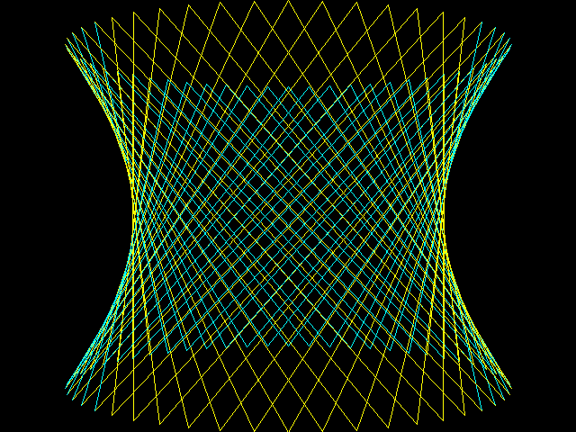

Hyperboloid
MODE 3
XC=MM.HRES\2: YC=MM.VRES\2
D=3: CX=0: CY=-1: CZ=1
For CY=-1 To 1 Step 2
 For I=0 To 2*Pi Step Pi/26
   XM=CX+Sin(I): YM=CY: ZM=CZ+Cos(I)
   XD=CX+Sin(I+Pi/2): YD=-CY: ZD=CZ+Cos(I+Pi/2)
   If (ZM+ZD)/2>CZ Then Color RGB(Cyan) Else Color RGB(Yellow)
   SXM=XM*D/(ZM+D): SYM=YM*D/(ZM+D)
   SXD=XD*D/(ZD+D): SYD=YD*D/(ZD+D)
   Line XC+XC*SXM,YC+YC*SYM,XC+XC*SXD,YC+YC*SYD
 Next
Next

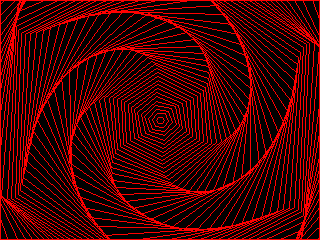

Eldritch
MODE 2
FRAMEBUFFER CREATE
FRAMEBUFFER WRITE F
Dim PLGNX%(6)
Dim PLGNY%(6)
CX=MM.HRES\2:CY=MM.VRES\2
C%=RGB(Red)
 CLS
 For z=1 To 63
   For t=0 To 6
     x=CX+(Sin(t*1.05+Sin(Timer/300+z/10))*(z*4))
     y=CY+(Cos(t*1.05+Sin(Timer/300+z/10))*(z*4))
     PLGNX%(t)=x:PLGNY%(t)=y
   Next
   Polygon 6,PLGNX%(),PLGNY%(),C%
 Next
 FRAMEBUFFER COPY F,N,B

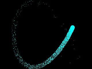

Comet
MODE 2 '1 2 3
cx=MM.HRES\2
cy=MM.VRES\2
cr=7
rd=cy-cr
C=RGB(Cyan)
 For i=1 To 1000
   Pixel Rnd*MM.HRES,Rnd*MM.VRES,0
 Next
 t=Timer/5000
 x=cx+rd*Cos(3*t)
 y=cy+rd*Sin(4*t)
 Circle x,y,cr,,,C,C
mozzie
Joined: 15/06/2020
Posts: 525
Posted: 03:05pm 07 Oct 2026
G'day Javavi,
Some of these short programs are a great learning device, I always look forward to trying out the latest one to see how they work and what can be changed.
That last one had me guessing how it new where to erase the tail, until the realization that its entropy at work. Brilliant in its simplicity
Hope to see many more.
Regards, Lyle.
PilotPirx
Joined: 03/11/2020
Posts: 176
Posted: 07:05am 08 Oct 2026
Hi mozzie,
yes, it's a clever little program.
It's interesting that random deletion produces such an effect.
If you disable the delete function, it draws a Lissajous figure with a frequency ratio of 3:4.
