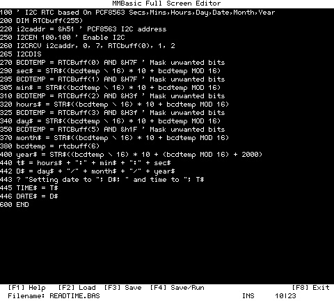

ksdesigns
Joined: 25/06/2011
Posts: 143
Posted: 12:36am 01 Nov 2011
This is what i have been working on Full Screen Editor
so far is working good
then after this time to drop the line numbers

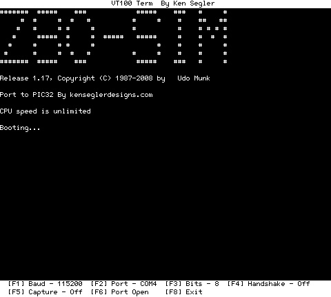

ksdesigns
Joined: 25/06/2011
Posts: 143
Posted: 12:50am 01 Nov 2011
Also Built In VT100 Terminal
