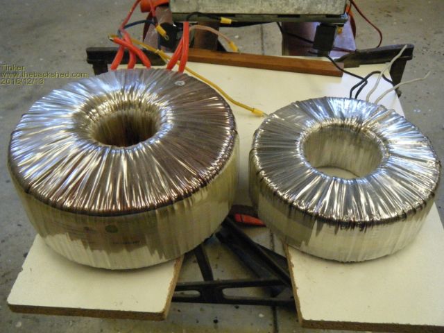

Thanks oztules,, I will be doing a similar test in a few days when I have wound on the new primary to another test toroid.
This one is from the "well known Australian manufacturer", a 2500VA version.
Just for a laugh I placed it next to an aerosharp toroid for comparison:
The one on the left is the aerosharp 3000VA.
20% difference in power, difference in size??
Then I weighed each (fully wound):
Aerosharp, 3000VA:21kg
right side, 2500VA:11kg
I think the "overrated" comment in an earlier message holds water.

Thats a truly massive difference.
To be fair, the aerosharo is designed for no cooling, and true continuous operation, it is a true 3kw unit.
The other one is more a transient device. I dont think it is expected to run full power for long periods like a grid tie would. Most people buying expensive inverters will probably use small battery banks with not enough solar.... so long runs are an anathema to them. A short run with high power start up consideration is probably more important for most folks out there.
That aerosharp will run 8kw for short periods, which is probably enough for most applications, and run 3kw continuous the rest of the time. I overdesign, so I can run 6kw continuous with twin or triple cores.

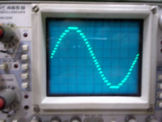

As inverter power rises, it quickly becomes apparent that higher battery voltages are a necessity.
There will always be the dreamers asking for a circuit to build a 5Kw 12v inverter to run off the single battery in their car.''
But for serious off grid applications, if you need many Kwh of battery storage, its a lot more efficient (and dangerous) to have a battery that can directly power an inverter at several hundred volts of dc power, just as the EV people are already doing.
I already have a system running here right now that uses a regulated +/- 230 volt dc bus to dive a pure sinewave inverter that generates 240v rms directly with an unfiltered actual measured distortion of around 2.5%. And its not the usual PWM circuit you might be expecting.
This uses a multi stepped output, rather like a very high power digital to analog converter to convert +ve and -ve dc supplies to a many stepped sine wave.
My camera is not that great, it will not focus up close.
My small primitive experimental prototype inverter uses only 10 steps up and then 10 steps down on the +ve half cycle, and another 10 steps down and up on the negative half cycle. That is 21 steps peak to peak. Its only 1.6 Kw continuous rating but is happily handling surges of several times that. Its been running trouble free for almost a year now, and has survived a lot of abuse.
I am now in the process of building it up properly but in 3Kw form, with 81 steps peak to peak and much lower unfiltered harmonic distortion. It uses multiple (5) small toroidal output transformers, but they are readily available off the shelf items from Altronics. Five relatively small 300Va toroids are easier to package than one multi kilowatt monster toroid.
This style of inverter can be built with 3Kw or 5Kw continuous rating, with a surge rating of several times that with either 300Va or 500Va Altronics transformers. But best of all it is completely bi directional, and so it is very happy with very low power factor loads, that can throw a lot of out of phase current back at the inverter. It starts outrageously large motors with ease, considering its size.
As the low voltage toroidal transformer inverters here have been so popular, and so successful, I don't know if there will be much interest in this very different approach. Probably not I am thinking.
But anyhow, its something rather different that works, is very easy to build, and is a really tough little bastard I have not yet succeeded in blowing up.
What makes it easy to build is that it switches at only a few hundred Hz, uses very tough IGBTs (not the more fragile mosfets) and there is no 20 Khz high frequency PWM switching which seems to be causing people so much grief when paralleling up multiple mosfets. So its all far less critical to build, with much less likelihood of letting the smoke out.Edited by Warpspeed 2016-12-15

The basic idea is to start off with a simple half bridge inverter, plus a ground clamp that can hard switch its output to either +230v dc, ground, or -230v dc.
Next we add a second identical half bridge inverter, but of much lower power that drives a 3:1 step down transformer.
The output of the secondary winding will switch between +76.7V, zero volts (effective short across the winding) and -76.7v.
By connecting this secondary winding in series with the big first inverter and switching both inverters in correct sequence, we can generate voltage steps of 0v 76.7v, 153.3v, 230v, and 306.7v.
That would give us a crude sine wave of four steps up, zero, and four steps down. Nine steps peak to peak. But with the advantage of getting 306.7 volts peak from only a 230v dc source.
Now we can add to that a third inverter with a 9:1 transformer to generate 25.5 volt steps that are spaced evenly between the 76.7 volt steps. Our sinewave starts looking much nicer, and our achievable peak goes up another 25.5 volts to 332.2v.
We can go to a fourth inverter with 27:1 transformer and reach 81 steps peak to peak with only 8.5 volt steps and very low harmonic distortion, and our peak achievable voltage becomes 340.7v. Ain't that wonderful !
That should get you 240v rms from 230 v dc supplies, and it will too under no load.
Absolutely flat out, it will be more like 230v rms output for 230v dc input.
But at least you would be able to do it with 230v dc supply and not 340v dc supply which makes a significant difference.
The advantages are many. All three (or four) inverters are identical except for the transformer, so identical circuit boards can be used. The transformers are all off the shelf items. I am using three 24v transformers in series for the 3:1, and one 24v transformer for the 9:1, and a smaller 160Va 12v transformer with turns removed for the 27:1Edited by Warpspeed 2016-12-15

I will try one more time to load an image.
Nope, still HTTP error 500.
I will try going through Photobucket.
Ah success !
Main high power inverter at the top hard switches between +230v, short to ground, and -230v
Next lower power inverter does the same thing, but through a 3:1 step down transformer to generate (230/3) or 76.7 volt steps.
Next stage in the chain is again identical, but with a 9:1 step down transformer to add 25.6 volt steps between the 76.7 volt steps.
Last stage is very low power, with a 27:1 step down transformer to add 8.5 volt steps.
Final result will give 81 steps peak to peak.
The thread on the other Forum is 18 months old, and I have learned a great deal since then.
If there is any interest I can go much deeper into it with schematics, more pictures and EPROM data.

Posted: 11:29pm 13 Dec 2016
This is the 1.5 Kw prototype about 18 months ago. It was tested and running, but all the transformer connections were made by crocodile clips to get the winding phasing correct.
All the power wiring had yet to be finalized when the picture was taken.
This is what is powering my house right this minute.
The new 3Kw 81 step version is complete and fully wired up, but I have to get more circuit boards made for it, which will probably be well after Christmas.
I could just as easily have made it 5Kw, by just fitting larger transformers, but I don't need that amount of power right now. Something to do later maybe.
