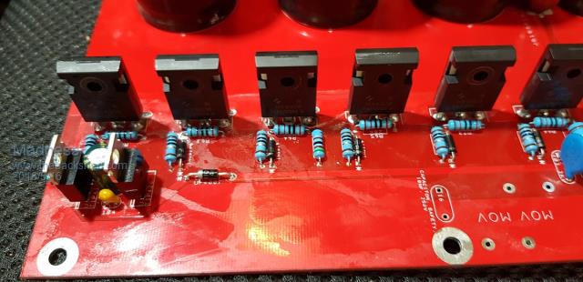

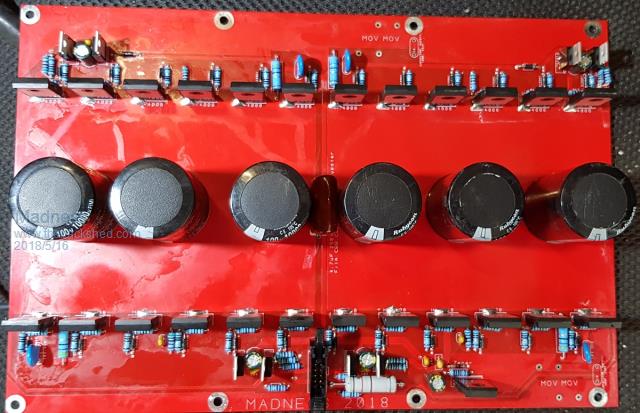

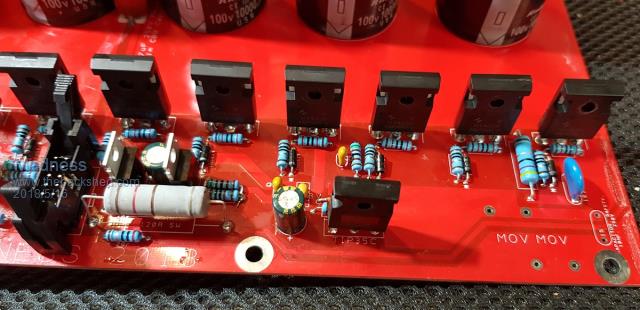

Here is the power board with nearly all the components on it, this board is running with a 2 KW load on it. I would go higher but the breaker I am using for testing would pop.
Don't forget to put a heatsink on the TIP35c.
Edited by Madness 2018-05-17

Can the 120r 5W on the powerboard be a ceramic like on the control board or does it have to be metal film?

Madness
Joined: 08/10/2011
Posts: 2498
Posted: 02:25am 16 May 2018
  renewableMark said   Can the 120r 5W on the powerboard be a ceramic like on the control board or does it have to be metal film?
Does not matter, that one in photo is carbon, what matters is 5W 120 Ohm. I used the Carbon resistor because I have them and am short on the ceramic ones.
I always screw the MOSFETs to the heat sink before soldering them. With the short distance between the body of the FET and the PCB there is no give if they were not all on the same plane. You can clamp the PCB to the heatsink and use a 1.5mm drill in the centre pin holes to mark where each hole needs to drilled and tapped for the screws.
There is a few extra resistors on the PCB that someone with a sharp eye might spot, I need to remove them I was trying something.Edited by Madness 2018-05-17

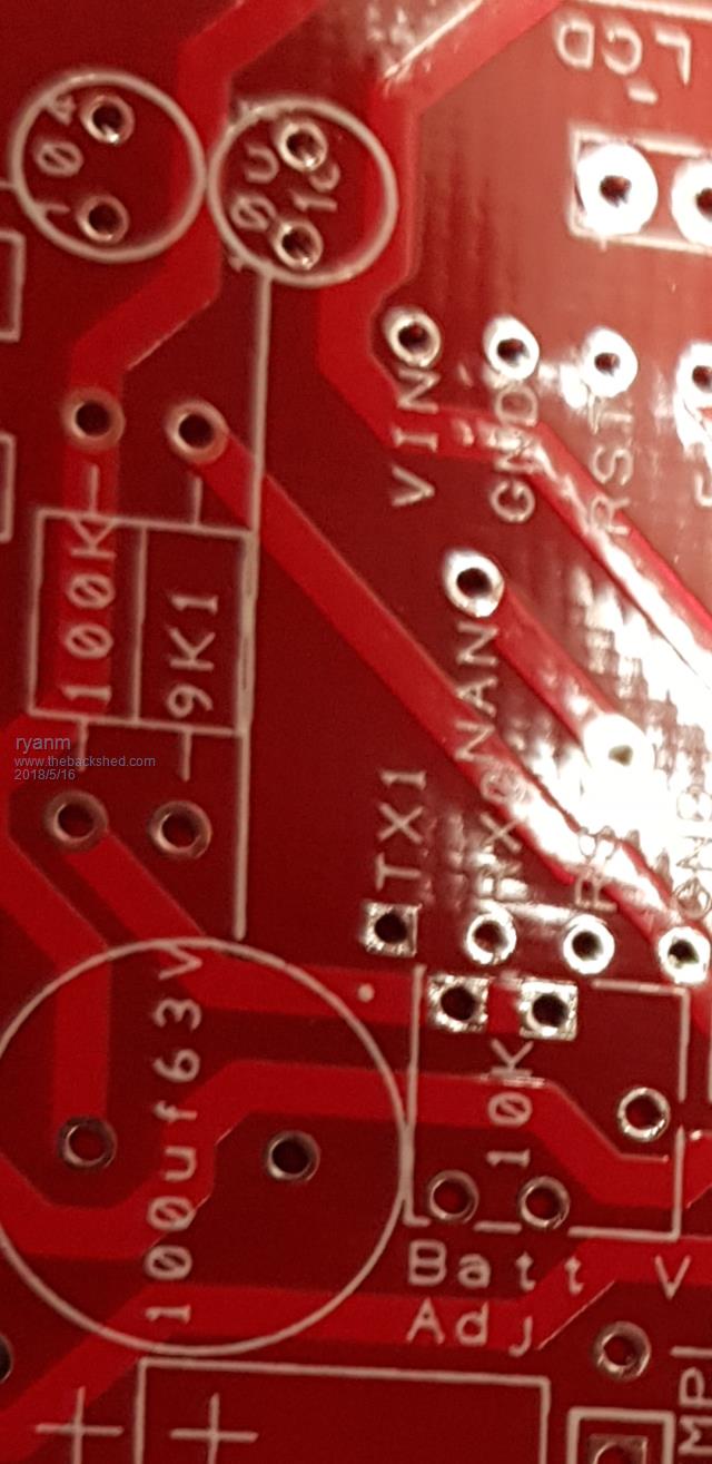

ryanm
Joined: 25/09/2015
Posts: 203
Posted: 10:07am 16 May 2018
I don't mean to look a gift horse in the mouth, but you could leave a bloke a bit more room to land an iron Madness.
PS. Thanks heaps for all your work.

ryanm
Joined: 25/09/2015
Posts: 203
Posted: 10:41am 16 May 2018
I'm just being soft. Quite small solder mask offset around the smaller holes.
ryanm
Joined: 25/09/2015
Posts: 203
Posted: 10:50am 16 May 2018
Just saying those top right pads have a lot better thermal transfer than the bottom left.

Madness
Joined: 08/10/2011
Posts: 2498
Posted: 11:29am 16 May 2018
Those are the default pad sizes in Designspark, changing that would be a major PITA for every component. I don't find any problem soldering them, worked for me and Oz didn't bitch about it either.
On the positive side there is less chance of bridging them. Next time I might do surface mount instead.
