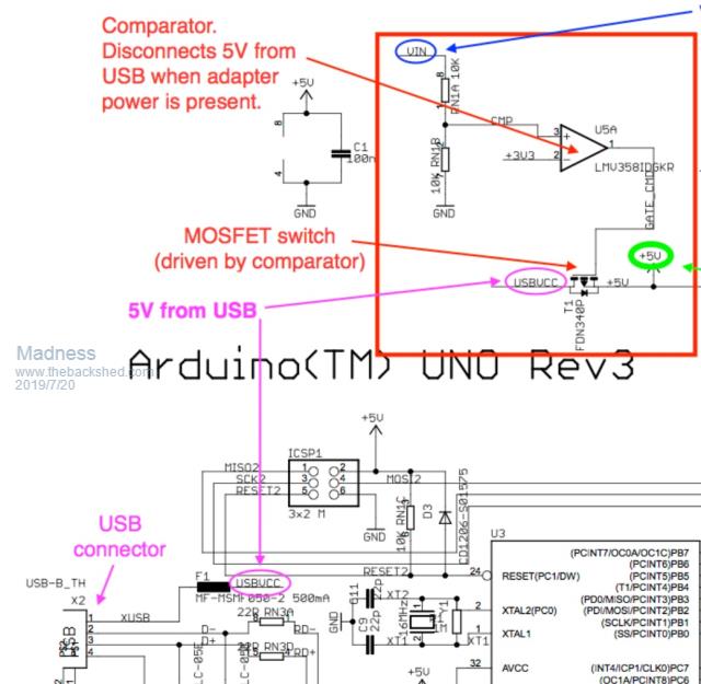

  Madness said  Powering the Nano via 5V also causes issues with plugging a computer into the USB as the computers 5V power supply is then also connected to the inverters 5V rail.
Powering the Nano with 12V to VIN is the recommended way to do it, also ensures the Nano runs more reliably from its own regulator.
How come we don't do it this way?
Cheers Caveman Mark

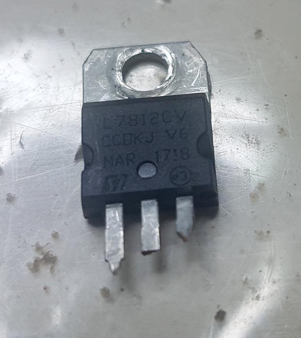

On the second nanoverter board I am building (one for spare #2 for me, one for a friend) I have tested the voltage regulation of the 7812 and 7805.
This board has a 7812 that I am almost certain came from RS Components.
When one or the other or both fans switch on, the 12V output is a straight line!!!
Perfect.
And of course the 5V rail is a straight line.
Dodgy components bites me again.
When will I stop posting all this alarming stuff here.
The parts not from RS are not able to do the 1A specified.
The RS parts romp it in.
Oh Brother.
the under performing one is marked L7812CV
The reg that works is marked 7812CT (an OnSemi part, from RS)
This is getting curious.
I checked my Aliexpress order history and I have not bought 7812 regs from them at all.
So that rules that out. My other sources are Jaycar, RS and Alltronics
I don't want to point the finger at anyone.
I think it's more an experience that teaches me to test things before I go full on with the project.

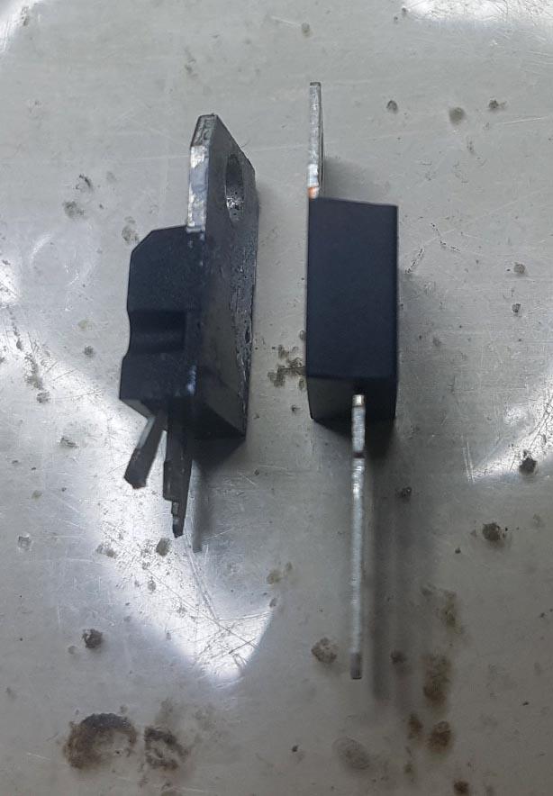

time for some mug shots

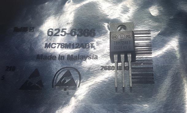

the culprit:
The RS part, with the bag it came in (a 7812 that can produce 0.8A easily)
side by side, different package types for sure.
The good one is on the right.
I probably lost sleep over this last night.
It's just not worth it for a $2 part from ???
or $0.75 ea in a bag of 5 from RS.
The spare nanoverter with the good 7812 still has the 10uF caps on the output
of both the 7812 and the 7805. The outputs are good for the loads
being 0.8A on the 12V output and about 50mA on the 5V. Straight lines with fans on or off.
Edited 2019-10-22 21:31 by poida

That culprit one you have was one of the Ali exp ones we found were getting too hot.
Then we both switched to the jaycar units.
You must have got it mixed in with decent parts and used it again.
Ali is great for it's pricing but you really can't tell if the part is total rubbish unless some testing is done on every single item which isn't feasible.
You could have a bag of 10 and three are good, if you used two good ones from the bag it would be easy to assume the rest were ok, then 12 months down the track you pull out another from that bag and get a dud one.
Leaving you chasing your tail on a new build.

Now getting back to the power supply for the nano.
Currently it's fed with 5v.
As Mad pointed out they are recommended to be powered by 12v (diagram at top of this page)
Is this something that should be addresses?
Cheers Caveman Mark

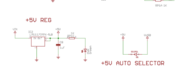

Mark,
here is the relevant part of the nano schematic.
It differs from the UNO board.
Vin will pass through a linear regulator to produce 5V.
If USB 5V is higher + diode drop, then the USB 5V line will power it.
The nanoverter uses the 7805 to produce 5V with is fed into the 2 nano boards
via pin 27.
When I measure this voltage, I see 4.99V according to the Fluke 87.
The schematic shows that the USB 5+ supply has to pass through the diode D1
which will take a bit off the top of the USB 5V should it want to conduct into the
5V supply.
And it won't because the 4.99V on pin 27 will be more than the USB 5V minus
the diode drop.
I measure 5.20V on the USB 5V supply. This is from a powered USB hub.
On the other end of the diode I measure 4.81V.
The voltage drop through this particular diode is 0.4V
So we should expect 1/2 of nothing much to happen to the 5V supply to the nanos (on pin 27) when we plug in the USB connector when the nanoverter board is powered up.
And this is confirmed when I probe the 5V on the 7805 output and pin 27
on nano2 when I plug the (powered) USB connector into it.
A straight line, even when I turn the vertical gain right up on the DSO.
Now, both nano boards have a bootloader running at all times.
This will detect when you connect to the nano using a serial console
and when you first connect, it will force the nano to reboot.
Just plugging in a USB cable will not force a reboot, you need to then connect to the nano via a serial console.
I have had no problem with this behavior, even when the inverter is running.
What happens when I first connect with a running inverter, to nano2 is it stops immediately (just like the EG8010, when you stop it.)
No problem.

So I did a few tests:
First, I bought a 7812 from Jaycar. Then I located the bad 7812 from the Little Box O Horrors* and soldered 3 legs on it. And I found a 7812 sourced from RS Components.
A simple test was set up on the bread board, with 10uF caps on input and output and I had the 12V output lead to the DC load I built.
(I can't even now accept how useful the DC load is and was)
All tests were done with large heat sinks on all 3 7812 linear regulators.
Results are in.
The RS components part could deliver 1.0 Amp easily and it could deliver it into a sharp load increase, from zero to 1A. It signed off, saying "it's all too hard" under a load of 1.1A or so. It could not get to 1.2A without dropping the voltage to about 2V.
The part that gave me lots of trouble (probably some bulk buy from Aliexpress that MArk made and I got to have a few spares) could get to 0.4A and then puke and die, dropping output to less than 3V. Transient load application even at 0.5A resulted in less than 3V output. This is not in spec. The 7812 in TO-220 package should do 1.0A.
This one does not even get to 1/2 way there.
The Jaycar part was inserted into the test board next. No problems at 1.0A.
I could drive it to about 1.4A or so before it signed off, taking it's output voltage down to less than 3V. Transient load applications of well over 1 Amp were fine with this part.
The bottom line?
Get your commodity parts from proper sources.
Clearly, if I wanted 7812 regs, its Jaycar for me. Then RS if I need more than one.

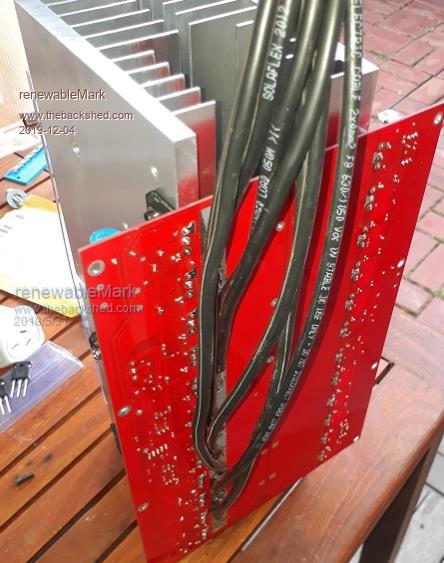

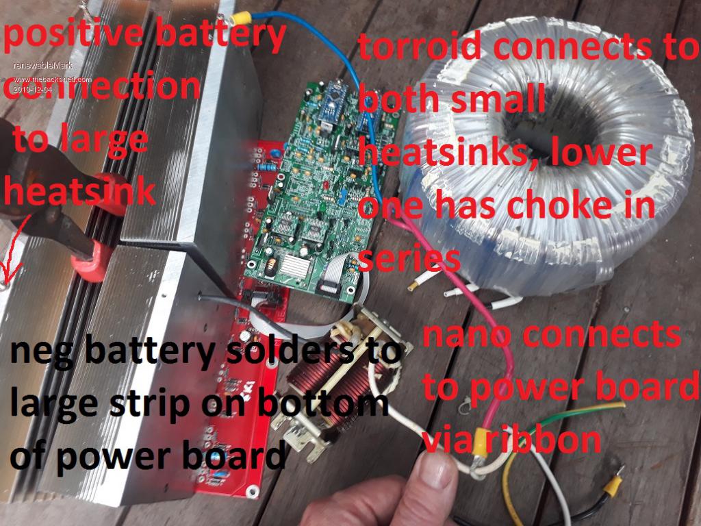

Hi Mark, is there a how to diagram on connecting the toroid up to the nano board and the power board somewhere on the site, I've been looking but can't find anything. Any help on that would be appreciated.
Thanks,
Neil
renewableMark
Joined: 09/12/2017
Posts: 1679
Posted: 09:10pm 03 Dec 2019
Wires are different size of course in a proper one, but this is shown to mock up how it goes together.
The two wires from the torroid going to the small heat sinks are the primary wires, the lower one needs a choke fitted, (bigger the better)
I haven't shown any secondary (240v) connections from the torroid, they will go to the filters and to your output.
Pos battery bolts to large heat sink (maybe in two or more places to spread load).
Neg battery connects to strip on bottom, you'll need to solder on a few wires and connect them together to spread the load around.
Yell out if anything isn't clear
Cheers Caveman Mark
Off grid eastern Melb
