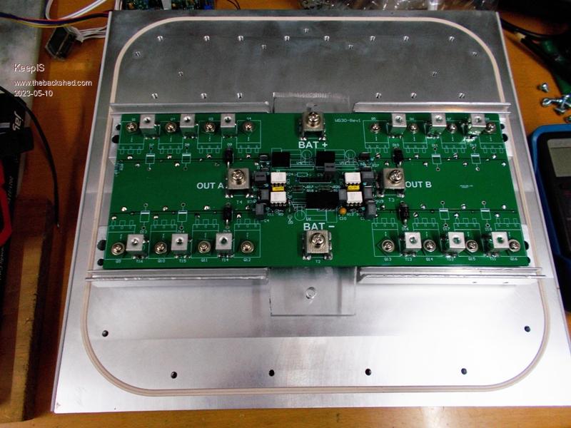

Anyone familiar with a clear non conductive coating on some GTI inverter heatsinks.
In this case an Aurora GTI.
I'm in the process of mounting my inverter power stage and its heat transfer bars to the main heatsink. I'm using heatsink insulating material, I have a meter of it and it's the same thermal coupling material that normally goes between a FET and the heatsink.
This heatsink feels and looks like clean aluminum with nothing on it, but it has no conductivity until you forcible scratch through the coating.
My question is, will this coating reduce the thermal coupling? Keeping in mind that the GTI intermediate heat bars were bolted straight to this heatsink with thermal grease, so I'm wondering if the coating is heat conductive?
Thoughts?

Its probably just clear anodized.
i have never bothered removing it and have not had a problem.
There are so many different treatments out their you can always
run a little experiment and measure the temperature difference between components.
Sum reading if you are interested
https://www.sciencedirect.com/science/article/abs/pii/S0254058413004409

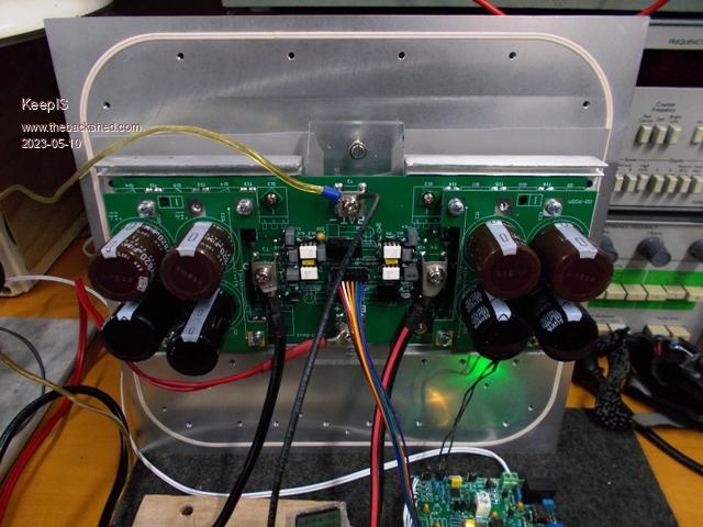

Finished tapping the heat sink, came up with a novel way to clamp the board with its intermediate heat bars to the base heatsink, fired it up and no smoke.
Tomorrow it gets fitted with big caps and plugged into the main Inverter cabinet, it will be driving the triple core Toriod for the first time, and some real loads. A tad nervous.

I have used heatsinks with non-conductive coating and didn't see much thermal transfer difference (through thermal pad) from conductive heatsinks.  So, assuming you have similar coating on yours, it should be fine.
Good luck with the test.

If you look closely at the last picture I posted [08:03pm] you can see the thermal mat underneath the heat transfer bars.

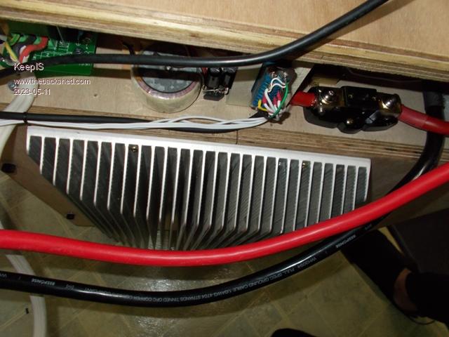

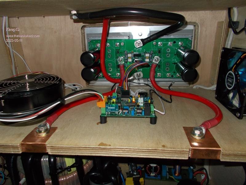

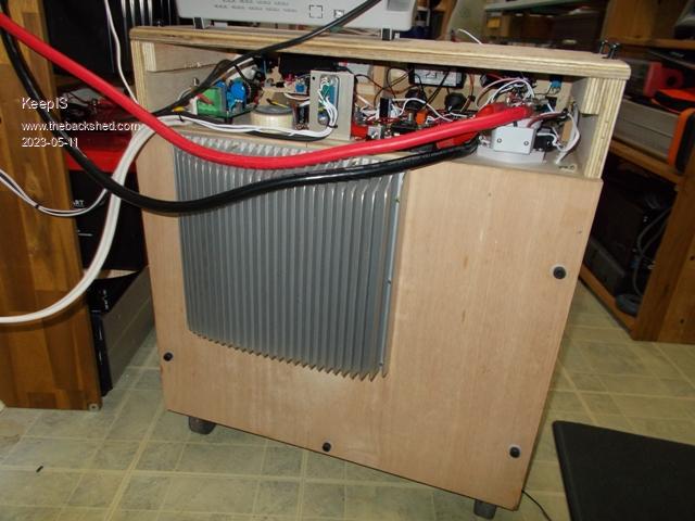

It took me a lot longer then I thought to mount the heatsink through the back of the Cabinet.
The Back simply unbolts so nice to work on, once I was certain it would fit and remeasured about 20  times, used the Band saw to cut the hole and rounded over the inside edge.
I fitted a total of 4 of the big 10,000 caps, cap boards can be removed and fitted in seconds thanks to wiseguys design, and the room I have ih there makes is even easier.

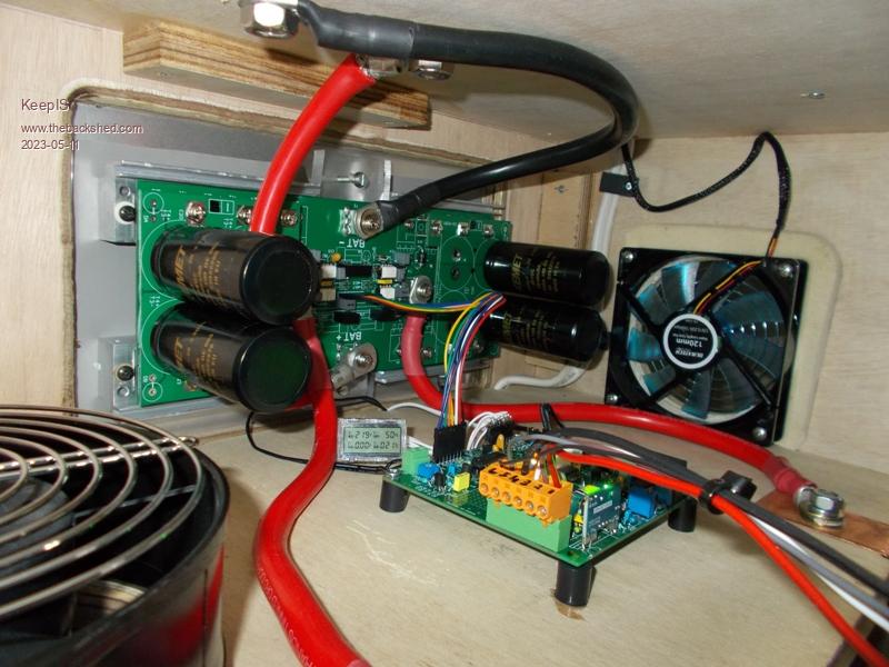

Here it is mounted to the cabinet getting ready for it's first detonation, there is so much room in there now.
Side view to show how little the Power board intrudes into the cabinet.
BTW that cutout is not as rough as it looks, it's very thick marine ply and the little trim router did the best it could making a beveled edge, it looks really neat in reality.

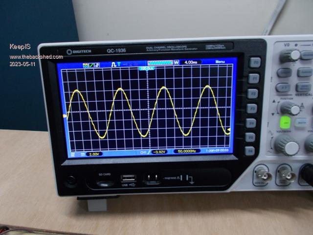

A short time ago I turned it on, and it powered up and ran, no smoke.
Tried it's first big load of 1500w heat gun, no smoke and not even a flicker from the overhead LED fluor lights.
Switched it across from mains to the Inverter powering the home, everything went as expected, I then switched on the heat-gun and bang, lights flicked as it auto switched back to mains power.
The bang was the big contactor dropping out, and the 8010 LED was flashing twice for over current. I wound the current trip all the way up.
BTW the Reset did not work, had to power off and on.
Retested and this time all good, the biggest DC current input so far is 186A, that from an external Vacuum system for the workshop (not the dust extractor)
I tried the Bandsaw, and as soon as I threw the switch it kicked back in my hand as the NVR switch tripped, auto back to mains and over current. The band saw draws around 390A.
Anyway, no blowup, current trip works but needs to be modified for higher current.
There is a slight ripple over the waveform and has nothing to do with filtering, I have a big mains filter as well. Chokes make no difference.
FYI: Nothing in the Lower compartment has been touched, Toriods, ac feedback, chokes, etc, when swapping the power boards over.
Now the interesting thing is, I got a glimpse of the Heat-Gun on LO, that big kink in the standard inverter is replaced with about 5 cycles of a small decaying sinewave [ringing) where the Kink would be, for now I did not want to test that any further.
So at this stage I would say it's looking pretty darn good.
BTW Under a heavy load, the sinewave is as clean as a whistle and absolutely perfect.
Edited 2023-05-11 19:07 by KeepIS

Congratulations you have a running EG8010 one-off Inverter of sorts! So far so good. Yes the max current will need adjusting. I had it calculated for 30A RMS of Mains AC which equates to ~ 150A input current, just a tad less than the 390A that you seem to need for the band saw.
If you put a 270R across the 2 pins of the current transformer input connector - no soldering required - you will double the trip point (~60A RMS of Mains) to input DC ~ 300A RMS or 420A peak that might be enough to get it running.  You can always lower the added R to 250R, 220R, 180R until it either runs continously or just once briefly before the smoke and flying bits...
How long does the bandsaw devour  ~ 16kW for, I am assuming just a second or so ?
You could always leave the trip point at closer to the highest normal run current and put an overload delay window circuit that says ok I'll allow double that current for ~ 2 seconds but if it is higher than double or longer than a couple of seconds within the double window it will then trip ?
How quietly do the 3 toroids run or are the fans too noisy to tell. Also interested in how hot (cold?) the heatsink becomes at a decent few KW load for a while. Maybe you may need something to remove the icicles....
Oh with regard to trip point I am pretty confident that the over current reset should have worked to reset the over current latch, in hind sight I should have also driven an LED when tripped so you could tell whether it is set/reset.  But if the overcurrent is applied for too long to the EG8010 current input, I believe the EG8010 may enter a mode that needs a recycle of power, it also does this if the feedback voltage is too high or too low for too long.   I just read the data sheet, I interpret it to say on page 13/20, if the feedback voltage is too low for ~ 40 seconds or the over current latch is not cleared within 80 seconds it will need a power recycle even if the fault is susequently cleared after that timeout/retry period.
The CRO picture - was there no load on the output ? Whether there was or not the ripple appears to occur immediately after the zero crossings for a few wobbles, that is usually the result of the mains capacitor (1 - 10uF?) and the choke and tranformer winding resonating. I observed this to be worse with no load but mine went away as you loaded the inverter up a bit, it appears to be harmless.

  wiseguy said   How long does the bandsaw devour  ~ 16kW for, I am assuming just a second or so ?
Bandsaw: less then a second @ 390A.
Dust extractor: 2.5 seconds @ 520A.
3Hp Compressor 1 second @ 540A.
Fans do not come on:
The Toriod transformer is virtually silent.
Idling on the bench at 300 watts with just the heat bars, one side got about 1 or 2 deg above ambient. It did that even with no load, and it was the FETS on the -48V side on both heat bars (they are split).
Now, mounted to the Heatsink, it's impossible to know as everything is stone cold.
Hopefully I will find out today under some sustained high power load.
Fine, that makes sense, I was planning to run a Led out to the front panel.
A: CRO pix is No Load:
B: The Sinewave is perfect with loads over 1kW.
C: Changing Choke values did absolutely nothing.
D: Cap is 3.3uf and transformer resonances at 75Hz.
All same values as with previous driver board. The Aerosharp Toroid with 4.4uf did exactly the same thing, even without any choke, identical waveform.
Yes it appears to be harmless, looking closely at the trace, it's very very small and about the same level as the slight furriness on the waveform. This is after a 3 stage AC filter.
The big thing though is this! - There is now zero interference from the inverter in my HAM radio transceiver. Big copper magnetic Loop TX Aerial is mounted just above the Solar panels. There were a few big spikes across the band on the old driver board, now there is nothing but clear signals and normal background noise
Edited 2023-05-12 06:34 by KeepIS

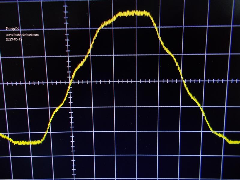

Mike, just out of interest and to give a better view of the waveform running at around 280w load. This is early morning house load at a low point when I grabbed this image.
The Mains AC power has the same flat topping.
I have not got around to finding out what piece of equipment is causing this and I don't really care, it is what it is.
I zoomed in on this, so a but pixelated but it is symmetrical around zero crossing.
Edited 2023-05-12 07:48 by KeepIS
