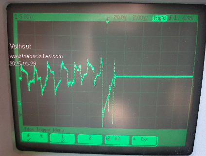

@Peter,
1/ This version has a very good pause/resume
2/ The dc offset after a play tone x,x,time is gone.
But
<ctrl>-C and PLAY STOP have a horrible sound now. The samples (for a short time) go to 0 volts (so maximum amplitude). You might better have simply muted the audio (write 50% dutycycle in the PWM. (**)
But there is a second side effect that I need to investigate. Petscii Robots does not run anymore. With a message "index out of bounds" while reading a file.
Tonight I may find time to look into this, maybe the file on SD card is damaged. I will try a fresh install of Petscii.
(**)= when you keep a certain DC level (PWM) at the output during PAUSE/RESUME a DC coupled amplifier will heat up the speakers during resume (they may even be destroyed). When there is an AC-coupling in the circuit somewhere, the resume will cause a DC jump back to 1.65V. Meaning, you will hear a PLOP AT RESUME. Better mute to 1.65V (50%). May not be the nicest, but in the end most effective and simple solution.
EDIT: a quick check shows that RC7_2 and RC7_3 work fine with petscii robots. It is something in this version that kills it. Maybe the changes in the editor.

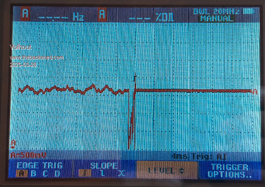

Posts: 6254
Posted: 11:06am 28 Mar 2025
@Peter,
RC8 is different, but not okay.
good:
- play pause/resume are fine (same as RC7_4)
- petscii runs, same as several other games.
not good:
- play stop and <ctrl>-C still give the terrible click (have not used the scope, but it sounds the same as RC7_4).
- Kong does not run. It errors at a RESTORE I1B, where I1B is a correct label. Nicely placed at the start of the line with a colon ":" behind it. so "I1B:"
This is so similar to earlier problems with the IF without THEN, where the THEN is clearly at the same line.
I have not tried all programs, but all in all this is not really different from RC7_4, where some program don't run, and sound is changed, but not perfect yet.
I worry most about the programs that fail to run. These are really scary things. I fear (not confirmed) if I change 1 line in the code, a totally other problem can show.
Can't you go back to RC7_2 (or RC7_3) and only make the 1 audio fix for PAUSE/RESUME. Start from there. RC5, RC6, RC7_2 and RC7_3 where running all programs.
P.S. I don't have RC7 here, I have it in my work. So I can't figure if RC7 is okay. But the patched version RC&_2, and RC&_3 are.
Edited 2025-03-28 21:09 by Volhout

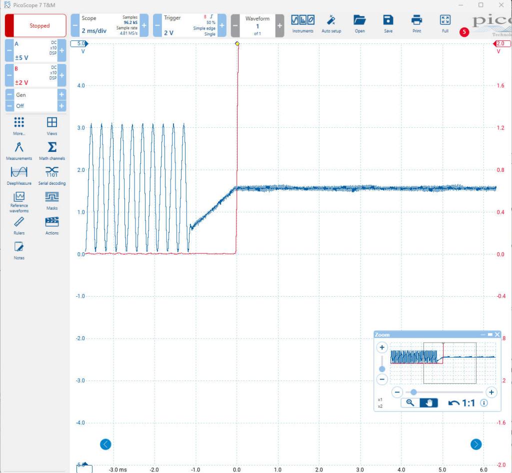

Posts: 12186
Posted: 11:38am 28 Mar 2025
  Quote  play stop and <ctrl>-C still give the terrible click (have not used the scope, but it sounds the same as RC7_4).
I've checked with the scope and before I could trigger on the pulse - now I can't.
PLAY VOLUME 25,25 PLAY TONE 400,400. Set the scope so it just doesn't trigger on the sine wav. PLAY STOP or ctrl-c and it doesn't trigger. Before I was seeing a spike to GND
This is the code for stop audio
  Quote  void StopAudio(void) {
if(CurrentlyPlaying != P_NOTHING ) {
int ramptime=1000000/PWM_FREQ+2;
if(!(Option.AUDIO_MISO_PIN || Option.audio_i2s_bclk))
int ll,l=pwm_hw->slice[AUDIO_SLICE].cc >>16;
int rr,r=pwm_hw->slice[AUDIO_SLICE].cc & 0xFFFF;
int m=((int)(AUDIO_WRAP>>1)*4000)/4096;
l=m-l;
r=m-r;
for(int i=50;i>=0;i--){
ll=m-l*i/50;
rr=m-r*i/50;
pwm_set_both_levels(AUDIO_SLICE,ll,rr);
uSec(ramptime);
CurrentlyPlaying = P_STOP;
uSec(ramptime);
setrate(PWM_FREQ);
pwm_set_irq0_enabled(AUDIO_SLICE, false);
       ppos=0;
       if(Option.AUDIO_MISO_PIN && (CurrentlyPlaying == P_TONE || CurrentlyPlaying==P_SOUND))CurrentlyPlaying = P_WAVOPEN;
else CurrentlyPlaying = P_NOTHING;
SoundPlay = 0;
It reads the current PWM level, and calculates my midpoint 2000/4096, then it ramps between the current level and the midpoint over about 1.2mSec. I don't know with my kit how to view this on the scope other, as above, to confirm it never goes outside of the sine wave envelope and it definitely ends at the desired mid-point.
  Quote  - Kong does not run. It errors at a RESTORE I1B, where I1B is a correct label. Nicely placed at the start of the line with a colon ":" behind it. so "I1B:"
The problem with some of your programs is that you are pushing the available resource to the limits. The IF THEN issue was stack overflowing into heap - nothing to do with the code itself. If you just switched to the RP2350.....
All I do each time is keep trying to find a bit more memory. The easy solution would be to change the heap size from 100Kb to 96Kb but that would definitely break some of your programs.
Please post KONG code and I'll look to see what is causing the problem this time
Edited 2025-03-28 21:52 by matherp
Posts: 12186
Posted: 01:39pm 28 Mar 2025
OK, I dare you to find clicks now
I used a GPIO pin to trigger the scope as either a timed tone ended or immediately after play stop. There were artifacts on the waveform caused by a couple of issue but I think I've stopped them all
PicoMiteVGARP2040.zip
This is a 4000Hz waveform stopped after 600mSec and you can see the nice ramp from the last level back to centre

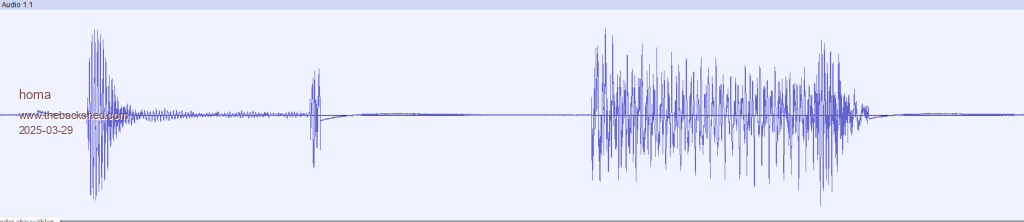

Posted: 04:02pm 28 Mar 2025
I accept the challenge
I have reactivated my old VGA board with the PWM output and installed the latest test version. Unfortunately the rp2040 does not support mp3.
So I used my Sultans.wav for it. What can I say? The sound output is perfect! No PLOPPS to produce, not even with [Ctrl]-[c]. Excellent work Peter!

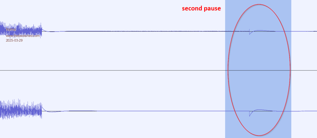

Matthias
Nachtrag:
> play flac "trick
> play pause
> play pause            <-- stop playing with a little little plop ;-)
Error : Nothing playing
Edited 2025-03-29 02:12 by homa

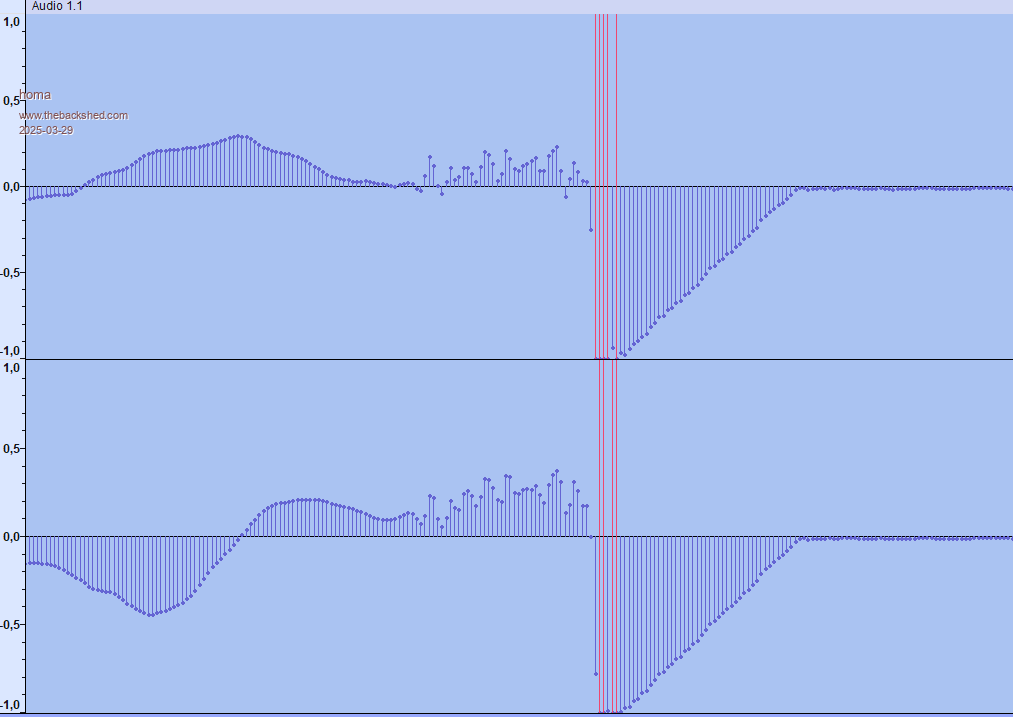

Posts: 6254
Posted: 04:43pm 28 Mar 2025
Sorry Homa,
I have to disagree to some point.
The PLAY TONE is perfect.
PLAY WAV and PLAY FLAC are not always. If feels a bit as if the actual audio sample value has impact on the behaviour. Pictures from a different scope.
Sometimes PLAY STOP is almost perfect. Here a single audio sample is wrong. This is almost inaudible.
Sometimes it is perfect. Like the soft return to 50:50 when playing tone.
But sometimes it is not.
Looking at the PLAY TONE (that always works perfect), the correction is always from values <2000 to 2000 (slope upwards). Also if I look at the waveforms Homa send: the correction is always with a rising slope. If you look at the above picture, the value of the signal is >2000, and should ramp downward to 2000 (falling slope). Is that the problem ?
homa
Joined: 05/11/2021
Posts: 760
Posted: 05:25pm 28 Mar 2025
  matherp said  Homa and Volhout - thanks for the testing. Hopefully this one gets there.
You're welcome, thank you for your persistent work.
with the latest version I have the problem in this case,
pause and restart playback too often:
> play flac "trick
> play pause
> play resume
> play pause
> play resume
> play pause
> play resume
> play pause
> play resume
> play pause
> play resume
> play pause
> play resume
> play stop
as a result:
double pause and stop is no longer a problem,
but this is still ...
> play flac "trick
> play flac "trick
Error : Sound output in use for FLAC
> play resume
Error : Nothing to resume
> play flac "trick
> play pause
> play flac "trick
Error : Sound output in use for PAUSED
> play resume
Edited 2025-03-29 03:30 by homa

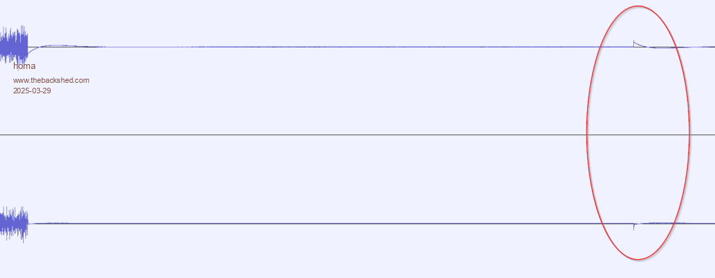

homa
Joined: 05/11/2021
Posts: 760
Posted: 05:41pm 28 Mar 2025
  matherp said
  Quote   Is that the problem ?
No I've tested with falling slopes. How are you doing the triggering at the end of playback?
Try this to see if any different.
Please also post the Kong files I need to test with - thanks
Because of the triggering you probably mean Volhout? I was too lazy for my scope and use audacity and my soundcard in the Yamaha mixer.
With this version, there is always a plop with this pattern:
> play flac "trick
> play pause
> play stop

homa
Joined: 05/11/2021
Posts: 760
Posted: 06:21pm 28 Mar 2025
Hi Peter,
the playing stop usually works without a plop when played back with flac. I don't have a pattern for when it fails. But sometimes it works 10 times without error and then 2-3 times with the plop :-(
I need a break and will try again later.
Maybe Volhout will get something out of it.
Matthias

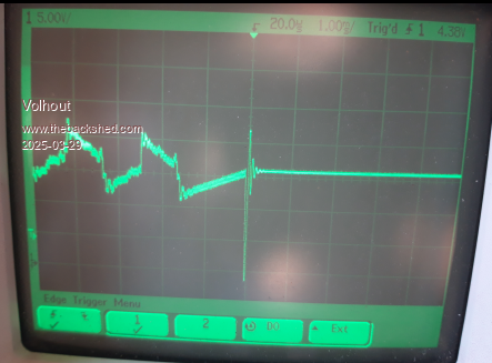

Posts: 6254
Posted: 07:25pm 28 Mar 2025
  matherp said  Once more unto the breach, dear friends
I think I'd got the left and right channels backwards so the slope was on the wrong channel. Of course TONE n,n would show that but TONE n,m gave me the clue
@Peter,
Last version, playing WAV, 90% good PLAY STOP, 10% still the(a) artefact.
Playing FLAC, have not seen it yet.
This version also plays Kong.
If you are close to release I will carefully test all programs more thoroughly.
Triggering: I set the volume so it is between 0.5V and 2.8V max. Then I trigger the scope on 0.3V. These extreme glitches always reach 0V.
The PLAY STOP artefact: I thought it looked like performing a signed operation on an unsigned pwm value.
Edited 2025-03-29 05:54 by Volhout
Posts: 12186
Posted: 07:41pm 28 Mar 2025
  Quote  I thought it looked like performing a signed operation on an unsighned pwm value.
No it appears that reading the current PWM output level off pwm_hw->slice[AUDIO_SLICE].cc is unreliable. Sometimes it returns zero. I've changed the algorithm to remember the last value I set rather than trying to read the register and I can't now  break it - but I'm sure you or Homa can
Edited 2025-03-29 05:43 by matherp
Posts: 6254
Posted: 08:01pm 28 Mar 2025
What Homa is seeing looks what I described as the risk of keeping the last PWM value, and not returning to 50%.
The "tail" of the audio is the AC coupling of the sound card, compensating the DC of the non-50% dutycycle to zero.
Then at resume, you have a charged AC coupling, that is driven by the new (silent ? around 50%) audio, and the capacitor discharges again, with shown result.

I don't want to praise the day before the evening,
but I think you've done it!
I must have tried play, pause, resume, stop 100 times now with flac and wav at different points and moments. Different pieces of music, with lots of quiet passages. Perfect (enough for my ears!) and I think the best stand ever! From the last ZIP with the time 28-03-2025 19:33.
Now when all the Volhout programs are running and no other problems occur ... wait for HDMI version
Peter, excellent, good job!
