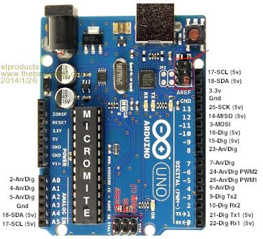

Posted: 04:44am 26 Jan 2014
I want to make an Arduino style board for MicroMite so I can use Arduino shields with it.
Here the pinout arrangement I've come up with.
Does anybody see a conflict?
I repeat the I2C so they line up with the new and old Arduino arrangement.
I also placed every other feature (SPI, PWM, Serial) at the pins that match up to Arduino.
The MicroMite pinout is scattered but easily corrected with a series of variable names for the pin numbers.
i.e. A0 = 2
I replaced the Vref with a 3.3v connection so that header has both ground and 3.3v (I never see anybody use Vref). I also had an extra open pin on the Analog header so I added a ground which is handy for ADC connections.
www.elproducts.com
viscomjim
Joined: 08/01/2014
Posts: 925
Posted: 05:24am 26 Jan 2014
This arduino style board would be awesome for uMite. Keep us posted!
Posts: 4396
Posted: 05:28am 26 Jan 2014
Cross-check with Olimex boards in case something triggers a useful thought.
