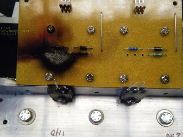

So I was hoping to tickle out 2400W from my rewound 2.5KW toroid with the 4 x HY4008 test inverter.
Well, it handled the half power setting of my fan heater well enough but only lasted a few seconds on full power (2400W) when that happened:
I must say those HY4008 do a spectacular show when they go south.
My copper strip clamp connection method worked well, the bent over leg part on the copper side of the PCB looked fine. The Inside of the chip blew apart and a melt down of the source leg (wide part) occurred at that pictured place.
I was testing the sub heat sink idea BTW but never got it hot enough. Oztules, were your mosfets screwed directly to the heat sink or on silicon washers like mine when you did your 4 mosfet/2.5KW test?
There was a distinct flat part at the zero crossing on one side of the sine curve for the few seconds I could watch the trace but this was not as pronounced as those that Madness pictured in his thread.
I have to get this thing to reliably run 2.5KW on just 4 x HY4008 before I'm game to possibly sacrifice my 16 x HY4008 inverter.

Posted: 11:36am 17 Dec 2016
  oztules said   Warp,
I looked inside the one I am building at the moment, and it looks so stupidly simple..... I look at yours, and see it is not a simple build. I will pour over the plans to see if I can fully understand the switching you worked out.... but will stop there I think.
It looks complicated because there are four power boards and five transformers, but realize that those parts are identical repetition, but there is a fair bit of interwiring as each transformer has six wires coming out of it. So it looks a real tangle.

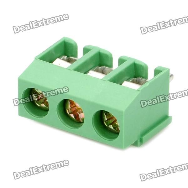

One idea I am pretty pleased with is each power board has four main connections going to it, +230 dc, -230 dc, neutral, and ac out. These terminate on a plain sheet of thin fiberglass from underneath onto four long 4mm screws. The four power circuit boards just drop onto these four long screws from the top.
This makes the four main electrical connections, and holds the power board in position.
I can replace a power board by just removing four nuts and pulling out the plug at the end. No need to stuff around unsoldering individual wires.
Looking at the burn damage to the PCB in the above picture, it is exactly why I now use screw terminal blocks to connect all my TO247 packages onto the circuit board.
It completely eliminates the possibility of damage to the board, and its much quicker to just loosen three screws than to unsolder three mosfet legs.
These screw terminal blocks will easily carry any current the legs of a mosfet or IGBT can carry.

  Madness said   I have made 1mm thick copper overlay to go to the PCB which I am yet to try.
That is an excellent idea.
Having vaporised a few tracks myself, I now sometimes run very heavy single strand copper wire over some critical tracks BEFORE the board blows up, to carry any anticipated fault currents.
It will always burn at the weakest point, and that should hopefully be right at the silicon, not on the circuit board or interconnecting wiring. It is prospective fault current you need to think about, not normal maximum operating current.

Hmm...... not so sure about and mechanical pressure connection on components at this kind of power.
Working in the Micro mechanical World, if you look at that screw block connection and the pressure screw pushing the plated flat with a microscope, the metal surfaces resemble a Mountain range of peaks and troughs.
Yes plating fills some, but the problem is still there.
Heat is also a problem as the constant expansion and contraction on the mechanical connection leaves the connector to become loose over time, and then we are in trouble.
Maybe get away with it with household connections etc, but with this kind of Inverter machine, we require 24hr 365 days a year constant operation, hot, cold, and all sorts of environment conditions.
Remember the machine is pulling serious amounts of power. Poor contacts and its smoking time.
Me I like solder, it connects and spreads the load, but being solder the heat expansion and contraction is not much of an issue on the connection.
Me,... I hate mechanical electrical connections.
Just my two penny worth.
