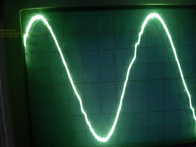

  oztules said   Mad,
Further testing with the inductor gives me a huge range of weird stuff.
It looks like the noise in my transformer is induced by the inductor.
By changing the inductor form iron powder to ferrite, from ecore to ring and changing the turns.. the noise and waveform imperfections changed radically.
On one setting with the ring and 10 turns the tranny was so quite I had to put my ear next to it to see if it was running. With a different ring and 10 turns, the wave from looked like your trace at idle, and sounded like a chaff cutter at idle, but straightened up a lot when loaded.
So it looks like that with removing the 4u7 and fiddling with the inductor, we can change the waveform markedly. It may be I am on the edge of decency with regards to drive, but gee, it gets very good by fiddling the inductor, and removing the 4u7 on the VFB line.
more to follow as I find out more.... gee it would be nice if I knew what I was doing too
...........oztules

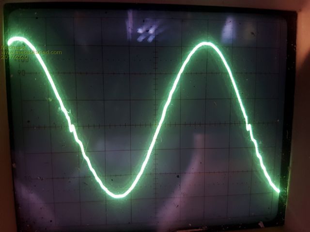

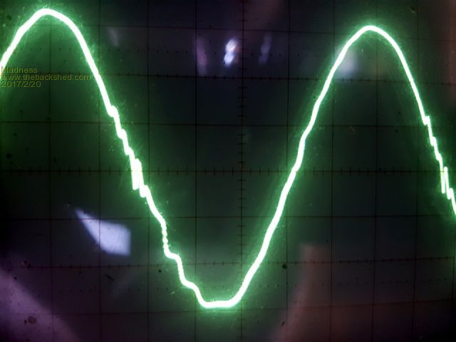

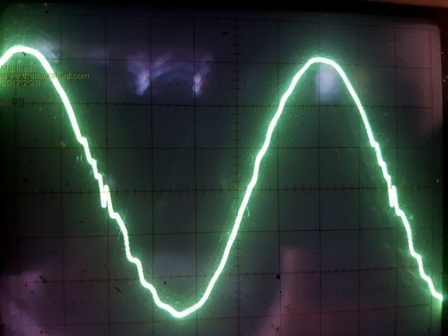

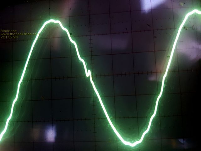

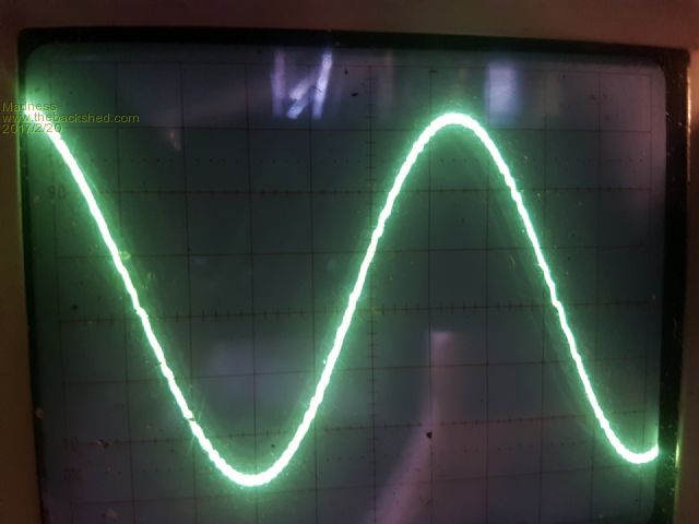

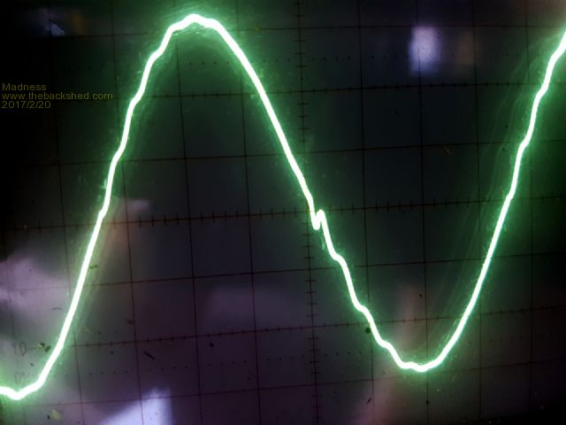

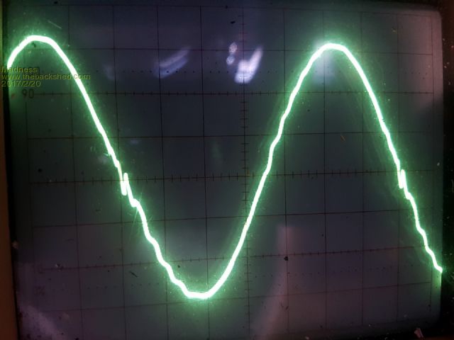

Just been trying a few things with the Inverter, setup is eg8010 board with 4.7uf Monolithic caps added to the 10uf electrolytic on the 12V side of the IR2110, single core Toroid and no load.
1 turn through Ferrite Ring
2 turns through Ferrite Ring
3 turns through Ferrite Ring
4 turns through Ferrite Ring
5 turns through Ferrite Ring
3 turns through E-Core
Posted: 04:15am 20 Feb 2017
Yes but, also measure the no load current.
The whole idea of the E-core or ferrite ring was to reduce this idling current.
Remember, this current draw happens 24/7. So, unless your battery bank can afford to just laugh at this idling current...
Somewhere its going to be a compromise I guess, juggling the lowest idling current with an acceptable sine wave.
Madness
Joined: 08/10/2011
Posts: 2498
Posted: 11:22am 20 Feb 2017
Until I get the waveform correct I am going to keep blowing MOSFETs, there is no compromise on this. I did measure current while doing this and with one turn it was 2A at best just a touch over 1A. With the single turn and no load there was noticeable heating in the Ferrite ring.
Something is amiss I just realised those images are upside down so should be like this.
I will try a different MOSFET board later and see if there is any change as a result of that.Edited by Madness 2017-02-21

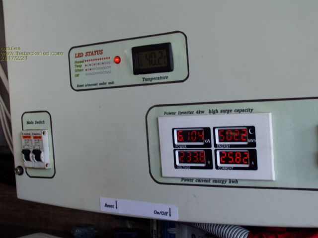

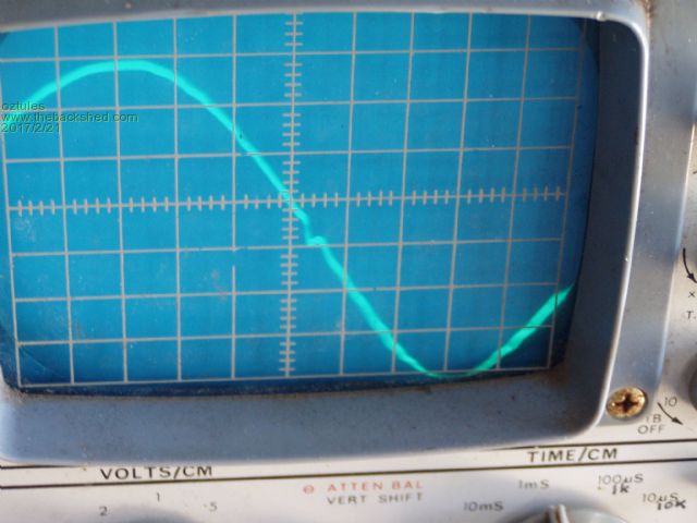

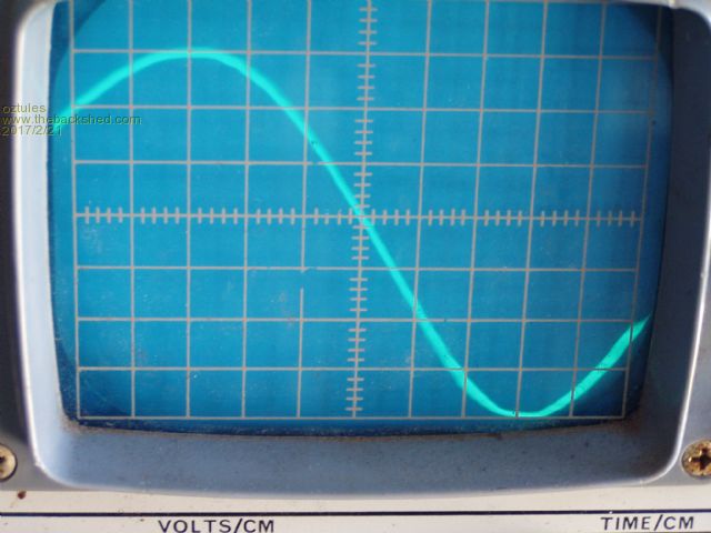

Saw the unit running at 6kw or more, so thought a few pics...
over 6kw driving hot water, front loader, electric jug freezers, tv, etc etc.
Interesting wave form showing a glitch... blown up as big as I can make it...
and it turns out that the glitch was caused by the phase triggering of the front load washing machine motor... each time it rotated slowly for the wash, it got the glitch, then a few second later... would stop, and reverse direction.... whilst stopped, it looks like this.... ( still pulling near 6kw with motor stopped )
So now we know that phase triggered appliances using fair power, will distort the wave form... but not too much... especially when pulling 6kw or more.
I do like these 8010 things.
This one has done half a mega watt, but was only idling for a week or so while I was testing another.
The original power jack unit in the hydro box was a few years old, and gave up while only doing a few watts a couple of days ago..... I think it was to do with sensitive under side of the board stuff.... It would not switch on if left for a few days over here ( very humid island at night ), and would need a hair dryer to start it up... should never have turned that one off for extended periods whilst testing other units in it's place. Have heard of other powr jacks doing the same thing if youleave the tape they stuck on the back ( i did).
........oztules
Edit.... went and had another look after some of the loads went away, and the wave looks identical to the bottom one at 2.2kw, 3.5kw, 4.5kw, and 6.1kw. It was only the phase triggering of the triac control in the washer that made any difference at all. Voltage remained within a volt at all times. ( I run around the 233v mark)
Edited by oztules 2017-02-22

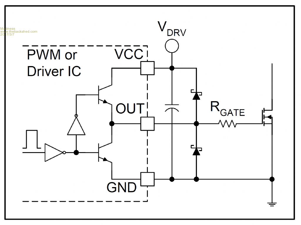

Here is another modification I am planning to try.
I have some 1N5819 Diodes that should be fine for this, here is a description of it.
Driver protection
Another must-do with direct drive and with gate drive ICs using bipolar output stage is to provide suitable protection for the output bipolar
transistors against reverse currents. As indicated in the simplified diagram in Figure 9, the output stage of the integrated bipolar drivers is built from npn transistors due to their more efficient area utilization and better performance.
The npn transistors can handle currents in one direction only. The high side npn can source but can not sink current while the low side is exactly the opposite. Unavoidable oscillations between the source inductor and the input capacitor of the
MOSFET during turn-on and turn-off necessitate that current should be able to flow in both directions at the output of the driver. To provide a path for reverse currents, low forward voltage drop Schottky diodes are generally needed to
protect the outputs. The diodes must be placed very close to the output pin and to the bypass capacitor of the driver. It is important to point out also, that the diodes protect the driver only, they are not clamping the gate-to-source voltage
against excessive ringing especially with direct drive where the control IC might be far away from the gate-source terminals of the MOSFET.Edited by Madness 2017-03-08
Posted: 08:03pm 06 Mar 2017
This is definitely true of bipolar transistor gate drivers as often found in many of the bipolar technology PWM control chips.
However, most of the dedicated high current gate drivers such as TC4452 are CMOS devices and use P and N channel mosfets in the output. Mosfets have internal source drain diodes as part of the normal internal mosfet structure.
Any serious ringing will be clamped by the internal diodes and external shottky protection diodes offer no advantage and are not needed.
Madness
Joined: 08/10/2011
Posts: 2498
Posted: 10:44pm 06 Mar 2017
I guess that would apply to the IR2110's as well.
Posted: 10:59am 07 Mar 2017
  Madness said   I guess that would apply to the IR2110's as well.
IR2110's are mos technology and don't need output protection diodes.
http://pdf1.alldatasheet.com/datasheet-pdf/view/82793/IRF/IR2110.html
Usually the first page of any data sheet will tell you if the chip uses bipolar or mos technology, and the application notes will usually include some circuit examples of good practice. Any special requirements such as output protection diodes will be shown or not there as appropriate.
Here is the data sheet of a fast (1.5 Mhz) PWM control chip that uses bipolar transistors and has a totem pole output. The example circuit shows the protective Shottky diodes on the gate driver outputs.
http://www.ti.com/lit/ds/symlink/uc2825.pdfEdited by Warpspeed 2017-03-08

Posted: 01:38pm 07 Mar 2017
Thanks Warp,
No Diodes on the IR2110 example circuits and they are MOSFETs, I have learnt something :)
