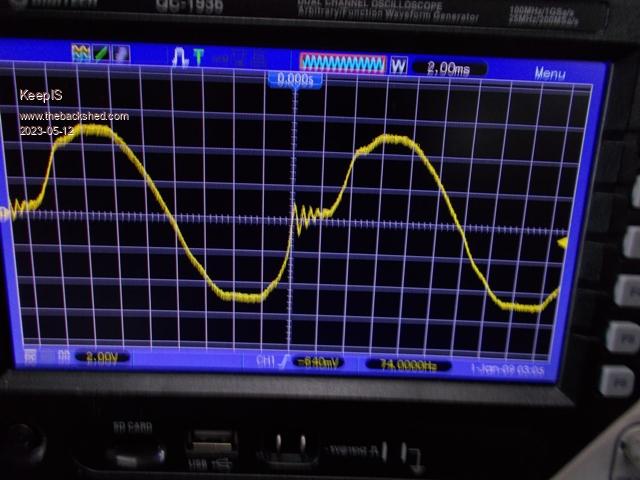

This is the waveform at 2.8kW load looks really good to me, again, for someone just reading ONE post, the flat topping is NOT the inverter.
Now that Nasty Heat gun on LOW.
It's blurred as I held  the camera with one hand and clicked as soon as I switched the heat gun through LOW to off. This is what I got.
Edited 2023-05-12 09:13 by KeepIS

Just for interest sometime try reversing the A & N to the heatgun to see what happens when you use the low setting. As the EG8010 only samples once every 360 degrees you cant know whether the inverter is regulating from the driven half wave or the idling halfwave. I am guessing it will be slightly better one way than the other.
By the way - I looked at those humungous current values you posted and I'm sorry to say you have just voided your warranty
With regard to the flat topping that is usually caused through load rectification followed by a capacitive or battery charging type load as the max energy transfer is taken near the peak, if there is no power factor correction circuitry.  Apart from that I dont know - usually our mains supply is even a bit flat topped as well...
Edited 2023-05-12 10:13 by wiseguy

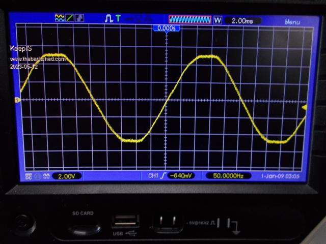

That is correct, the Mains supply is exactly the same flat topped waveform.
I decided to let it run a bit with that waveform and it does not seem to worry it, just buzzes back at you.

Now the better news, you are spot on, the distortion moves to the trailing side of the sinewave when VFB is reversed and the Heat gun is set to destruct.

  KeepIS said  BTW in case you missed it:  You were spot on, the distortion moves to the trailing side of the sinewave when VFB is reversed and the Heat gun is set to destruct.
I was hoping that the waveform distortion might be slightly better by choosing the other half of the waveform to drive the gun.  One day if you haven't looked already could you take a look inside the heat gun, is it possible an SCR is being used for the low setting instead of a diode ?  That is just a wild theory from looking at the distortion shape. That little oscillation at around the zero crossing looks to be the same as the one you get when the solenoid turns off ~ 1kHz ? Very curious how it looks like the FETs aren't doing anything (conducting) at the onset of the oscillation ?  It actually looks like the A&N were swapped at the small voltage sense transformer rather than between the ac outlet and the gun, the waveforms look too identical - which is not a bad thing either ?

Changing the A and N over at the Power lead has the same effect as changing the VFB connections over. Just moves it between leading and lagging, waveform appears to be about the same visually.
