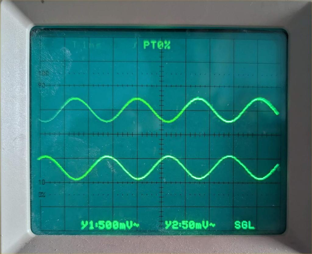

I've just updated B34 as follows:
LIBRARY LIST ALL implemented
Support for mono output in PLAY SOUND
PLAY SOUND chan, M, waveform, freq [,vol]
When M is set the right channel is set to to be the invert of the left
See the previous page for all the details of other changes

Posts: 11914
Posted: 11:18am 03 Apr 2023
No:
The two channels are running as normal just 180 degrees out of phase
Note on my VGA board design I am using GP22 and GP23 for audio (+ GP24,gp29 if DAC)
Edited 2023-04-03 21:20 by matherp

Posted: 02:18pm 03 Apr 2023
G'day Peter,
Once again my thanks, this time for the Mono function in Play Sound
With a little testing so far this has completely removed the noise problems with the Pico switching PSU in mono applications.
Awesome work.
Lyle.
Posts: 11914
Posted: 03:37pm 03 Apr 2023
I can fix PLAY TONE - you will just use a negative frequency for the right channel. This will be in the first release candidate
e.g. PLAY TONE 400,-400
