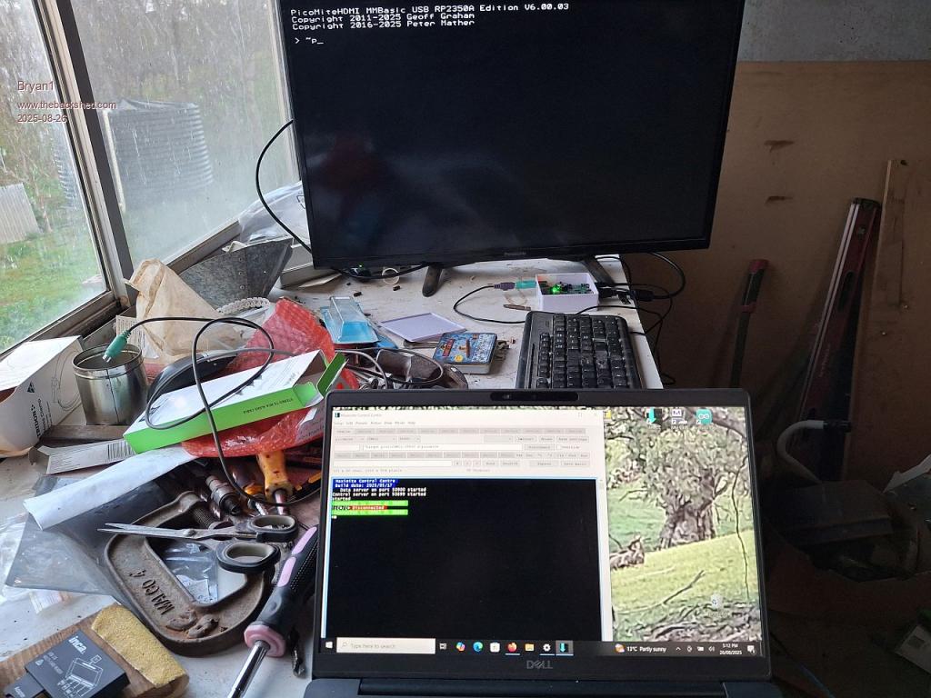

Ok picked up the package this afternoon and got everything down to the house shed and found I had to switch the TV to HDMI input, well that got the screen going nicely.
I had hooked up a USB keyboard that worked on my CMM2 only to find it won't work so went back up to the shed to look for more and only had PS2 keyboards so used the PS2/USB dongle and found the same.
Now at first the device manager said serial device with no driver and on pressing the reset button on the pico2 fixed it and assigned it to COM12.
I fired up teraterm and couldn't get anything typed in as a block was just flashing so tried MMCC and as the screen shot shows I typed list in the type box above as no input was working below and the output is shown on the TV
So not sure what is going on and in the corner by the USB outlets a red led is lit so that may be a clue

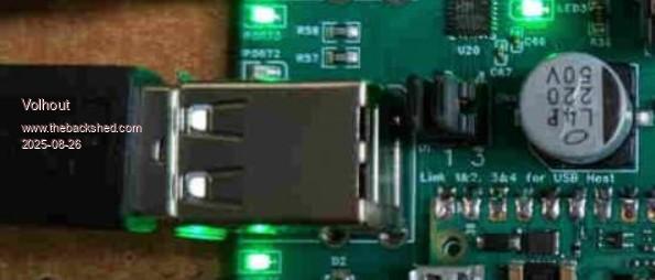

For the COM port, make sure you select 115200 baud. Check if you have below jumpers installed on your board.
Edited 2025-08-26 18:47 by Volhout

HI Harm switching to 115200 in MMCC did the job on the console and when I typed list Gerry had put bubble universe on so typed run and the program worked
My USB keyboard is an old IBM one and no luck getting it going so tomorrow I will go buy a new one along with a new mouse then the fun can begin with the File Manager and my MP3 collection so I can sort out each band into it's own folder then workout which Bacoben songs I lost.
As you can see in the photo it was 4.30pm when I set everything up so a big cleanup is on the cards and mounting the TV so it's off the bench.

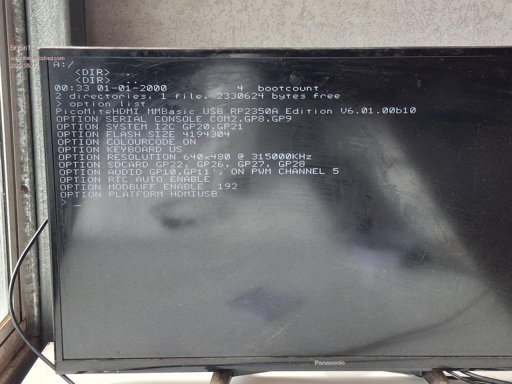

           Went in and bought a new logitech USB keyboard and USB mouse got home hooked them up and still no joy.
So downloaded 6.01B10 and installed it and yes the jumpers for 2-4 were taken out. performed a option reset HDMIUSB and it reset so removed the USB C cable installed the keyboard and mouse and STILL no joy.
I have tried that old USB keyboard and the new one on my laptop and both of them work but trying to get that new one on the board working just won't work and no green led's are lighting up so the problem is with the board.
Here is a screen shot
Now looking at the board there is 4 leds for the usb ports and none are lit just the red led that says active.
Anyway time for lunch then more sleuthing to do to try and get this working
Regards Bryan

Check the orientation of that 4*4 jumper block I sent you. It must end up connecting 1-2 and 3-4. Wrong way round and I only get the Red led, no greens.
Gerry

Hi Gerry just saw your post so came out to the shed and changed that jumper 90 degrees then turned the board on and the leds came on and YEA the keyboard worked.
Just plugged the mouse in and it cameup with
USB Mouse Connected on Channel 2
So typical of me not seeing the wood from the trees
Just reset the board and it did show both the keyboard and mouse are connected
