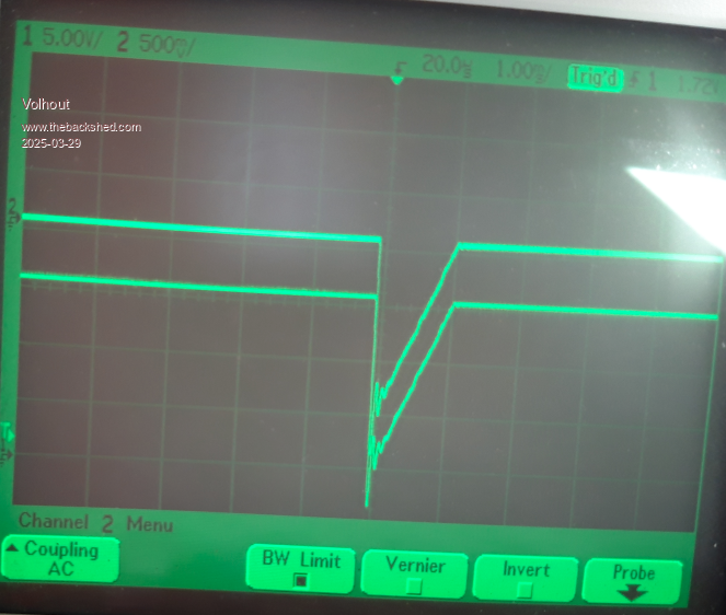

  Quote  MODSAMPLE won't work in MODFILE's PAUSE mode. There is no way to change this?
Completely impossible
  Quote  Then at resume, you have a charged AC coupling, that is driven by the new (silent ? around 50%) audio, and the capacitor discharges again, with shown result.
No nothing to do with that - the issue was that the channels were backwards so stop left was tapering from pause right and visa versa. Didn't show when using tone with both frequencies the same

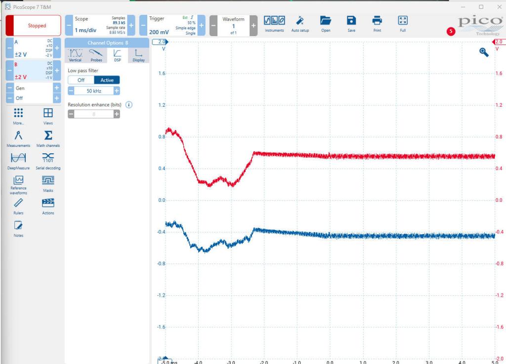

Posts: 6254
Posted: 12:38pm 29 Mar 2025
@Peter,
Did some more testing, playing WAV and PLAY STOP.
At roughly 15% of the cases there is a plop/glitch. And when it happens, it is (up to now) always on both channels at the same time.
This is on the last RC8 test version you released for VGA 2040 only. update:Not on the above mass release. Our posts crossed. Is there anything changed in the new RC8 mass release that makes these tests useless ?
The WAV played (Dire Straits live) starts with a low audio amplitude, so that is why it looks as if nothing is played.

Posts: 6254
Posted: 12:50pm 29 Mar 2025
@Peter,
In the download the 2040 VGA version contains the 2040 USB-VGA firmware,
Posts: 12186
Posted: 01:05pm 29 Mar 2025
Fixed the download - sorry, and just been testing and can't break it irrespective of the direction of the taper - about 50 trials so far
