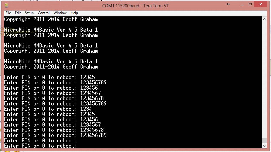

Posted: 01:46pm 26 Jan 2014
Possible bug?
When entering the PIN number, the manual clearly states that it should be less then six(6) characters.
While any PIN number up to six characters works fine, you can still enter a PIN longer then six characters, the MM accepts it, prompts you for it, then you are locked out of the MM forever.
I would assume this is simply because I have exceeded the allowed length of the PIN number.
In my case, I used a PIN of 123456789:
option pin 123456789
MM responded with:
Cycle power, MM asks for PIN number, which never works again.
I know I have killed it through my own experiment, but I will now reset MMBasic as per the manual, but if this is indeed a bug, it would be a good idea if the MM simply said "Rejected." or something, if the PIN is too long when entered with the OPTION PIN command. My 2c only.....
Posts: 10100
Posted: 02:32pm 26 Jan 2014
Resetting MMBasic also does not seem to want to work.
This is POSSIBLY related to the above, as with the PIN being too long, perhaps that also upsets the ability for you to be able to reset MMBasic?
Following the manual:
- MM powered, and asking for the PIN in TT
- Remove console TXD and RXD from level corrector
- Short the two together while MM still powered.
- Remove the short while MM still powered.
- Remove power.
- Replace the console TXD and RXD to the level corrector
- Apply power.
MM still asking for the PIN.

Posts: 3372
Posted: 03:24pm 26 Jan 2014
  Grogster said  it would be a good idea if the MM simply said "Rejected." or something, if the PIN is too long when entered with the OPTION PIN command.
Good point and I will fix it. At least this proves that you cannot do anything once the PIN has been set.
On resetting the Micromite:
- Remove power
- Short the console Tx & Rx
- Apply power
- Remove short and cycle the power.
Or simply put, short the console Tx & Rx while applying power.
Perhaps I should clarify the wording in the manual.
GeoffEdited by Geoffg 2014-01-28
Posts: 10100
Posted: 03:45pm 26 Jan 2014
  Geoffg said  On resetting the Micromite:
- Remove power
- Apply power
Geoff
Oh, makes sense now - thanks, and shorting TXD and RXD while applying power, then short off and cycle power, and the MM is back at the command prompt again.
Yes, I was interpreting the manual as having to keep the MM powered while you do that, which I was wondering how the hell the MM could possibly detect that once up and running.

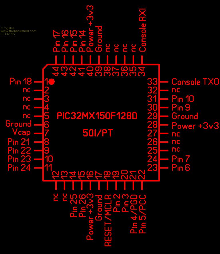

Posts: 10100
Posted: 04:58pm 26 Jan 2014
I have ordered 5 of the 10mm TQFP(0.8mm pin spacing) to play with.
I will make a diagram of the pins for the MM version, and if anyone is interested, they can then refer to the TQFP pinout, IF they want or need that footprint of the device.
I've started using more and more SMD, and although the SOIC is perfectly suitable too, the TQFP spreads the pins out on four sides rather then two, in theory, making it easier to route tracks to the chip - bearing in mind that the TQPF device, used as a MM chip, won't use quite a few of the pins...
I will keep you all posted on this one - I will have to make a prototype board for it.

David M.
Posts: 10100
Posted: 08:50pm 26 Jan 2014
Here is my image of the 44-pin TQFP for the MM:
The IO pins from the 28-pin device are called "Pin" with the corresponding number for the 28-pin device, along with the QFP numbers. The MM pins are quite nicely spread out on all four sides of the QFP, so that should make routing traces a bit easier, as you can plan for certain things to go to the pins on that side of the chip.
TXO is short for TXD out, and RXI is short for RXD in. I stole this from Sparkfun's way of labeling things - really helps to prevent confusing your TXD and RXD lines.
I have yet to design a prototype PCB, but I have designed a footprint for the IC, I just want to wait till the chips actually arrive, so I can check that I have it right before I start any other design.
