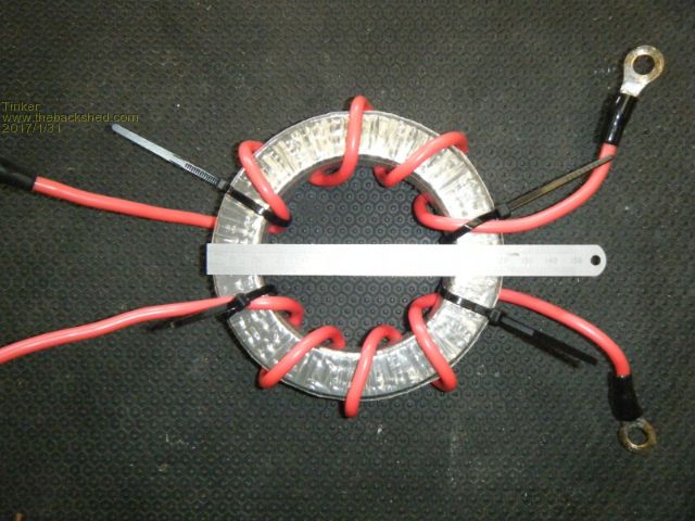

So its been a while since my last post here, there was only a little progress on my monster inverter since.
Madness posted a picture of his ring core ferrite choke recently, the one I'd ordered (its bigger)ferrite ring core
has arrived and I tested it on my 4 Mosfet test inverter.
Well, its certainly quiet, none of that annoying buzz one gets from the E-core chokes.
And there is heaps more room for the cable to wrap around, 8 turns are doable.
So I wrapped 8 turns (of 6mm sq) on and started testing. The trace on the scope looks good, just a small wiggle at the zero crossing line with a 1200W load (all my test toroid can handle with its 4 x HY4008 Mosfets).
Next I replaced the 8 turns with 2 x 4 turns like this:
The idle current is exactly the same as with 8 straight turns, the CRO trace the same too. So this is the way I'm going to wind my ring core choke, using 4 x 20mm sq cable in parallel for each 4 turn wind.
Doing it this way is easier with my placement of the stacked core toroid and the Mosfets on the big heat sink. I can use the individual connections of the chokes to replace extra heavy cable links I had to use before.
Something I found out about these chokes: more turns = < idle current (there is a practical limit here).
Also: bigger core cross section = < idle current.
To test the latter I had the E-core everybody uses which is 540mm sq. and
a larger E core with 850mm sq and
The new ring core with 418mm sq.
The larger E core with 4 turns still had a lower idle current than the ring core with 8 turns - 146.5 versus 172.5mA.
So, if one wishes to push the envelope here I would suggest a double stack ferrite ring core. This would cost almost the same as the 540mm sq E core but be a lot easier to wind on.

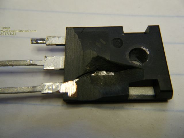

On another matter, I think I found one reason why I managed to blow so many HY4008 chips. The last 'accident' was a gentle affair, just the top of the chip popped off rather than the usual violent explosion.
One can make out the place where one of the two tiny wires that connect the source leg to the substrate was. These 2 wires were no more than 0.5mm in diameter and they are about 5mm long each. Passing 200A through this is a big ask, even if they were silver wires.
So I think that 200A rating is perhaps with an infinite size water cooled heat sink .
My problem was the Mosfets had to be insulated from the heat sink, I used those silicon pads with heat sink compound. When running my test inverter for a while on its max load I measured a temperature difference of almost 10 degrees between the black Mosfet back and the heat sink.
So I now think that sudden extra loads create more heat that can be moved quickly through the silicon washer, the chip overheats and - pop.
What I will do to get around this - I still prefer an outside, non 'life' heatsink - is to mount the Mosfets onto my sub heatsinks straight on. As there are 4 sub heat sinks there is electrically no problem as long as each of the sub heat sinks is insulated from the main heat sink. The heat transfer area is now about 10 times bigger so the insulator should transfer it better too.
I'm using that thin double sided sticky tape, as used to stick heat sinks onto CPU chips. That tape comes in many sizes and thicknesses, I picked the thinnest tape I could find which is 0.06mm. Its quite economical even in the 50m roll it comes.
Best of all, it easily withstood my 90V DC test and its rated to 120 degrees C.
Time will tell if its a success.

I think your turn count is incorrect as i only get 3.5 turns per side on the core.
Maybe that will change the calculations slightly?
Sometimes it just works
Posted: 02:38am 31 Jan 2017
I beg to differ Pete. According to our toroid expert here (oztules), there are *no* half turns with toroid cores.
A turn is counted each time the wire passes through the center hole.
