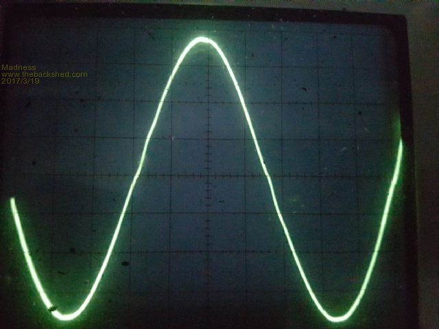

I built another power board last week and it all worked perfectly with 24 MOSFETs giving a perfect waveform, then I added CAPS to the board and spikes appeared and the idle current went from 0.25A to 5A.
Meanwhile I have been trying to isolate why I am getting different results to others and in Poida's thread there is mention of tank circuits etc and what could be causing ripples etc. My heat sinks are very large and electrically part of the primary circuit to the transformer. So I have made a half size test PCB and used some offcuts of heatsinks to make a minimal size version. So far this is woking perfectly. Idle current with the single core toroid is around 12 watts.
The heatsink on the control board is from a flat screen TV, they have lots of nice squat heatsinks like this that don't add any unnecessary height to the PCB.

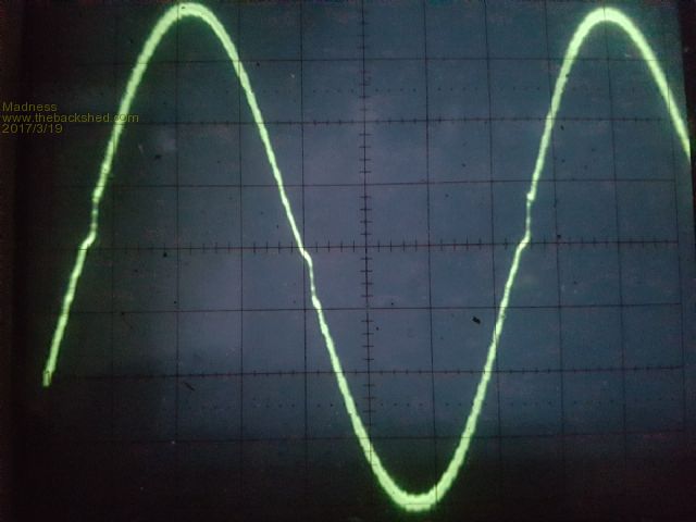

This is with no load
This is with load as shown in the first image

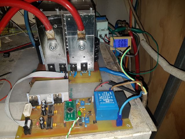

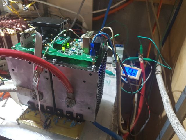

Thanks to Solar Mikes help to post the gate drive circuit here I have the best results I have got so far.
Life has got in the way the last week and finally today I got the PCB completed.
There is room for 4 extra MOSFETs but I don't think they are needed as the HY4008w's are rated at 200A. Idle power with the big Toroid is 40W, I have had it running at 5KW for about 10 minutes, I will give it a bigger load test tomorrow when the sun is out.
Here it is running at 350W running the house.

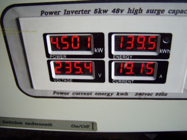

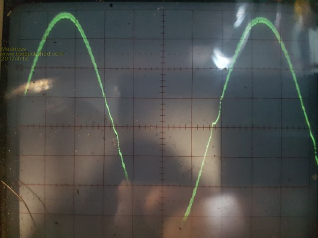

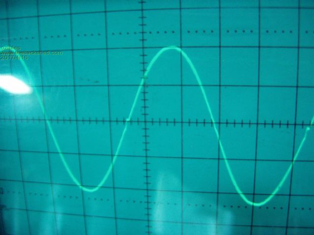

i still just don't know why... walked out to the shed, turned on the scope, the unit was doing 4-5 kw, and the wave was perfectly shaped but for a slight zero cross over on one side of the wave only.
I just cant see why yours is warped and mishapen.. danged if I can... it is annoying, as your board looks the full monty too ... very nice..
I wish I knew why.
Wave at 4-5kw ( see next pic for figures )
Curent status is:
So this one has been under test for 140kwh
Mad, this one is running 4 hy4008 on the outputs, still does the 20kw thing for the 5hp motor... so 6 is excessive for this size unit I think.
The waveform barely differs from the 6x4110's, but easier to build and cheaper on the fets too
............oztules

Some of us are more lucky or different DNA or something, I had somebody point out to me this thread you started on a different forum. On there you talk about the Power Jack you were playing with and how a GTI would not work with it when it had no choke.
No matter what I do also the wave gets fatter at the peak when under load. I am planning to do more experiments with chokes, today I have been unwinding the toriod from a 1 KW SMA GTI. I was planning to build a 12V version for camping but it might be far better to buy a cheap 600W inverter for that. Anyway, I was wondering how the smaller toroid core would go as a choke, also it had a choke on both sides of the toroid. Later tonight I am planning to read Poida's thread again about Inductors. Can you post details again please of the choke you use?

oztules
Joined: 26/07/2007
Posts: 1686
Posted: 12:34am 16 Apr 2017
"You have been quite lately."...... I would love to help you folks, but I have nothing to sensibly add to the discussion as you and tinker are doing things I have not needed to try.
There are 5 of these things going about their business out in the wild, on far flung islands to normal environments, and only one had a shutdown,... why I don't know, but it was noisy and bothered me from the start... it got dismantled and reborn, and since then many MWH have been inverted by those five units every day.
Because of the above, I have not had the need to change anything as yet, so I follow your foibles, in the hope we will all learn something that will explain your present doldrums...... I just can't understand it as you know.
I am pretty sloppy with the inductors I must admit, and have no idea of whats in that particular inverter... will get pics of the ( I think torroids in this one) inductors tomorrow for you to peruse.
That little zit in the scope was due to the chinese ( 700ltr ) freezer running. If that goes off leaving predominately resistive loads ( water bbq jug etc ), there are basically no blips at all.
The washing machine does the same thing if it's heater is off...if on, then less pronounced for the 700w or so of motor starting and stopping all the time.
Yes the experiments with the PJ boards and the GTI did blow o/loads without the choke... and I don't know why really... and I have not repeated the scenario as you would understand... it looked like the PJ was toast for a second or two... so I was not keen to do that again to double check.
Once the choke was there, it works for years every day out on one of the islands in particular ( uses 2kw of solar a long way from the batteries, so now helps run the salt water RO from down where it is since it was installed this year.
Also the generator back up consists of a few kw of cap excited genny, through caps, rectified, and then through aerosharp 3kw unit... once again, way down in the shearing shed, so it is not really heard from up at the house, but still charges the battery and runs the house when the batts are low...... so continue your tests.
There is also one where the AWP mill is, and he has 2 x 1.5kw aero sharps running backwards every day for the last ... probably 3-4 years I guess.
Mike.... I want saturation after a few nano seconds... but even so, the effective frequency will have dropped off anyway... ie it is only the freq of the high speed change in voltage over a change in time that we are trying to interact with.... the moment we get near switched on, we want minimum interference from the choke for max current transfer to the torroid.
So we may be in the 100mhz range for x nano seconds, and drop off from that quickly... in fact the faster we switch, the shorter the time the inductor will do any useful impediment to the current flow.... If it saturated as well, that would be nice..less leakage... I don't think 20khz will be too involved with a few uH.
The ferrite inductors don't seem to get very warm in operation, so their duty cycle must be brief.... powder iron cores seem to warm up much more.
Or in other words, perhaps test your theory, and see what happens in practice, it is difficult to guess accurately in these circumstances... as we don't know for certain what is happening in there in any case.
..........oztules
Edited by oztules 2017-04-17

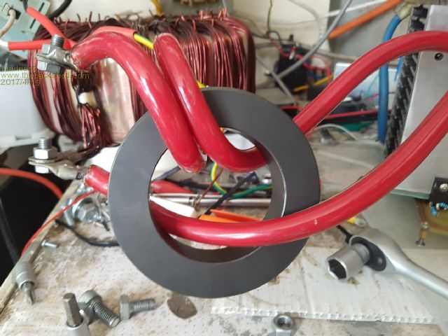

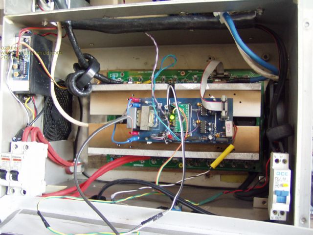

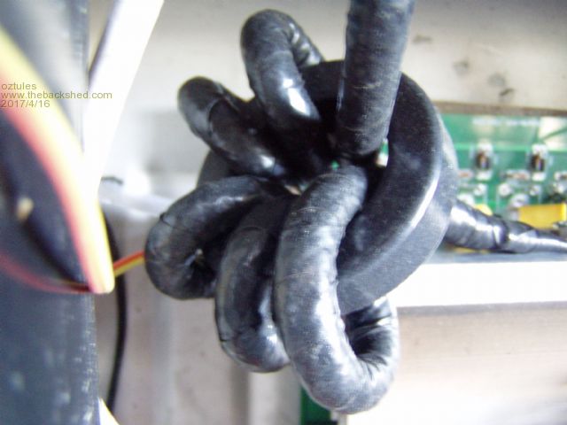

Ok Mad,
It is a torroid ( powdered iron I think ) with 6 or so turns..
pic tells it all....
Here is the set up.
........oztules

Oz, I see you don't make any special effort to wind the inductor tight or anything, maybe I am barking up the wrong tree with the inductor??????

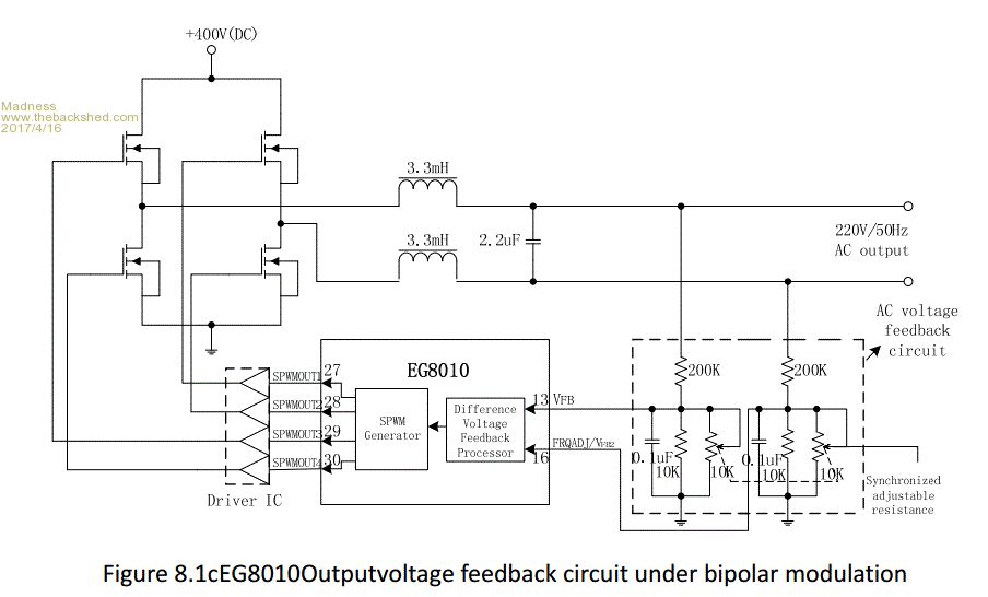

Another thought I had after sleeping on it is to try Bipolar, I see that would involve some modification on the control board as well as per the circuit below.
Also I am thinking if a common mode ferrite ring choke would work with it.

A toroid can be as ugly as sin and it will work fine. One pass through the hole equals one turn, no matter what the wire does to get back around to the other side around the outside of the toroid. One pass = one turn even if the wire around the outside as a foot long. No need at all to wrap it tightly.

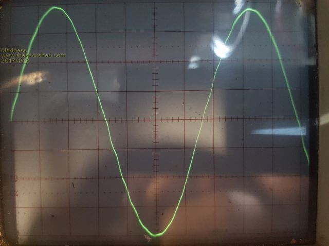

Posted: 12:58am 18 Apr 2017

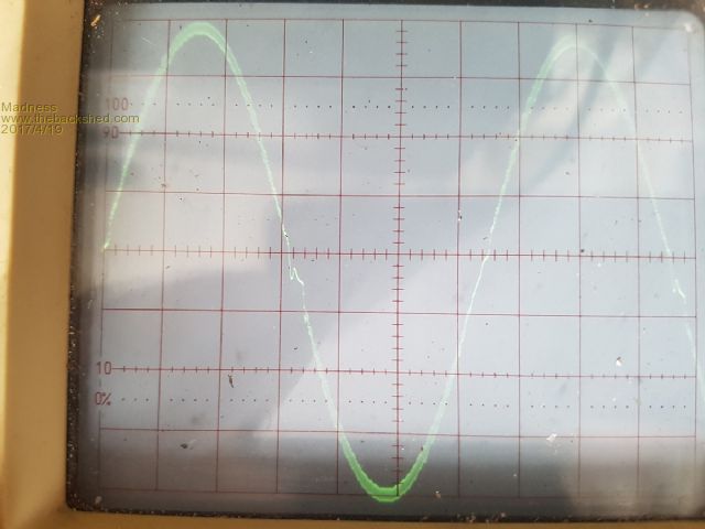

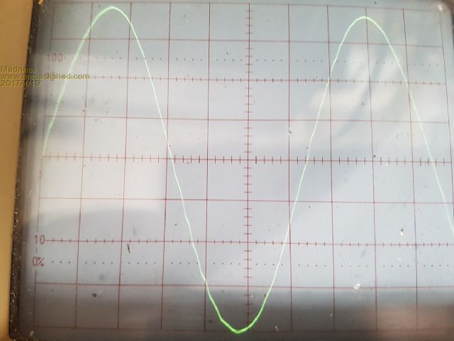

I finally made a proper heatsink for the mini Inverter shown here previously. It has 12 4110 FETs all standard Oztules circuit just minus 12 FETS and 2 caps.
It is connected to a single core toroid and a 65mm ecore choke with 3.5 turns.
Here is no load, idle current is about 20W.
And 9A @230V fan heater load, runs very cool, no fans and the heatsink just got to 10 degrees above ambient..
Only parts in common with my big inverter is the battery bank and the Oscilloscope.
I will try a few different choke setups to see if it will improve.

oztules
Joined: 26/07/2007
Posts: 1686
Posted: 10:55am 18 Apr 2017
Nice little unit.
I expect it would drive a normal house just fine.
If it does not get hot... ignore the waveform, see how it runs longer term if you can keep the house loads under say <4kw for 10 minute periods, and <2kw for most of the time. That would be most houses off grid.
Check the leg connection of the 8010 to the circuit board.... maybe intermittant fault in there somewhere when it runs for 10 days and fails.
What was the sine wave like when the heats sinks were not attatched?
........oztulesEdited by oztules 2017-04-19

My plan is to put it in a single case and eventually be a backup Inverter. In the meantime, I want to see how it goes with a GTI connected.
I have not tried it with no heat sink, I did put it on one of my really big heatsinks and it performed the same, won't take much to try with no heat sink.
Posted: 12:19pm 18 Apr 2017
Klaus,
Neglecting any resistance, if you switch 48v across an 0.7uH inductance, the rate of current rise is going to be about 69 amps per microsecond.
At 20Khz, with full 50%/50% duty cycle the on time will be 25uS.
A peak to peak ripple current of 25uS x 69 amps = 1,725 amps peak to peak is theoretically possible.
That is well into "GO BANG" territory.

I have made some progress with this in a number of areas.
I changed the choke to a ferrite ring, I got the best result with 2 turns from the SPWM side of the inverter and one from the other side, Idle current went up a little to around 25 watts but the waveform is better.
No Load
Under Load
After making these changes I tried the GTI on it and it failed again so I changed the GTI main PCB and IGBT driver boards and it now works with this inverter. Then I tried it with the big inverter and it failed after only 30 seconds or so under load. Later I will transfer the Ferrite to the big Inverter and see how it behaves with the GTI.
