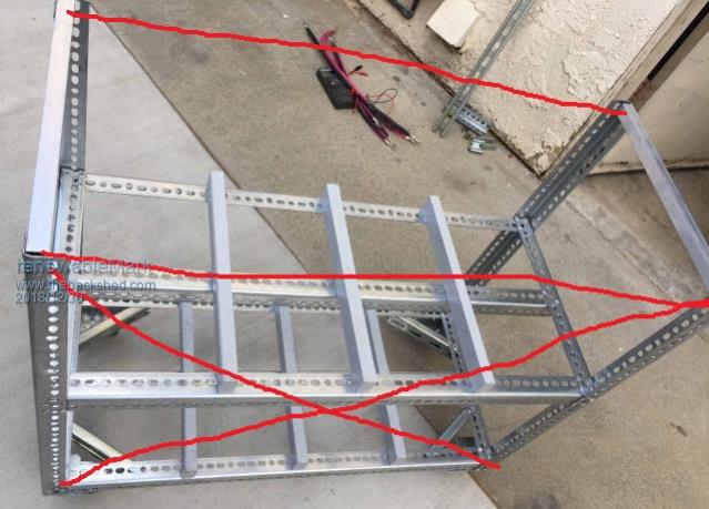

Nice work Tiny, maybe add some diagonal brace at the back and if needed a couple of extra ones at the top.
What batteries are you putting in it?
Or you could just put a bench top on it and make it into an extra work bench.Edited by renewableMark 2018-12-31

Looks the part tinyt , when the wooden covers are added it will be amazingly strong.
If you are worried about the weight of the batteries, fasten a piece of plywood under the
batteries, too the top of battery carrier rails.

I plan to put the diagonal braces if needed. I did used 3 or 4 4.76mm dia. pop rivets at the corners where I think stronger joints are needed. Initially I was going to weld them but chose the rivets to keep the zinc plating intact.
I will be using four RNG-BATT-AGM12-100 and place them at the bottom shelf. When I have more funds, I will add four at the top shelf.Edited by tinyt 2019-01-01

It looks like you had a Meccano set when you were a kid .
Great idea, though these perforated angles are expensive here.
