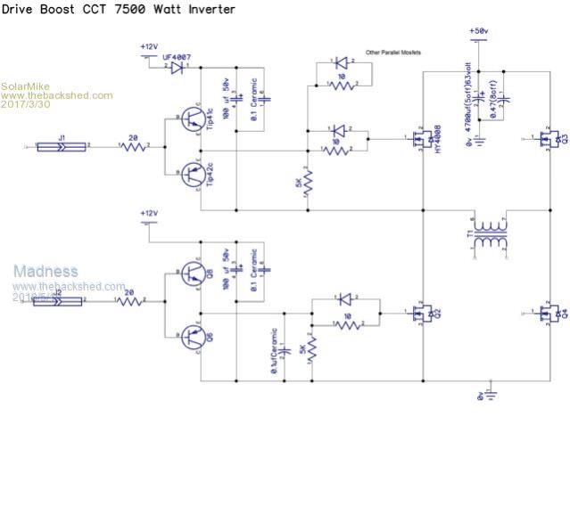

tinyt did a very nice circuit diagram... this is the one I think.

In addition to the circuit Oz mentions above this is the basis of the Totem Pole circuit for the power PCBs in this thread.

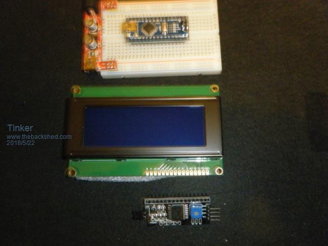

OK, these parts have arrived, what shall I do with them?
So far I have this:
The nano, a display and a breadboard.
Question about that display, it comes with a serial interface card which solders? to the board. Or is it better to use a socket? The pins are long enough for a socket.
Also, there are no pin marks on the interface so it could fit on either side of the display. The website shows a pic with the interface fitted to the back of the display. Is this correct?
I have no experience with this type nano so any suggestion where to read up on it are welcome. I did watch that flashing LED youtube BTW.
And where is that "library", as often mentioned here, to be found? Presumably it has demo programs available there?
I suppose I need to download some program that lets my laptop communicate with this Arduino. As there seem to be quite a few versions of arduino's, what exactly do I look for to download.
Should I ask these questions over at the other forum?

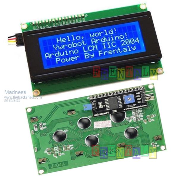

This should keep you occupied for a few days Klaus.
Just solder the display serial interface to the back of the LCD, you could put a socket if you think you might wire it up arse about face and kill the IC2 board.
Goes like this
Start here with step by step instructions to setup your computer.
Here is a very good video that goes through installing the LCD step by step. Just change the (16,2) to (20,4) don't worry that the video shows an Uno, it is essentially the same as a Nano but with a different PCB.

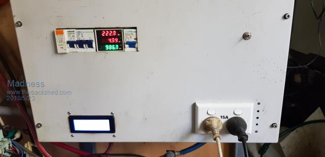

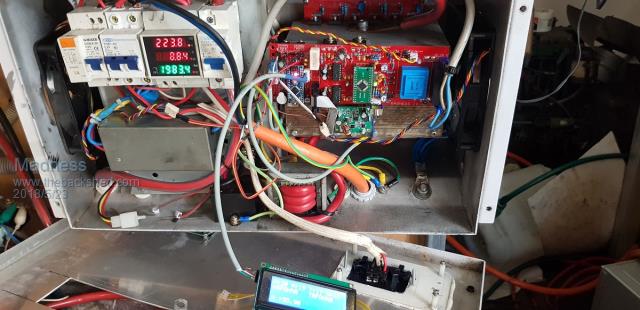

Here is the Sketch I have just completed for the control board, it now includes low voltage shutdown as well as the fan control. This is the part of the Sketch with these settings.
double HSsetpoint = 35; //Heatsink Target Temperature
double TRsetpoint = 45; //Toroid Target Temperature
int MinVolts = 47; //Battery Volts to shut down
int TimeAtMinVolts = 20; //How many seconds below MinVolts till shout down is triggered
int RestartTime = 10; // How many minutes to restart if battery volts recover above MinVolts

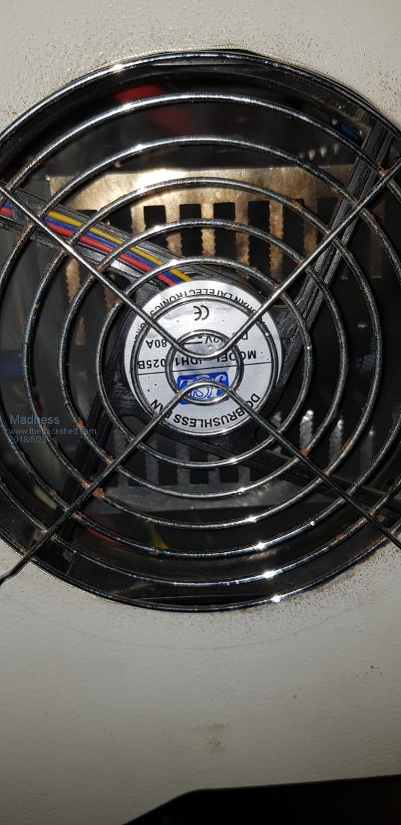

I think that is explained well enough. Fan temperature settings uses a PID Algorithm, so it will run the fans as fast or slow as required to maintain the Temperature Setpoints. If you have installed a beeper it will continue to beep as long as the Inverter is shut down in low voltage condition. Pressing reset will avoid it beeping until the restart elapses if the voltage is correct.
The display shows current temperature and next to that after the M: is the maximum temperature since the last reset. Next line shows fan speed as a percentage. Also you may need to fiddle with the resistor ratios in the code to get a correct voltage reading if there is insufficient adjustment.
float R1 = 105000.0; // resistance of R1 (100K)
float R2 = 8000.0; // resistance of R2 (8K2) For setting up voltage divider to get correct voltage reading Use in conjunction with trim pot on pcb
I am also going to make a small modification to the PCB so you don't need to modify the addresses for each individual temperature sensor.

I got this Inverter running today, a single core from an Aerosharp with inner windings unmodified. PCB is a half size one with just 12 HY4008 MOSFETs in total. Ran it for one hour at 4KW and with the sketch posted this morning. It was around 25 degrees with the 2 heaters I had running and the toriod went to a maximum of 48 degrees and the heatsink 37. The PID algorithm does a very good job of controlling the temperature and it was only the long hard test that the fans got to 100% and the temperature rose to just above the setpoint.
It worked perfectly with the plug in on/off switch but kept restarting with the switch on the front panel. That is when I changed to shielded wire and it has not missed a beat, the house has been running off it since late this morning. Now this one is running I am going to change the PCBs in my big inverter.
I got tied up on some phone calls will the 4KW test was running and did not get photos of that, but it would run 24/7 at that power level.
These 140mm fans help a lot.
