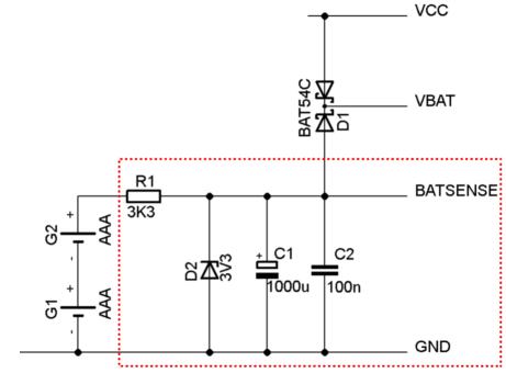

this was my solution. Figured I'll need another pin anyway as VBAT can't be trusted with power on... so I went back to my A/D idea to sample the battery directly and provide a degree of protection.
the new circuitry is in the red box. I have tested this with a 180K load and from 2.2V, C1 holds above 1.65V for around minute which should be enough to change a set of batteries with the power off.
D2 acts to limit the voltage coming off the AAAs and clamps to GND in the event the batteries get inserted wrong way round. There are some high voltage rechargeables (Zinc/Air?) which are nominally 1.6V but can approach 2V after a charge - two of those could easily exceed the specs. C2 just clips any noise from the zener.
Going to knock up a tiny little board to piggy-back where the cell holder used to be and run the wires for the AAA holder out to somewhere easy to get at.
In the software I will monitor BATSENSE with an AD pin every 10 minutes or so and show the battery voltage somewhere discreet, change it to red and start flashing at 2.2V (and latch it). A touch on it in my GUI pack (more on that soon) will display a help window advising the battery change options/procedure... or something like that.

never did a PCB. Was only the one F4 that needed it at the time, did it on a square of "sea of holes" PCB/perfboard held in the place of the Coin-cell holder with a sticky foam pad. Works fine. I supplied-with and recommended "Energizer Max Alkaline" because Energizer guarantee and will repair at their cost (i.e. by sending the kit to me) if their cells leak and damage stuff.
The software does as I planned, monitors BATSENSE every 5 minutes and updates a text element of the display. Instructions to the user is "change the batteries with the power on". Hasn't happened yet (nor is it likely for a few years - possibly even the life of the kit).

@matherp. Thanks for the clarification. That's exactly what happened to me.
@CaptainBoing. Thanks for the update. Good to hear that it all worked as designed.
