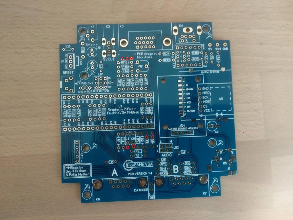

Posts: 4410
Posted: 09:06am 18 May 2022
Hey Mick,
There are 7 holes (circled red below) in the 1.4 board that I don't understand the purpose of, can you enlighten me ?
Posts: 9329
Posted: 09:20am 18 May 2022
I can indeed. :)
The group of 3 at the top is for an optional in-line 200R multi-turn preset pot to replace both R16 and VR1. Some people may have one already. It's mentioned in the notes, I think. The top corners of it are indicated by little corner marks on the pcb.
The others allow you to install Volhout's circuit instead of the standard one for the audio. Once again, ISTR that this is in the notes. If you are using the voltage regulator there is little between them. Volhout uses resistors in the C5 and C6 positions and capacitors in the other positions - the hole centres are wrong, obviously, so I added additional holes to make things easy.
