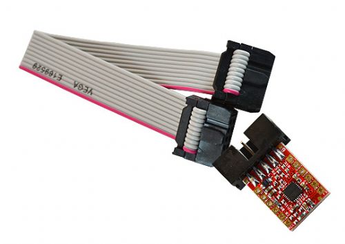

I see UEXT Olimex connector as a good solution for a network of I2C devices, serial comm. and one SPI device (up to 5 if nothing else is used). It can be a standard and there are already devices made for the bus. In my opinion, is better "designed" than the Mikroelektronika bus, and easier to use and to make the PCB board, easier to clamp connectors on the bus cable.Edited by vasi 2014-01-28

In UEXT case, here is about a single (long) cable in many applications but yes, there can be many cables if required. In my opinion is a better system than the stackable one. Usually, the sensors are outside the main board.
Here is the Mikroelektronika solution (stacks):
Theboards have female connectors - that is bad as there is less endurance.
Here is Olimex solution:
Does not matter if is the main board or the sensor board, all of them have male connectors. The worn-able parts are on the removable/replaceable cable. This is what I consider design based on experience.

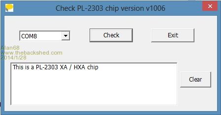

I've been having problems with Tera Term, I've got a GPS receiver connected to the MicroMite and when I have NMEA data scrolling up the screen on my laptop just slowing certain sentences after a few minutes Tera Term starts showing rubbish scrolling up the screen and Tera Term has to be closed and reopened.
I was using a prolific PL3203 USB to serial TTL adaptor as it has a 3.3V output, I swapped it for an old FTDI adaptor, I found in the bottom of a box and it works well if plugged directly into my laptop, hubs seam to cause problems.
I remembered someone saying program a MicroMite for a Maximite.
I've connected a Duinomite to a MicroMite as com's 3 & 4 can work at 38400 baud

the above (garbage characters after a long run of printing data, PL3203) could perhaps be caused by characters too closely spaced together and the odd dropped BIT. if the terminal is set for 2 stop bits, while the micromite is set for 1 stop bit, and if the micromite is outputting data at full tilt, then there seems the chance for a bit error to slip in.
how many stop bits does the micromite use when sending to the terminal? does it add any extra delay (or not) between characters sent? and at high baud rates, what is the error on the bit clock - how much can the internal oscillator wander?

Alan68,
If I understand you correctly,
You have a GPS receiver connected to a uMite and when using a Duinomite to display the data, all is working OK.
If you connect the uMite directly to the PC with a FTDI converter all works OK with TeraTerm.
Connecting via a USB hub causes problems.
Using a Prolific converter causes problems even when connected directly to the PC.
There were a lot of Chinese clones of Prolific chips which were very troublesome.
The FTDI converter should not have problems with hubs and the low power drain of the uMite should help with hubs also.
Many of the 3.3V supplies available on USB-serial converters are very low current as the 3.3V regulator is internal to the main chip.
From the FTDI FT232BL chip data sheet:
"In some cases, where only a small amount of current is required (< 5mA) , it may be possible to use the in-built regulator of the FT232B to supply the 3.3v without any other components being required."
You may have been overloading the Prolific (and FTDI) chip.

I was originally powering the MicroMite from the Prolific 3.3V and thought that was the problem and now I'm using a separate 3.3V supply.
The Prolific USB to serial interfaces work at 4800 & 9600 all day but not more than a few minutes at 38400 baud before it all turns to rubbish.
Also when using the editor and doing a lot of going up and down the program causes Tera Term to display rubbish and loose it's way.
I downloaded the latest drivers and there was a program to see if the Prolific IC is a copy
It must be a combination of Windows 8, Prolific interface and 38400 baud.

I had the rubbish too with the MM at 38k4, and I had to close and restart TT.
This only happened to me, when I ran into that PIN number problem, and having reset MMBasic, the terminal then just gave me garbage ASCII symbols for anything typed.
When I closed TT and reopened it, it was fine.
I am also on Windows 8(Pro 32-bit), but I am using a native serial port on the back panel, not a USB adaptor thing.
Also very much agree with Jim - you really do need to use an external regulator.
