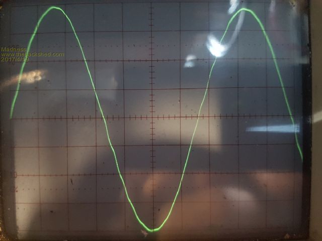

Posted: 11:10am 19 Apr 2017
I found the cause of the small waves within the waveform as shown here.
It was the old Trace inverter, I turned it off and the big Inverter reduced the noise it makes to about 1/3 and the wave smoothed out completely running at 350W. So I tried the small Ozinverter at idle and with load and it no effect on the other inverter.

Warp are the bumps you are referring to those that appear at zero crossing? as per this pic.
Posted: 04:25pm 20 Apr 2017
I cannot find a really suitable picture on the internet, but this is a sinewave with one particular fairly high order harmonic added onto it.
If there was a very strong transformer self resonance it might look something like that, with a higher frequency sine wave ripple superimposed on the 50Hz.
