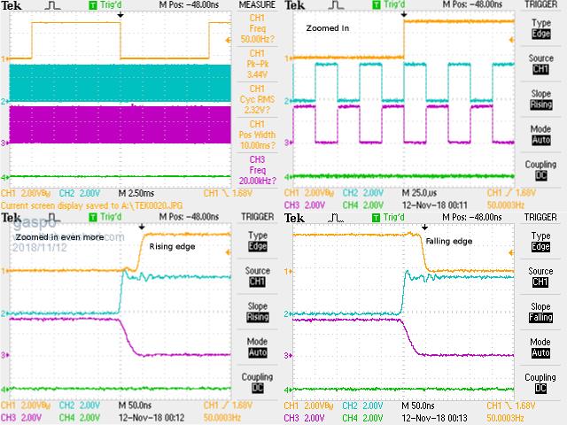

  poida said   Gaspo, I've had a crack at it with the Arduino Due (Cortex M3) and when using PWM only (no bit fiddling from within the interrupt block) I could not get it close to the 5uS
of the 328p code.
Hi Poida, I wanted to see how well I can synchronize two timers on STM32F030.
Timer TIM1 configured as master, 20kHz PWM 50% duty with complementary output.
Timer TIM3 set as slave clocked from TIM1 at 20kHz, prescaled for 50Hz PWM with 50% duty.
Timers were in sync down to 50ns.
No inverter code just timers setup: 2018-11-12_004525_main.cpp.zip
Edited by gaspo 2018-11-13

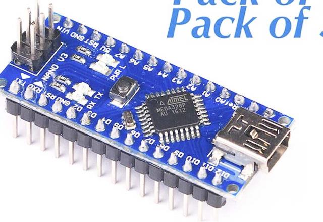

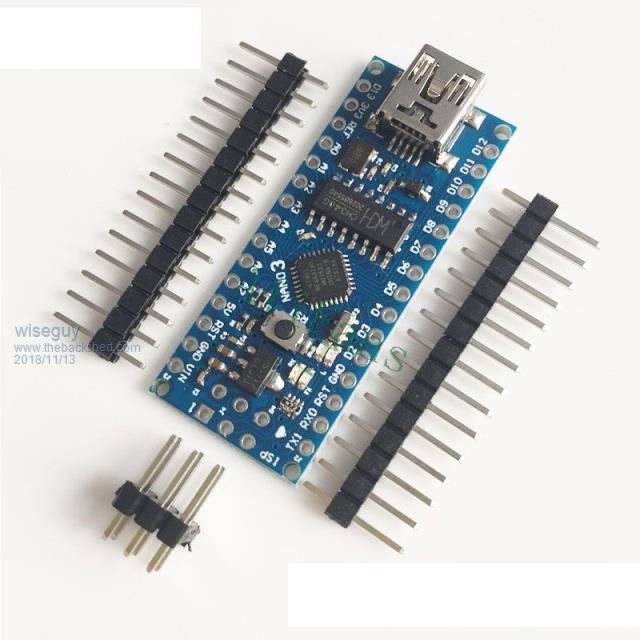

On another matter, Gaspo kindly programmed my Atmega nano 168P board to do the 2 sine wave inverter drive. This looks *very* promising indeed, nice clean wave forms and nice soft start/stop via push button.
Now I'm experimenting with feeding these sine waves into two TLP350 opto isolators which in turn feeds the signals to IR2184 chips.
If this works I'll get an inverter that runs from a nano which is electrically isolated from the power drive signals.
To make this a fully operational inverter it would require over current and under voltage shut down facilities similar to the EG8010 and some kind of fan control via NTC sensor.
Is this asking too much from the nano 328P I have on order?
This looks very good. This would be an excellent basis for running inverter code.
The 50ns overlap is insignificant since dead time circuitry will prevent such short pulses from getting the MOSFET gates.

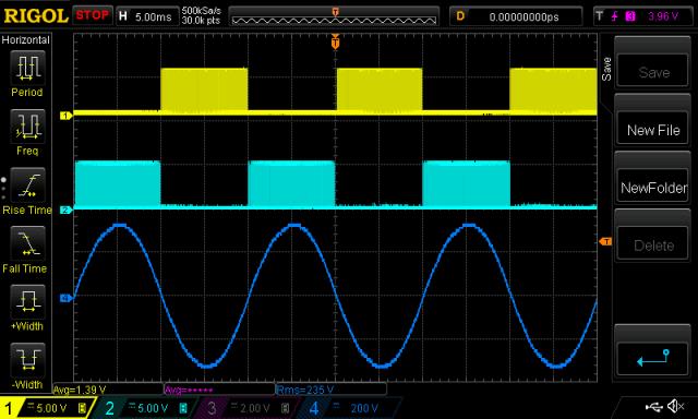

  wiseguy said
Last thoughts, if the two consecutive half sines were identical (save the first half and re-feed it during the second half) it should guarantee the toroidal flux never walks. This is easy to write but might be difficult/impossible to actually code.......
I must confess I had to read your post a few times to understand it.
I think I get it. Let V1 and V2 be the primary winding node points.
Looking at it at some random time we see:
V1 = 0 volts and V2 doing a half sine, from 0 to DC supply and back to 0
then we see
V2 = 0 volts and V1 doing the half sine, from 0 to DC supply and back to 0
rinse, repeat..
That is easy to code. Agreed it 1/2s the switching losses. And probably doubles the life of the MOSFETS too.
I have not had much of a problem with DC in the primary winding (flux walking?)
but maybe it's an issue that I'm overlooking and should worry.
Time to get the 328P manual out again.
Timer 1 is the only timer we can use that has the required clock speed and count range. Timer 1 outputs via pin 9 and 10.
We need pin9 to hold low while 10 does SPWM, then pin 10 low while pin 9 does SPWM.
I think we need to reconfigure the output compare on the fly, each 1/2 cycle.
Lemme see.

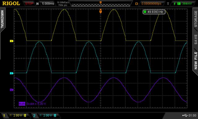

Posted: 11:21am 12 Nov 2018
Wiseguy,
well, that didn't take long..
Here is a DSO capture
Yellow is V1 , Arduino Pin 9, (to a half bridge, so the IR2184 produces low and high side drives)
Light Blue is V2 (Arduino pin 10)
Dark Blue is AC output.
When V1 is pulled low, V2 gets a half wave, then V2 is pulled low and V1 gets a 1/2 wave.
Using my crappy UNI-T DC clamp meter, I see very low DC current in the primary.
Maybe 0.2 A.
This is on top of 6 Amp AC.
Code is
2018-11-12_211512_uno_inverter_2x_sine_wiseguy.ino.zip
The IR2184 input is reflected on the low and high outputs as follows:
input low = lowside HIGH, highside LOW
input high = lowside LOW, highside HIGH
The highside drives get their DC supply from a charge pump, and so it wont work on DC.
But it works!
What now... (did I pass the test and I can work for you?)

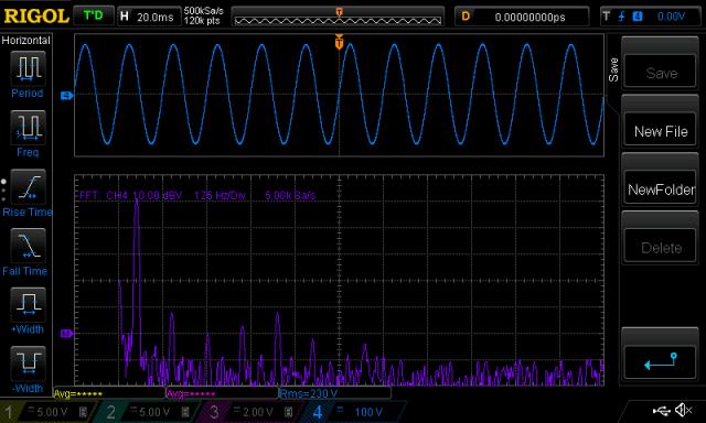

Idle current for this code is 0.40A, compared with the 2x sine code which is 0.48A
Both tested at 27.4V supply, 235V AC output.
I noticed the 1500VA toroid ran quieter when running your suggested code.
Here is the FFT from the output when under 150W test load.
10db/div. The THD must be tiny!
F3 -42db
F5 -50db
F7 -47db
F9 -42db
Edited by poida 2018-11-13

  poida said   Wiseguy,
etc
But it works!
Poida what took you so long :)
I am in awe of your coding abilities - would be happy to work with you anytime - you got the job!!
In return next time you have something that needs a PCB Ill find Gaspos address - just kidding - I would be happy to do it for you.
Cheers Mike

  wiseguy said
Poida can you please confirm that the, USB Nano V3.0 ATmega328 16M 5V Micro-controller CH340G board For Arduino Module will work with your code?
All Arduino Nanos use the ATmega 328 (it's required by the standard design of the Nano), and so no problem.
The Nano board leads out enough ADC channels, digital pins 2 - 10.
I guess you have your eye on a few of these?
The image of the board clearly shows ATmega328P uC.

Poida, I probably should have consulted you first - my Nano was much more expensive (by 81c) but its got more "stuff" on it - not sure if that is an asset or not....
Their Descriptions:
CH340G Replace FT232RL
Operating Voltage(logic level):5V
8 analog inputs ports:A0 ~ A7
14 Digital input / output ports:TX,RX,D2 ~ D13
6 PWM ports:D3, D5, D6, D9, D10, D11
1 pairs of TTL level serial transceiver ports RX / TX
Using Atmel Atmega328P-AU MCU
There is bootloader installed in it
Support USB download and Power
Support for external 5V ~ 12V DC power supply
Support power supply by 9V battery
Should I turf it and use exactly what you are using to avoid issues or give it a go?
It currently looks as sad as the picture.....
I just saw the rest of the pictures - yours has lots of stuff too under the pcb.....
Edited by wiseguy 2018-11-14
Cheers Mike

Wiseguy, your Nano will work fine. It has the same amount of analog and digital pins as Uno - just smaller form factor.
