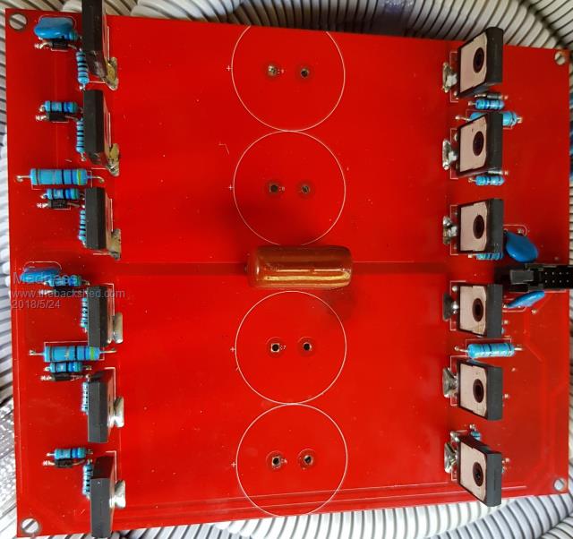

I have had a request for some of these PCBs in the inverter above if anyone is interested. Price would be around $17 each plus post, I still have control boards also for $15 each.
They take 12 HY4008w MOSFETs and will easily do 4KW continuous, they are basic, no Totem poles but work really well off any of the control boards. PCB is 2oz, 200 X 150MM the toroid I am using with this is from the Aerosharp with just the outer windings removed and a 22 turn primary. Heatsink is one from the Aerosharp cut down to suit. You can build one of these with just one 3KW Aerosharp GTI.Edited by Madness 2018-05-25

This is a good sized unit really, and will do almost most everything asked for in a off grid setting. There are a lot of folks around the world building this inverter, and most of them are overbuilding them, going for the 6 fet design with dual or triple stack transformers.
This 12 fet design from Mad I think is an excellent start point, and probably will do everything wished for... ie you may never bother with a bigger one.
I found the 16 fet unit I now do, is ample for everything all off gridders need to do... but I don't have 24hr air conditioning needs either.
ryanm, this thing will eat your pump, and boil a jug at the same time.
Mad has shown that three fets do 4kw all day, and I have shown 2 fets (renewable marks unit) will do 5kw on their own too. When you see the tiny torroids in the Victron 5kw units, we can see we are way over the top here.
I still prefer mads multi enamel wire primary. It stays cooler than welding wire, I think the skin effect works here.

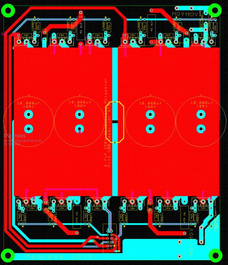

I have added a few extra components to the 4KW Power PCB that were not there before. Original I had made this board for testing only and had not included any of the protection capacitors of MOVs.

  Madness said   I have had a request for some of these PCBs in the inverter above if anyone is interested. Price would be around $17 each plus post, I still have control boards also for $15 each.
How long do I have to think about it? I am toying with the idea of building a couple of baby 24 volt portable inverters.
I am still trying to think of reasons why it wouldn't work. I would like to replicate a 3kw 24 volt latronics inverter on a 5kw lifepo pack.

Yahoo, there are two installations I did over here that are 24v. Been a few years now.
The main thing to remember is to down grade the 120r resistor so as to keep the voltage in the 18v range after the resistor. You can use cheaper caps too.
