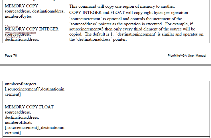

Assume you have an array A!() that is size X (1024)
Your display area is S (320)
Then you create (DIM) an array T!() that is size X-S (in this case 1024-320=704)
DIM T!(X-S)
You copy the first X-S values from array A!() into T!()
You do a dummy=MATH(MIN T!(),trigger)
trigger will be a pointer that is between 0 and X-S in array T!()
Use the same trigger as a pointer in array A!() and you will always have sufficient display points for your window.
copying part of an array into another can be done using MEMORY COPY FLOAT
The memory address you get from PEEK(VARADDR   )
So the code for that would be (untested !! currently no pico at hand)
MEMORY COPY FLOAT PEEK(VARADDR A!()), PEEK(VARADDR T!()), X-S
This would be a relatively fast way of doing it...

Look at the bottom of the previous page. What Volhout described above is tested and working in my scope program. It can be adapted to yours quite easily.

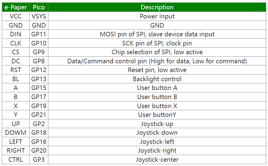

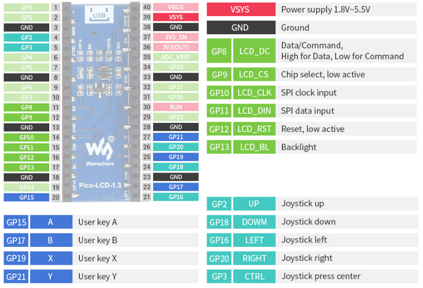

In case you'd like to use the Waveshare Pico-LCD-1.3 display carrier, I've just received a couple, and have figured out how to use the OPTIONs to set the SYSTEM SPI and LCDPANEL configuration. I'm going to try using this board as a scope display, since it already has four pushbuttons (and an x-y joystick on it!)
PicoMite MMBasic Version 5.07.07
OPTION SYSTEM SPI GP10,GP11,GP28
OPTION LCDPANEL ST7789, LANDSCAPE,GP8,GP12,GP9,GP13
There is no SD card socket, so reading data is not an option, and MISO pin isn't present. Only CLOCK (GP10) and MOSI (GP11) are specifiable. There is no MISO pin, but setting MISOpin tp GP28 (otherwise unused) works (so far).
The carrier uses an ST7789VW controller (at 240x240 full color), which I've used in the past on one of their larger carrier boards *with* an SD card socket.
Their documentation is at this link.
The board schematic is at this link.
Edited 2023-09-18 03:44 by NPHighview

You need to use something like
Option system spi gp10,gp11,gp28
option lcdpanel st7789,l,gp8,gp12,gp9,gp13

I'm not entirely sure which pins you need free for this rudimentary DSO, but it looks to me like the Game*Mite might be a suitable device (bigger display and chunkier controls than the Pico-LCD-1.3) if you want to build a portable one but don't (yet) want to make a custom PCB.

Posted: 06:34pm 17 Sep 2023
Thanks, Peter & Tom -
Peter - through brute force process of elimination, I was able to figure out the SPI settings, but I really appreciate your monitoring the forum!
Tom - I need GP18 (pin 24 or other), GP26/27 (pins 31 and 32) accessible via some sort of connectors. While this board has a larger :-) display than the 0.96, and has buttons and joystick, it doesn't bring out those leads. I'm about to try soldering "pin and cup" style through-connectors to see if I can't somehow accommodate both.  I'll contact you via messaging to find out how I might be able to get my hands on a Game*Mite.
With Peter's suggested configuration, this display does work nicely with both the Pico and PicoW, so for now, I'm playing with some of my other sample programs like the NTP-based analog clock. I'm even delving deep into my past (circa 1980) for code (in PL/M - gaack!) that I wrote to manage the data & display for a four-channel patient monitoring system. OCD and all, I tend to keep that stuff in my excessively organized filing system.
Thank you both!
Posts: 4405
Posted: 06:38pm 17 Sep 2023
  NPHighview said  Tom - I need GP18 (pin 24 or other), GP26/27 (pins 31 and 32) accessible via some sort of connectors. While this board has a larger :-) display than the 0.96, and has buttons and joystick, it doesn't bring out those leads. I'm about to try soldering "pin and cup" style through-connectors to see if I can't somehow accommodate both.  I'll contact you via messaging to find out how I might be able to get my hands on a Game*Mite.
All three of those pins are free and available through J1 (7x2M right-angle header) of the Game*Mite .

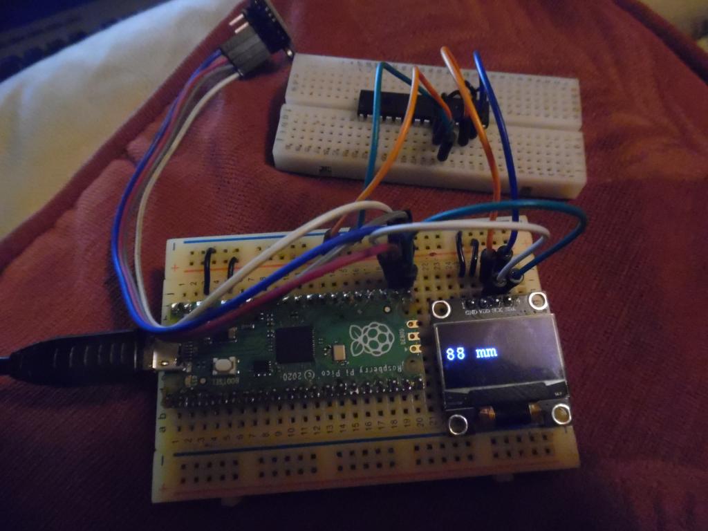

An observation, no doubt covered before, but for what it's worth, regarding the Webmite and ADC reading stability.
I noticed that my ADC results were varying considerably recently, even though I was taking 20 samples and finding the mean. The input to the ADCs are fixed resistor dividers in the dev stage, so input is stable. I've also used the third ADC to find the floor noise, which I subtract from the other two ADC readings.
The apparent instability in the ADC outputs was observed on the OLED display, recently installed and configured in the code dev. From comments previously read here I then hauled out my really really cheap multimeter and measured the 3.3V rails, which had drooped to 3.15V and varied about 0.01V around that.
Fortunately I had a spare 100µF electrolytic cap on hand, which across the rails on the breadboard, brought the rails back up to the unloaded 3.32V originally measured; and now the ADC readings are rock steady again.
Thanks to all for their comments on this thread.
