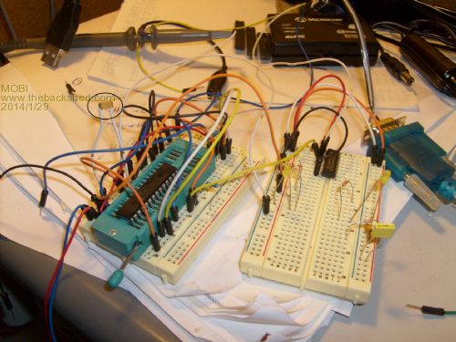

Help?
I have 6 pic32 chips (3 x 150 and 3 x 250) all appear to programme ok (according to pickit3)
I have wired up correctly and have terra term running. When I apply power to the uMite, I get a string of (garbage) characters about 30 or so long. Each time I apply power, I get the same string.
I am using a USB-serial 5Volt cable with a 1K resistor in the line to the uM.
All 6 chips present the same data string.
Is there possibly some setting of the terminal I am overlooking. I set the comm port as per instructions.
Puzzled!

Posts: 6637
Posted: 08:31pm 28 Jan 2014
  MOBI said   Help?
Baud rate not set to 38400?
Converter is Inverted. RS232 polarity instead of TTL polarity.
To test, the voltage on the Tx pin of the converter should be plus 3.3 (or 5) volts when idle.
MOBI
Joined: 02/12/2012
Posts: 819
Posted: 08:41pm 28 Jan 2014
  jim said  Converter is Inverted. RS232 polarity instead of TTL polarity
That just may be my problem. Input volts to uMite tx pin) is 0. All the cables I have are TTL level (5volts) but inverted. I'll try an inverter in the line.

MOBI
Joined: 02/12/2012
Posts: 819
Posted: 09:35pm 28 Jan 2014
@Jim,
Thanks for the help. I was rather hoping it was not a hardware problem, but...
I wired up a 14049 inverter and bingo, I get the start up screen.
A sight for sore eyes.
Looks like I go to eShop and get the right cable. Or I suppose, I could make up a proper board with a max202 on it? The current set up is a bit cluttered.
The 10uF capacitor is pretty forgiving. You can see mine (circled) standing up on a couple of plug in leads.
David M.
