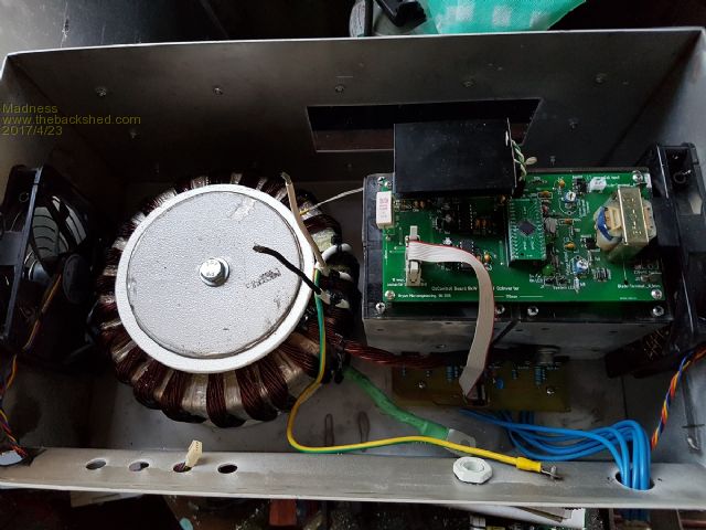

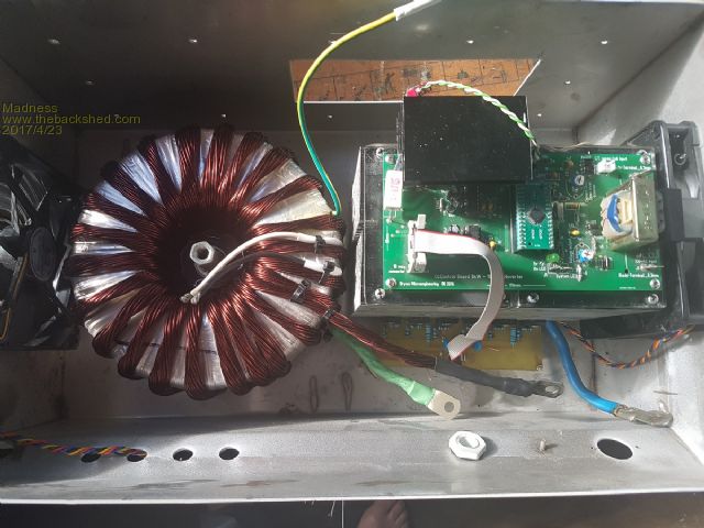

Here is the smaller Inverter I am building with the repurposed wire from the Toroid used as a new primary. This Toroid had a 250 Volt secondary and a 230 primary on the inside, I left the 230 to be the new secondary and reused the 2mm square wire X 19 with 24 turns as the secondary. With 230V on the secondary, I get 1.1V per turn.
I was also able to reuse the piece I cut out for one of the fans to hold the Toroid in place with a piece of perspex under it for insulation.
I thinking it should comfortably run 3 - 4KW continuos, FETs are 4110's I will see how the go but might change them for 4008's

Damn impressive winding effort there. Should make a nice little unit...
I'm a bit iffy about the enamel wires touching as they have been worked a bit by now, it may have been possible to put them in a 6 meter x 25mm heatshrink tube for extra insulation too, but then again they may be just fine.
I like it a lot.
...........oztules
Posted: 11:34pm 22 Apr 2017
There is only about one volt per turn, so the electrical stress between turns will be very low. But I agree, its a really nice job !

It has had a coat of epoxy all over the primary so there should be no movement or exposed wire. The wire was also very flexible, this toroid is different to any of the other Aero-sharp ones I have seen. The 1KW SMA toroid (not the one in the photo's) that I scrapped had tape on every wire where they went through the core on it's primary so that each turn had an extra layer of insulation between each turn, the tape was very similar to Kapton tape.
I had thought insulating it more but this way it is going to cool better, another thing that is really nice about doing it this way is it did not take a lot of time and a whole it cheaper than welding wire.
The heatsink from the old SMA 1KW worked out well, I never measured it, just cut it in half and then half again for the low side, there is less than 10mm to spare end to end.Edited by Madness 2017-04-24

The end result was 8mm diameter so 12 or 15mm is probably big enough heat shrink and you would need at least 7 metres. It was quite easy to bend around the corners too, what I found helped a lot too is to wind it through the core into about a 600mm diameter coil and tie the turns together leaving the first couple turns free, then rotate it through as you go.
It took less than 2 hours to cut the wire, twist it and wind the primary.

What you could try, if you wanted extra insulation, is to wind spiral loom wrap around it. Wound with a gap between the turns there would still be cooling but the bundled wire turns could never touch when passing through at the toroid hole.
I should imagine trying to sleeve 7m of heatshrink over it would not be easy, also, if its shrunk it would stiffen the bundle a lot.

No Tinker, it will be easy, as you can just do 1 meter at a time.... it does not need to be contiguous.... or waterproof, the segments need not even catch onto each other.
If he had used 24 120mm bits, then you could wind and only have the shrink on the inner core of the wires, leaving the outer naked. I am only concerned with where the wires pass over each other. Tape could be used too, but look poor.
There is a lot of weight in a dual or triple core, and I would feel better with insulator between turns where they cross.
True the inter-winding is only 1 v between turns here, but a lacquer fracture would yield a welder.
He has used epoxy to hold the turns, which alleviate most of my concerns.... but you only have to do this once.... fiddly but there forever.... even every second turn would do.
