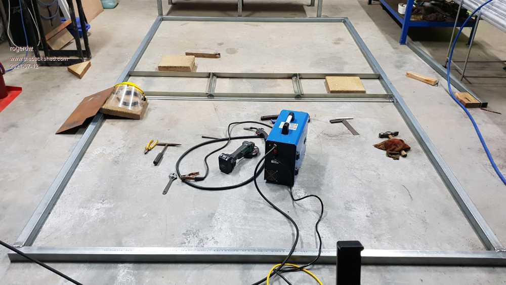

Well I'm still at it.
Wife and kids were away for the weekend so I made a plan to get stuck into building the big version for the roof. Had all the main steel for a few weeks but been dragging my feet  ...  plus had to clean up a fair bit to make room to build this thing.
The main frame is 4.1 meters wide by 2.4 meters high and will have the ducting down the centre and with the evacuated tubes sticking out each side, horizontal  ...  60 in total.
Looking at the size of it and realising the weight, I'm starting to wonder how I'm gunna get it up there  ...  might have to call in a few favours.
It's really only the main frame that will be the issue  ...  the rest I will assemble up on the roof.

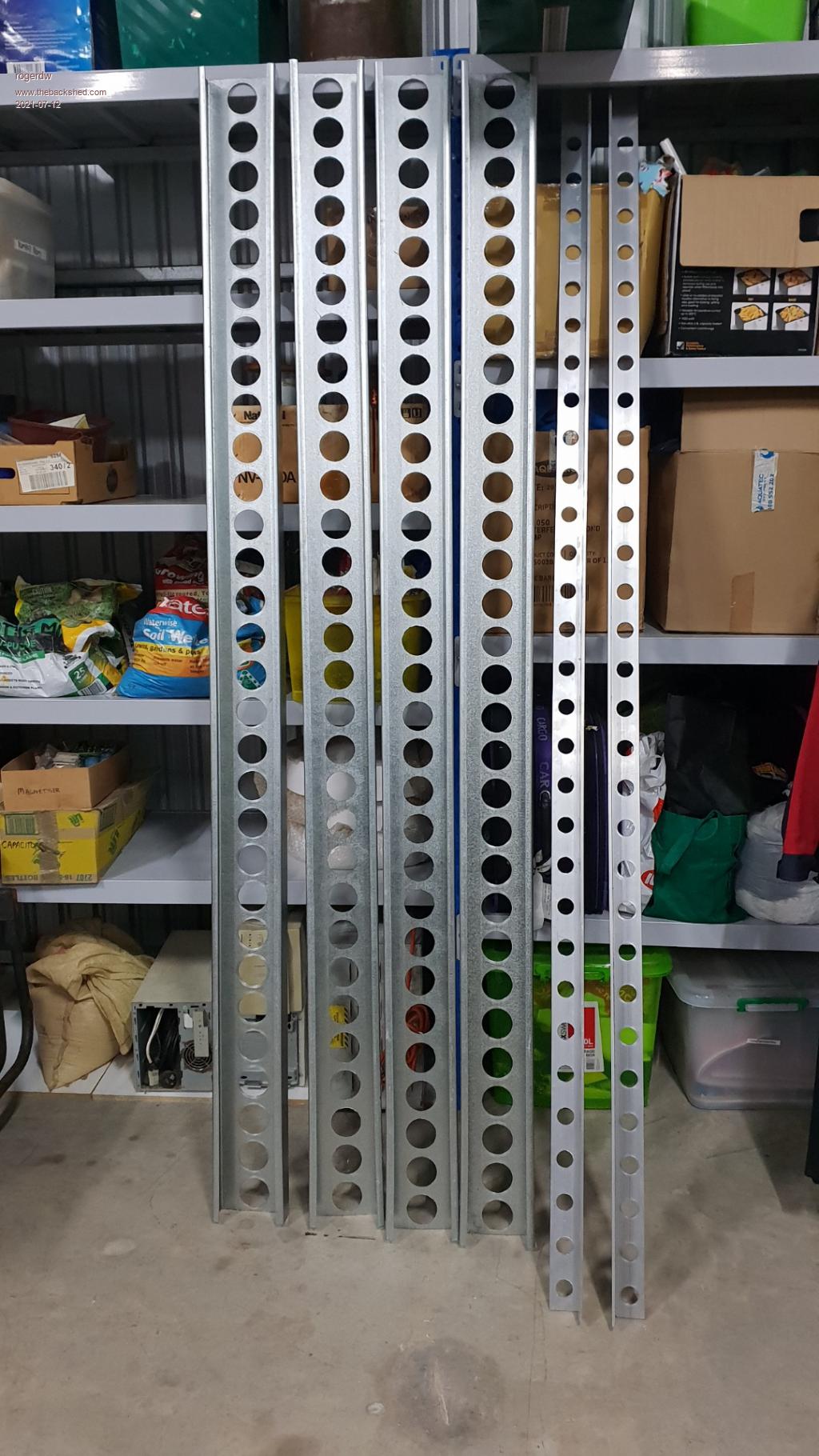

I started by drilling the aluminium angle with 32mm holes to take the ally tubes  ...  then tackled the c-section with 63mm holes. Took a while but very pleased with how it went.
Then I cut up the steel and welded the main frame together. Need to do a lot more welding yet, but its getting there. It's upside down at present.
If nothing else, you can see I'm serious  ...  or mad!!!
I also tried out my new low temp melting point aluminium brazing rods  ...  and discovered the so and so's sold me plain aluminium rods!!! Supposed to melt at 480 degrees, but my tubes were melting before the rods would. So I've ordered from elsewhere, hopefully with better luck this time.
Cheers,  Roger

I was reading thinking " Is he talking about welding AllY" having tried it and spoken even to experts who think it's not at all easy. I forgot about those new Rods though.
If you bought them on Fleabay, send the Crap back or just as for a " Not as described " refund. Sick of these crooks getting away with ripping people off selling misrepresented garbage.
If you were doing plenty of this it Might be worth looking at getting a Spool gun for your MIG. I guess as this is likley to be a one off, probably not worth it but hey, He whom dies with the most toys.....
I want to get a TIG  torch for my MIG next and have a crack at that.  Then again, There is nothing I can't do with the MIG but another skill wouldn't hurt to have.
I see you are using Gasless MIG. I have used that myself and get sick of people putting it down. I have challenged a Number of people to break my gasless welds and none have been successful so far. When you really grill some of the so called experts as to what is wrong with it, generally it comes down to something like " It doesn't look as good" in the end. Yeah well this isn't a sculpture I'm selling for thousands to the Guggenheim to display.....
If I were welding pressure Vessels or critical stressed components, then I would obviously go with gas but the reality is my backyard hacking welds rarely if ever fail. The same can't be said for the materials I use  which I have torn and bent particularly when making implements for the tractor.  Amazing the forces that can be generated so I use 3mm now as a minimum and 5MM when I'm not sure.  Only time I have had a problem with the gasless welds was when I forgot to go over something I tacked  and even that didn't fail Immediately.

Roger, I can't see how you "drilled" those big holes so neatly. Did you do what I would, drill a 10mm pilot hole and then use what's called a 'chassis punch' to remove the remaining material?

  Murphy's friend said  Roger, I can't see how you "drilled" those big holes so neatly. Did you do what I would, drill a 10mm pilot hole and then use what's called a 'chassis punch' to remove the remaining material?
I did drill pilot holes, though only about 5mm  ...  then used a holesaw to create the holes.
I screwed a guide block to the drill press table then slowly did each one.
I was going to try kerosene or even WD40 when I did the aluminium  ...  but when I was in Bunnings I spotted a spray can of cutting oil put out by Suttons, who also happened to have made the holesaw set that I have  ...  so I used that for all of the holes and it certainly went well. Was $19.95, so expensive  ...  but seemed to help.
Took all evening to do the aluminium angle  ...  had them clamped back to back  ...  so the saw had to go through 12mm of metal.
The C-section I clamped back to back as well  ...  so halved the setup time in shifting it through. Those took pretty much all day to do.
I was amazed at the swarf coming off the cutter. If I fed it in properly I could get a curly piece a couple feet long before I backed off, blew away the swarf and lubed it again.
Got a nice box full of washers now.

Yeah, in my naivety I thought I'd just buy some aluminium filler wire and weld up the pipes with my oxy. Well I found out the hard way that that wasn't going to work  ...  so I bought what was supposed to be those flux cored brazing rods  ...  but weren't!
  Quote  If you were doing plenty of this it Might be worth looking at getting a Spool gun for your MIG. I guess as this is likley to be a one off, probably not worth it but hey, He whom dies with the most toys.....
Probably unlikely to do much ally welding in future, especially if these rods work as well as they claim.
What I really should do is go get some welding lessons so I have a bit of a chance  ...  but I've managed this far and I need to finish this job first.
