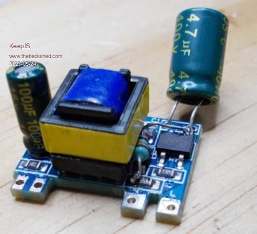

KeepIS
Joined: 13/10/2014
Posts: 2289
Posted: 10:42pm 22 May 2023
  analog8484 said
Thanks for the clarification. So, doesn't reducing the total choke value change the resonance frequency from the original tuning (1.5x line frequency?) assuming you haven't changed the AC output capacitor value?
No, the choke or chokes on the primary winding have no effect on transformer resonance, that's purely a Capacitor and transformer secondary relationship, obviously that include transformer construction etc. In my testing, nothing I did to the primary with Chokes or connections to the Inverter made the slightest difference to the measured 75hz resonance.
This was verified with the two toriodal transformers that I was testing, one a single core Aerosharp and the other a 3 stack toriod that's in my inverter.
KeepIS

  Revlac said  Thanks, That would be great, I can see there is a chance of low battery voltage during heavy starting loads.
Actually that's not a problem, if you remember, once started, those small DC/AC->DC isolated supplys don't drop out until very low voltages, it's just starting some of the mongrels that is problematic.
I'll post when I have a look at the value of R I used in my inverter.

tinyt
Joined: 12/11/2017
Posts: 564
Posted: 10:13pm 23 May 2023
Here is an alternate part: 22V - 290V input isolated output: 5V - 15V. One unit I tested starts to operate at 25vdc. Hope this helps.
I intend to use it on my PV Array monitoring circuit.
Edited 2023-05-24 08:16 by tinyt
KeepIS
Joined: 13/10/2014
Posts: 2289
Posted: 12:38am 24 May 2023
Thanks for the link, unfortunately it's currently unavailable, I'll keep an eye on it though. The units I have are so far proving 100% reliable on startup and low voltage dropout now.

Quick and dirty mod for DC-DC supply to lower startup voltage and drop out voltage.
This is very successful on some of these modules, makes a few volts difference to startup.
Check max output before and after mod, some of these are not close tolerance in there stated output voltage and do moves a bit as input voltages increases.
Soldered a 220K resistor to the SMD that's mounted closest to the N terminal and the end closest to the transformer pins.
The other end of the 220K goes to the pin on the SMD Rectifier or the positive terminal of the big CAP.
Note the startup voltage is also determined by the load current, 47 to 100 ohm should test it out.
Cap moved back for photo, it folds back in place.
