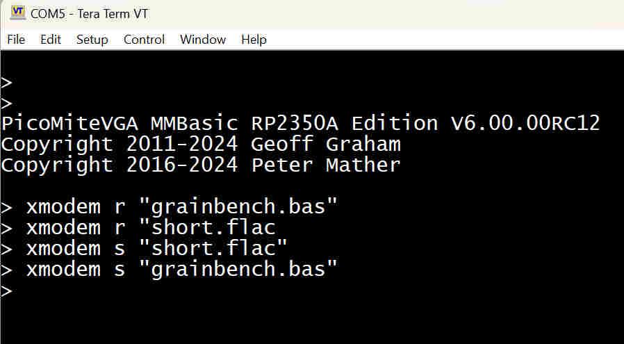

xmodem s "V 6.00.00RC12 LCD-b.opt" sends the file ok (via TeraTerm) but never returns to the command prompt. Heartbeat stops, no response to Ctrl-C.
Xmodem r "file" is ok.
Footnote added 2024-11-02 13:34 by phil99
PicoMite MMBasic RP2040 Edition V6.00.00RC12
and
PicoMiteVGA MMBasic RP2350A Edition V6.00.00RC12
Tried a variety of file sizes, same result.
Footnote added 2024-11-02 13:43 by phil99
PicoMiteVGA MMBasic RP2350A Edition V6.00.00RC12 also locks up with Xmodem r "file"

What version teraterm are you using can't replicate on 5.3
Posts: 3422
Posted: 08:38pm 02 Nov 2024
Using TeraTerm V4.103 and V5.2 same result, VGA and LCD Picos lock up after sending the file. Still happening this morning.
The Xmodem r lockup only occurs when saving on B:.
Serial settings:-
115200, 8, N, 1
Flow control- none
Transmit delay- 0mS/character, 5mS/line
These settings worked in the past.
Footnote added 2024-11-03 07:05 by phil99
Tested WebMite MMBasic Version 6.00.00RC8 and Xmodem s works as normal.
Has anyone else tried Xmodem on RC12?
It would be good to know if it is just me.

V6.00.00RC14
PicoMiteRP2040V6.00.00RC14.zip
PicoMiteRP2350V6.00.00RC14.zip
I was finally able to replicate the XMODEM issue at higher clock speeds, previously I had tested at default.
I'm combining different bits of the current release sdk 2.0.0 and the development branch to try and get round some intermittent bugs (like the timer stopping)
RC12 was built using the development branch but this seems to have introduced issues (or made them worse)
This version copies just the parts of the development branch that I believe address the issues affecting the PicoMite

RC14 Xmodem Send tests.
PicoMiteVGA MMBasic RP2350A Edition V6.00.00RC14 works at 126MHz only.
PicoMite MMBasic RP2040 Edition V6.00.00RC14 works up to 315MHz.

Posts: 3422
Posted: 08:30pm 03 Nov 2024
Excellent Peter, Xmodem works at all VGA CPU speeds.
Posts: 6632
Posted: 04:36am 04 Nov 2024
PicoMiteHDMI MMBasic RP2350A Edition V6.00.00RC14
xmodem works with TeraTerm but lockup with MMCC
