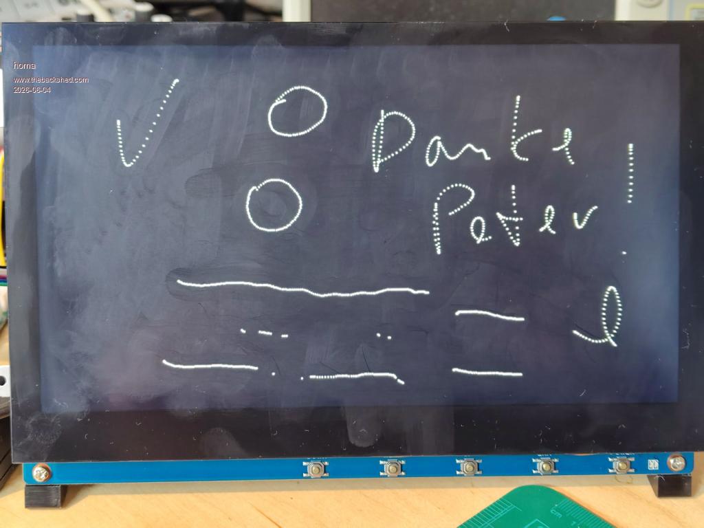

Posted: 08:35am 04 Jun 2026
PicoMite.zip
Please try again with the version just posted above. Forgot to turn debug back on before

Posted: 08:45am 04 Jun 2026
The result
20260604-RC16testDebug.zip

The debug output just won't stop; after two minutes, I stopped stroking my screen ;-)

You can also see the 3- and 5-finger gestures really clearly!

I noticed in the debug output that it usually says "-> count=0 active=0" and sometimes "-> count=2 tip=1 x=97 y=212 active=1".
Even though the hex values change otherwise?!

How long is "a while".
PicoMite.zip
I've put debug back. Please do as follows:
At the command prompt
OPTION CONSOLE SERIAL
GUI TEST TOUCH
then use one an two fingers to draw on the screen. If the drawing ever stops capture the console output from the serial console and post. If it doesn't stop, just let me know.
We'll get there eventually

This seems to be the problem:
T+33683ms #458 [62] 04 40 3F 29 9D 28 00 00 00 00 00 00 -> count=1 tip=1 x=824 y=456 active=1
T+33855ms #465 [62] 04 64 00 78 00 04 00 00 00 00 01 01 -> count=0 active=0
and goes well with:
  Quote  How long is "a while".

About 10 seconds!
homa
Joined: 05/11/2021
Posts: 745
Posted: 10:13am 04 Jun 2026
And that fits in with what you want – the painting stops right then!

Found a bug. 04 which is the report ID was being found in junk on a report and getting the parser out of sync. Please try again with the attached.
PicoMite.zip
WW: test with this version
Edited 2026-06-04 20:36 by matherp

Posted: 10:43am 04 Jun 2026
Peter,
a picture is worth a thousand words.
Here's the log – the touchscreen recognises three or more fingers perfectly!
And it's running smoothly now!
RC16_klappt.zip
Thank you very much.
Matthias
