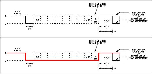

Posts: 2556
Posted: 01:28am 30 Aug 2014
just had a look at the start and stop bit framing for RS232 data, and found the following:
the top diagram is the original, the bottom has the levels for sending a zero byte (chr$(0) in MMbasic) with no parity highlighted in red. on the face of it, it appears that you get a single clean negative-going pulse that is 9-bits long.
if this was inverted with a single transistor, would the single positive pulse not be ok for PGC? adjusting the baud rate, one could selected a desired pulse length. it would still be necessary to monitor using RI or CD to be sure the pulse was finished (plus wait for a couple of bit-times for the stop pulse to pass) before moving on to send out the next ICSP bit.
someone with a digital scope to hand might care to check this out.
this doesn't address the issue of assuring that the PGD data is synchronised. it could be worth an experiment though, to see what happens. perhaps PGD could be monitored with another spare input line?
rob :-)Edited by robert.rozee 2014-08-31
Posts: 4396
Posted: 01:41am 30 Aug 2014
How have you allowed for the ms delays of indeterminate length?
Are you thinking maybe 1 baud?
It looks unreliable and much slower than what I have now!
This is the system:
PC with USB host ========= USB serial I/O board ====== RS232 lines ==== PIC32
Everything, every tiny I/O, needs at least a packet taking multi-ms from PC to USB serial board. Any I/P requires at least one return packet as well.
JohnEdited by JohnS 2014-08-31

Posts: 2556
Posted: 02:34am 30 Aug 2014
yep, you are right - any (faked) interrupts coming back would follow a long and indeterminate path who's length could not be relied upon. everything would quickly fall to pieces.
another tack: is it fair to assume that the order of outgoing USB transactions is always maintained? ie, if you send an instruction to change the state of (say) DTR, then send another instruction to transmit chr$(0), will DTR change state before the chr$(0) is transmitted?
if this holds true, then perhaps one can simply make sure that bits are 'pumped' out of DTR at a sufficiently slow rate, using a timer interrupt. ie, place PGD bits into a queue, and have a timer interrupt:
1. pick up one bit at a time from the queue
2. set PGD accordingly
3. send a chr$(0) out the comm port
the interval of the timer interrupt would need to be somewhat more than the length of the transmitted byte, and one could start very slow and experiment with ramping up the rate. using a baud rate of 1 M-bit/s, the length of PGC pulses would be around 10uS.
